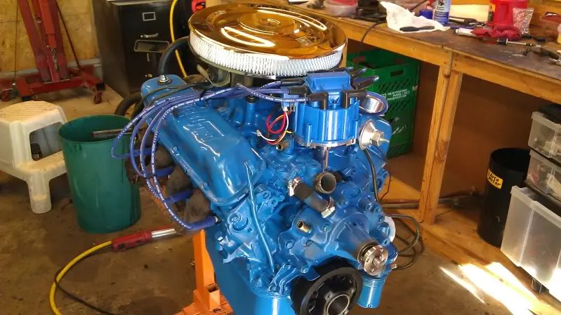

The last carb engine I did, I put a Summit all in one single wire distributor in it. It was like $140 for the whole thing with a 50,000V coil. It's kind of big though, and I had to cut custom wires for it. You shouldn't have to do custom wires with your setup though. I'd post a picture of it, but photobucket won't let me copy pic links anymore with Mozilla.

Since I'm on my Window's computer I thought I would go ahead and post that distributor picture.

Clean lookin engine there! And with the Holley blue pump ive been looking at, what regualtor would you recomend with it? Also does anyone know if the 58cc TFS heads will clear stock pistons?
It's really just a stock engine with a can of Duplicolor applied.
