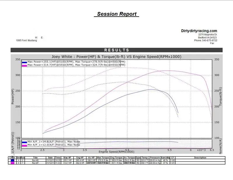

95 cobra built 306 AFR 185 heads trickflow R intake, F303 cam
Before tuning 255rwhp 278rwtq
After dyno tuning 314rwhp 324rwtq
might have little more in it but fuel pump is believed to be going bad , he is going to bring it back after changing fuel pump
Wow, power gained from adding fuel...dyno tunes are the way to go. I like to self tune but I'm a beginner. I'm gonna get my car on the dyno one of these days to see how far off my skills are, haha!!
