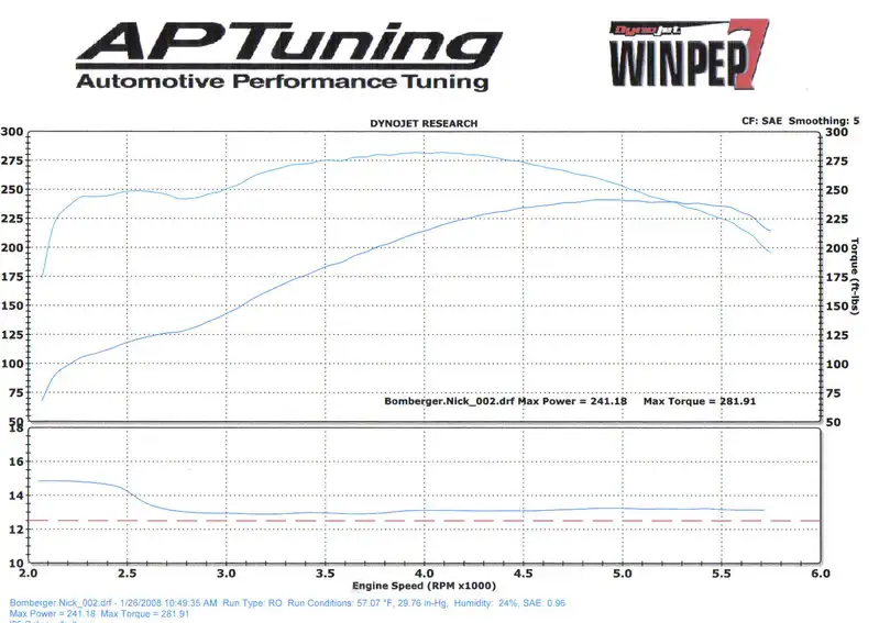

I don't think I'm going to get an FP regulator. I just want the car to run safely and maybe pick up some power. I am pretty set on getting it tuned. I don't have any more money to sink into in for a while because I have a baby girl on the way and that's way more important. Can anyone please verify from my dynograph if the Air/Fuel ratio looks ok? It seems to be ok after 2500rpm, but I'm not sure what all the lines mean because there is no key.
That chart was done with equal scaling for hp & tq which I prefer :nice:
That means you can use left or right side values to determine hp or tq
Of course ... Across the bottom you see your rpm values
All you gotta do is just line up one side and bottom to see any particular
value of hp or tq at your chosen rpm
As for the fuel ratio
Same kinda deal :nice:
See that red dotted line ............
Look on the left to see it is sitting on the 12.5 to 1 mark
Notice how the hp, tq, and fuel ratio lines all quit at the same rpm
Hope that helps
Grady
Yes it does, thanks Grady:nice:
The reason I said 14.0 to 1 right off the bat was because that's what the dyno guy told me before I even saw the graph. I guess it stuck in my head, and I wasn't completely sure about reading the graph to verify it. Do you think it's worth having it tuned?
It seems to run pretty decent. The idle will lope a tiny tiny bit once in a while, but never close to stalling out or falling below 650rpm. It does feel a bit slower to me lately, but maybe because I'm getting used to it. I know I would be spending at least $300 to get it tuned, I just don't know what I could gain from doing so. If I could pick up some power (10-15rwhp) and more high end torque I wouldn't hesitate to do it. Is that a realistic goal?
I've been thinking about your Q's concerning getting a tune.
I just can't be certain about two things with you current combo.
That chip and meter. My greatest amount of suspect is the chip.
A stock Cobra has fairly fat WOT fuel tables and on top of all that
it has a fuel enrichment kinda thing going on starting at 90mph.
It looks as if your pull was stopped at 5700 so I can't be certain
but I'd think you went beyond 90mph with that kind of rpm. If
you look, you don't see any kind of dip in the curve toward the
end. Kinda makes me wonder :scratch:
Your mods of tb, cai, shortys, or mid pipe, and catback shouldn't make
for lean conditions as I see it.
You might try pulling the chip and leaving that meter on to see how
it runs.
I honestly can't say for sure as I've never run a Cobra pcm with the
stock parts or just a few bolt ons similar to yours ... but ... It would
seem to me you would be showing fatter values at WOT.
As you said above ... that chip has changed the fuel and maybe it
has leaned it out too much.
Just thinking out loud here but with no way to verify .........
Trying a few things could not hurt is how I see it :shrug:
Grady
