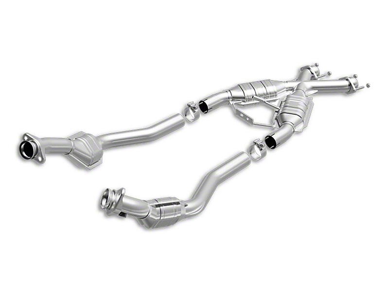

The BELOW is an OEM REPLACEMENT of your STOCK setup, specifically to be identical to your California Emissions Catalytic Converter setup.
Hi, The comments above are true, indeed. It would be near impossible to pass a Sniffer Test without Cat’s. Yes, it has occurred, where they are gutted, and then actually passed the test. If you want advice on how to breeze through an Inspection without affecting your current setup, buying an X pipe setup that will Bolt in place, and replacing it once you have a Sticker isn’t terribly expensive- but who’s going to care once you get a valid Sticker? It’s also a good idea to speak to a Shop owner who will level with you on this in Cali., but being the State that’s not already adopted, but plans to exceed Cali’s Emission guidelines- I can say with relative Certainty you need only (2) Cat’s, your Car came with (4)- But having your Car running good, not throwing Codes- you should be fine.
I’m curious, if you didn’t know you had any Cat’s, look at how the first (2) (or Upstream Cats) are not very easily visible, you may have the upstream Cat’s installed. Here’s a (4) Cat System for your 95’, it’s an X Pipe- but just for illustration purposes...
Note how it may not be easy to see the Front (2). The NEXT is a 95’ Mid-Pipe (2) Cat. X Pipe Setup..
You can Bolt this directly into Place of your current Off Road H-Pipe, looks like this: Call AM or Summit and tell them to give an exact fit of your Bassani X Pipe, with a Catted one- so, Unbolt, then remove- rebolt-DONE!
The 2 lower Pipes show, what I’d wanted you to see. If you are OK with just (2) Cat’s, and you SHOULD BE, you don’t need (4) Cats, if you were a 1996 Mustang GT, then you would likely NEED to be, but you’re one year shy of an OBD-2 Computer platform, being OBD-1, you will likely be fine with just having (2) Cat’s.

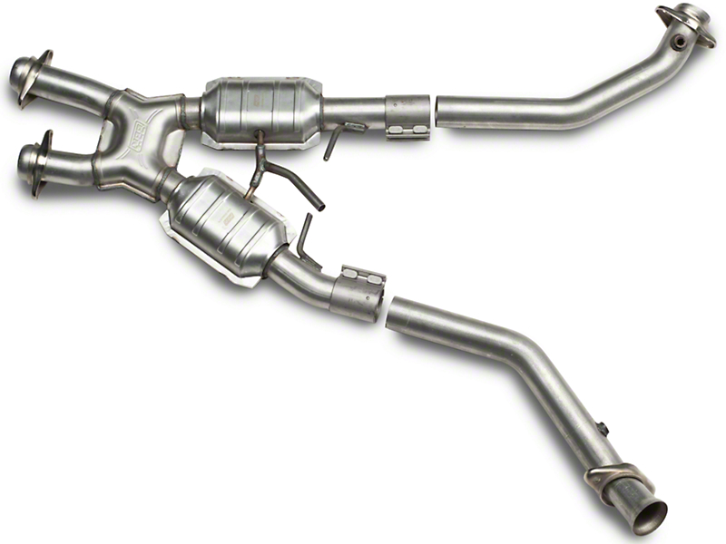

Have any of those shops even looked at the car to see if the cats are there? It sounds like they are being overall cautious without even looking at the car if so. You should be able to look under the car yourself and look for the X in your existing Bassani X-pipe directly behind the transmission. Directly in front of the X (toward the engine) should be the cats. If it's just straight pipe there going to the engine, then you do not have cats.
What John posted up there should be a good reference as to what it looks like. Here is the specific Bassani X-pipe you have on your car (if it has cats).
https://lmr.com/item/BE-50943/Mustang-Bassani-Catalytic-X-Pipe-Stainless-50-94-95-50943
I had a Bassani X pipe installed an a 95 GT, and it only had two cats on the pipe. I passed emissions for years with those hi-flow cats. I eventually had to modify the exhaust to add two additional hi-flow cats so I had 4 cats on the car. Before I sold it, the smog tech said that California was checking model numbers on the cats to make sure they were CA legal; the Bassani cats didn't have the right numbers. This may be why you're failing the visual test.
