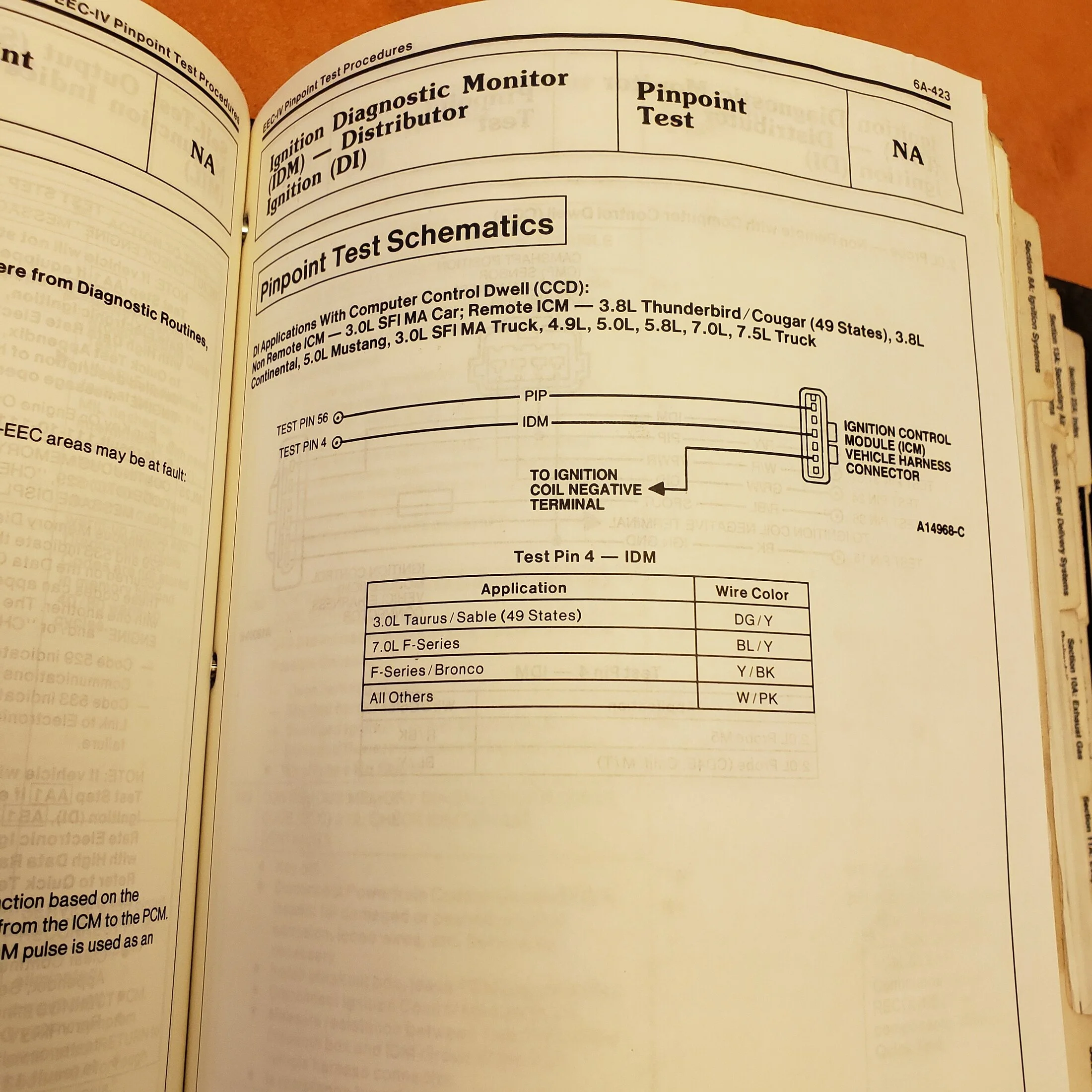

Here is some of that code 212 diagnosis, just for GP's
Reactions: BrightVa
