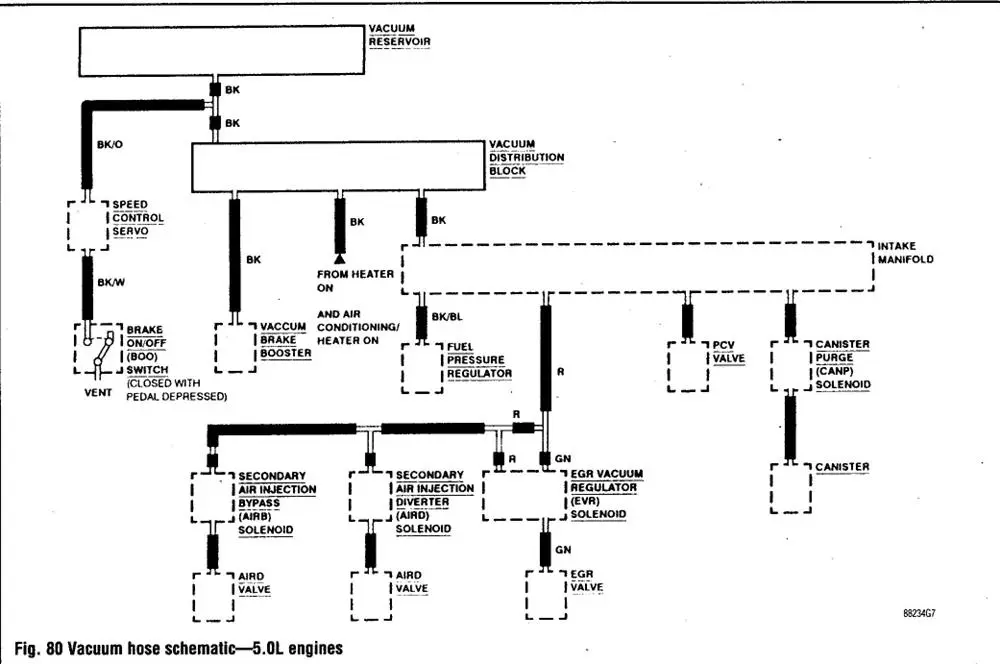

95&03GT New Member Apr 20, 2007 24 0 0 Apr 23, 2007 #1 Apr 23, 2007 #1 Hey I was wondering I did a search and dint find it, but does any one know where I can go to look at a diagram for teh 95 mustang with the 5.o vacum lines? Thanks

1TallMF New Member Apr 17, 2006 955 1 0 Montreal Apr 23, 2007 #2 Apr 23, 2007 #2 Under the hood there is one unless yours peeled-off many moons ago. Haynes manual also has one in there I think. I have some seen one online somewhere way back when, I'll have a look see if I can track it down...

Stanger007 Founding Member Sep 26, 2001 2,015 2 46 Baton Rouge, LA Apr 23, 2007 #3 Apr 23, 2007 #3 Here ya go. Attachments Vacuum_Schematic (Custom).webp 35.8 KB · Views: 189
