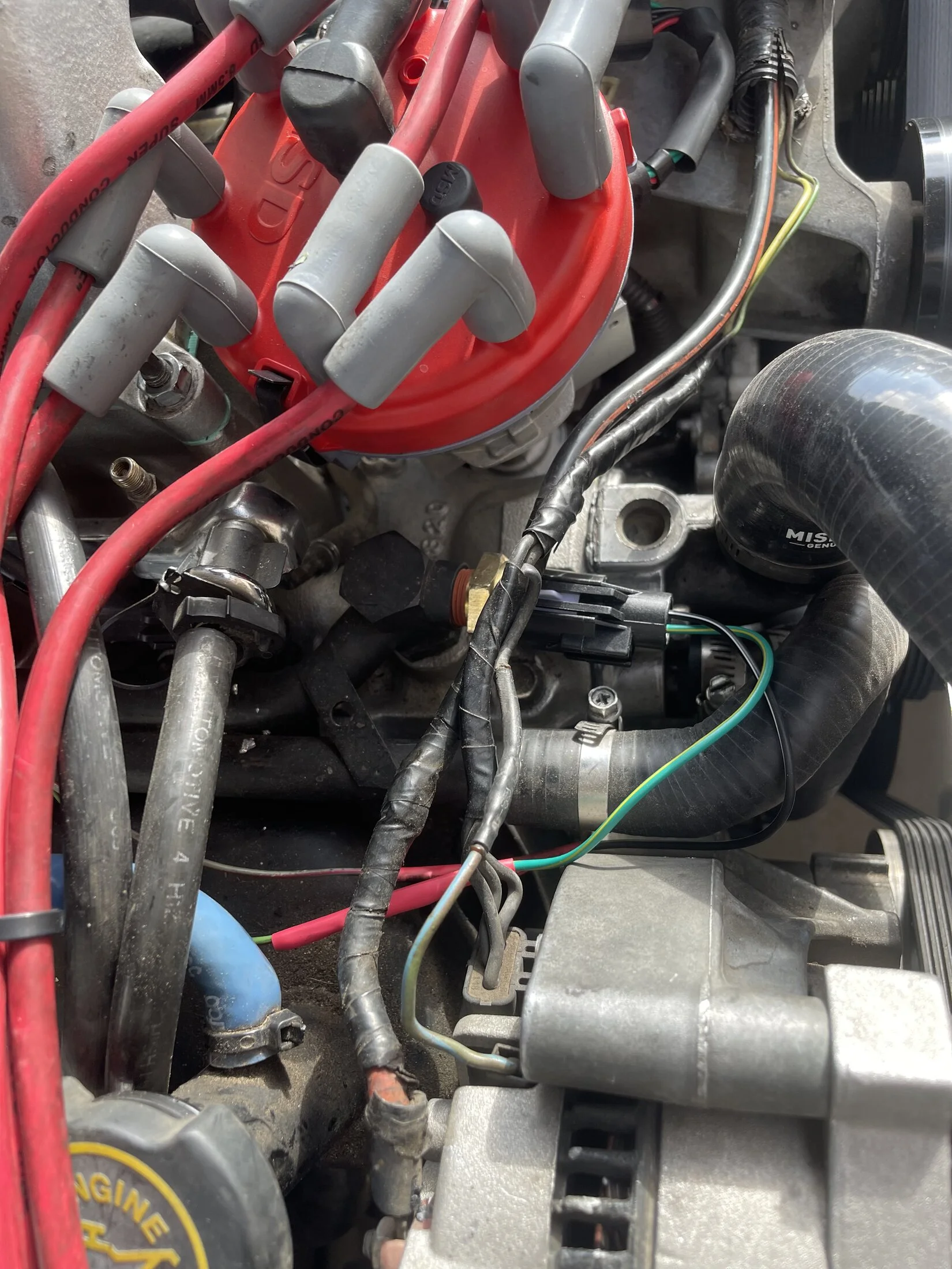

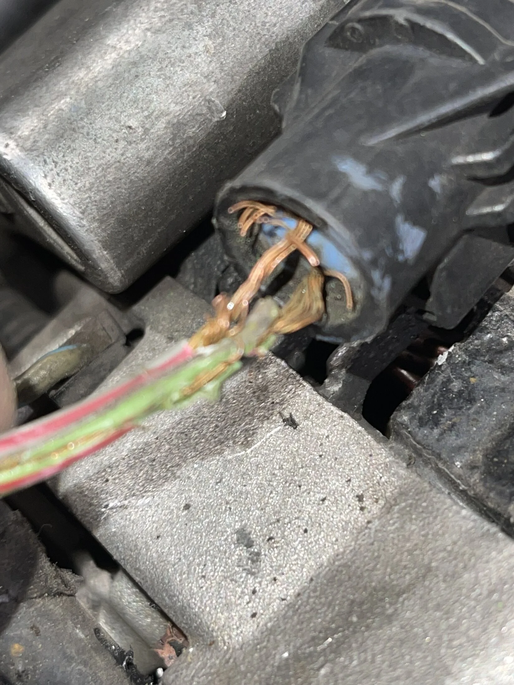

Thanks for the reply I was able to set timing to 12 degrees and installed the spout to advance timing but still acts the same. I can turn it on once and if it dies or I turn it off it just cranks. Double checked tps voltage to .98 double checked timing and ran codes im getting code 998 so Im sure thats the problem been looking at all the forums for 998 and either a bad computer which Ive never had a bad computer or a possible short. One guy had his tps hooked up wrong but I rechecked that and all wires are soldered good and correct color match ups. I may have to take it to a mechanic for the code 998
Hey everyone finally got the 95 running good no check engine lights on. My coolant temperature sensor wires were bare and touching. Ordered a replacement from lmr and now running perfect. My cars picky lol
