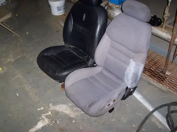

1st pics is how old and new seats looks like (both are driver side)

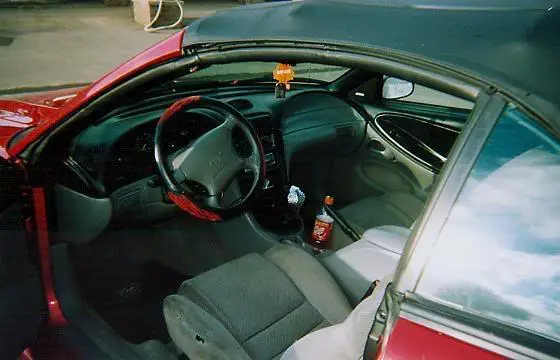

This 2nd pics is VERY old (when I bought my Stang like 22 months ago) so this driver seat was in bad shape a few days ago

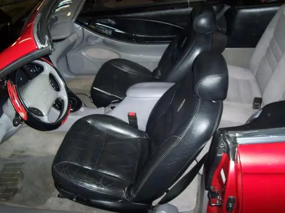

And here is last pics how that looks now

Dollar for dollar, yeah it cant be beat. And yes, it prolly was a good thing for you to do. Im just saying if it were me I wouldt get something that looked more "right" for a mustang interior. Dont get me wrong, it was a good project for 30 bucks. :nice:
Looks fine to me. Just need to paint the interior black as well.
I have a mark8 as well and those seats are Much better then the Mustang ones. Much more firm.
Good project. Just get the grey painted inside as well.
I cant stand my half grey and half black interior. Why couldnt they just make up their damn mind on which color........
:spot:
Black Stampede said:
:barf: :barf: :barf:
No offense, but thats what Im thinkin.............I woulda sprung for those new summit seats. I know you got a good deal, but those dont look right at all.
your just jealous you dont have 10 way adjustable/heated seats lol
if the rest of the interior was also black, i think it would fit in better but i like it.
Ernan, you can buy a complete form fitted carpet for around $110, do that and a rear seat delet and you'll be set. Down the road take them back out and have an upholstery shop stitch something over the lincoln symbol or recover that section on the seat grey to match the rest of the car. All in all, that's not bad at all for $30!
Even though they do look out of place you got a great deal and will have a much more comfortable ride then before!!!! :nice:
If money is tight and you can't afford to change out the carpet and paint the grey interrior I would just invest in some nice light colored seat covers for now.
