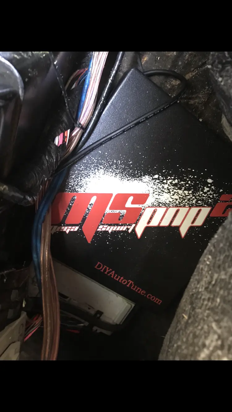

So I just bought a 95 Mustang 347 that needs a bad tuning runs very rich and doesn’t get nearly the power it should. I notice it has a megasquirt computer in it. The shop by me wants me to ditch the megasquirt and buy a regular 95 GT computer and custom tune a chip. Does this sound right? It looks like those megasquirts run around $800? Which would be best keep or ditch the megasquirt.

Depends on what ms it has in it. Can you get me a picture? How much are they going to charge you for a chip? They want to pull it out because they are not familiar with the system. Are you in an emmisions state?

I appreciate your input! I do have a laptop and they’re is a cord coming from the MS into the glove box that looks like it would be plugged into a computer

I run the same mspnp2. The megasquirt is better than any chip. They don't know what they're doing with MS. There's also a phone app for android phone called MSDroid it allows datalogging to the phone and gps mapping of driving routes.

I have that exact same MS system in my 331 Stroker and dont have anywhere near that amount of power. The MS platform you have there can handle any of your needs and then some. In my opinion the MS platform out beats any chip that the shop can throw at it hands down.

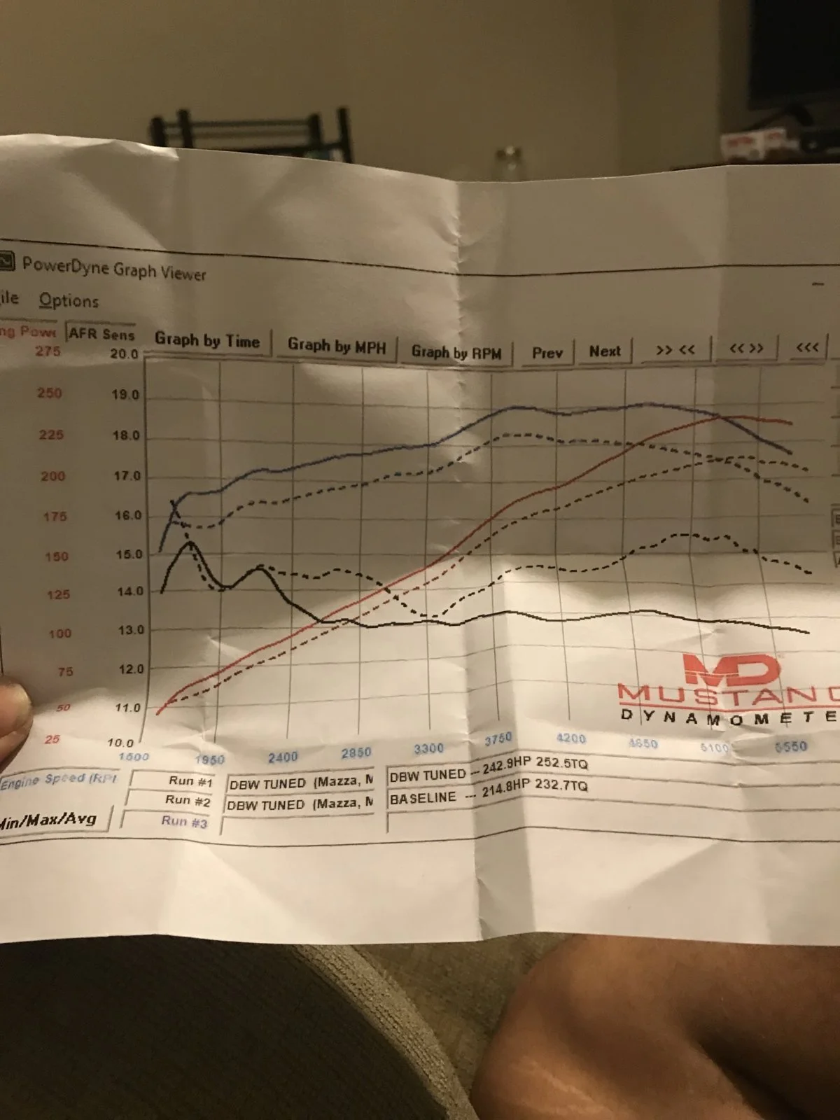

So I got it tuned with the megasquirt and these are my numbers. Is it just me or is the wrhp low? It’s a 95 mustang 347 stroker BBK headers trick flow intake and some other stuff.

Yes those numbers seem low, i wont comment on why until i know more about the engine and what heads and cam it has. I also want to look at the tune, where did you have it done and what did you pay?

I paid $575 and luckily megasquirt is based in Ga and I’m in GA. DIY autotune.com refered me to Doug at DBW motor sports. Only thing I was skeptical about is they seem to specialize in Subaru’s and Imports with the occasional mustang coming in.
