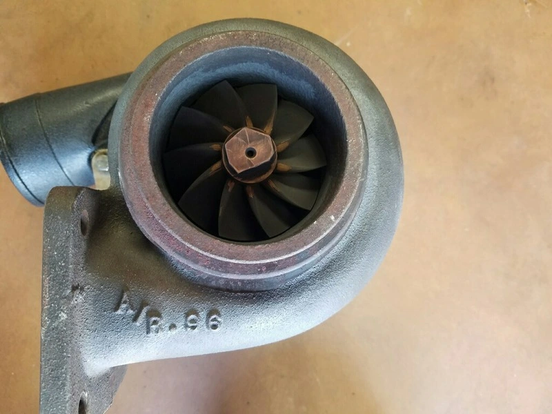

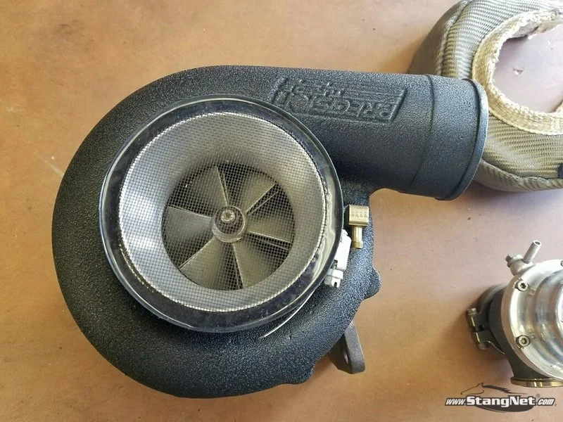

2.) I bought a pony down turbo setup with a Precision 78 turbo

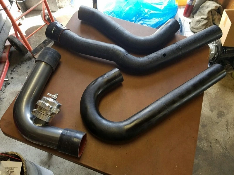

Well I cheated, I have started the build but the car is not finished yet. It is in the body shop now, they are deleting the emblems, shaving the antennae, installing the cobra bumper and paint. I did not expect the amount of modification for the turbo or heads and really the most difficult part has been the modification required to the turbo setup. There are 2 issues, 1 i'm using highport heads and 2 the kit is for a 302. So to start out I had to buy a tig welder and teach myself how to tig and that has been the fun part. Bad part is mocking up tubes, turbo and brackets only to pull them back apart. And time, man that has become a commodity these days
The turbo kit is in good condition but the added welds and bends are not the greatest plus I will have to modify all of the cold side past the
intercooler discharge

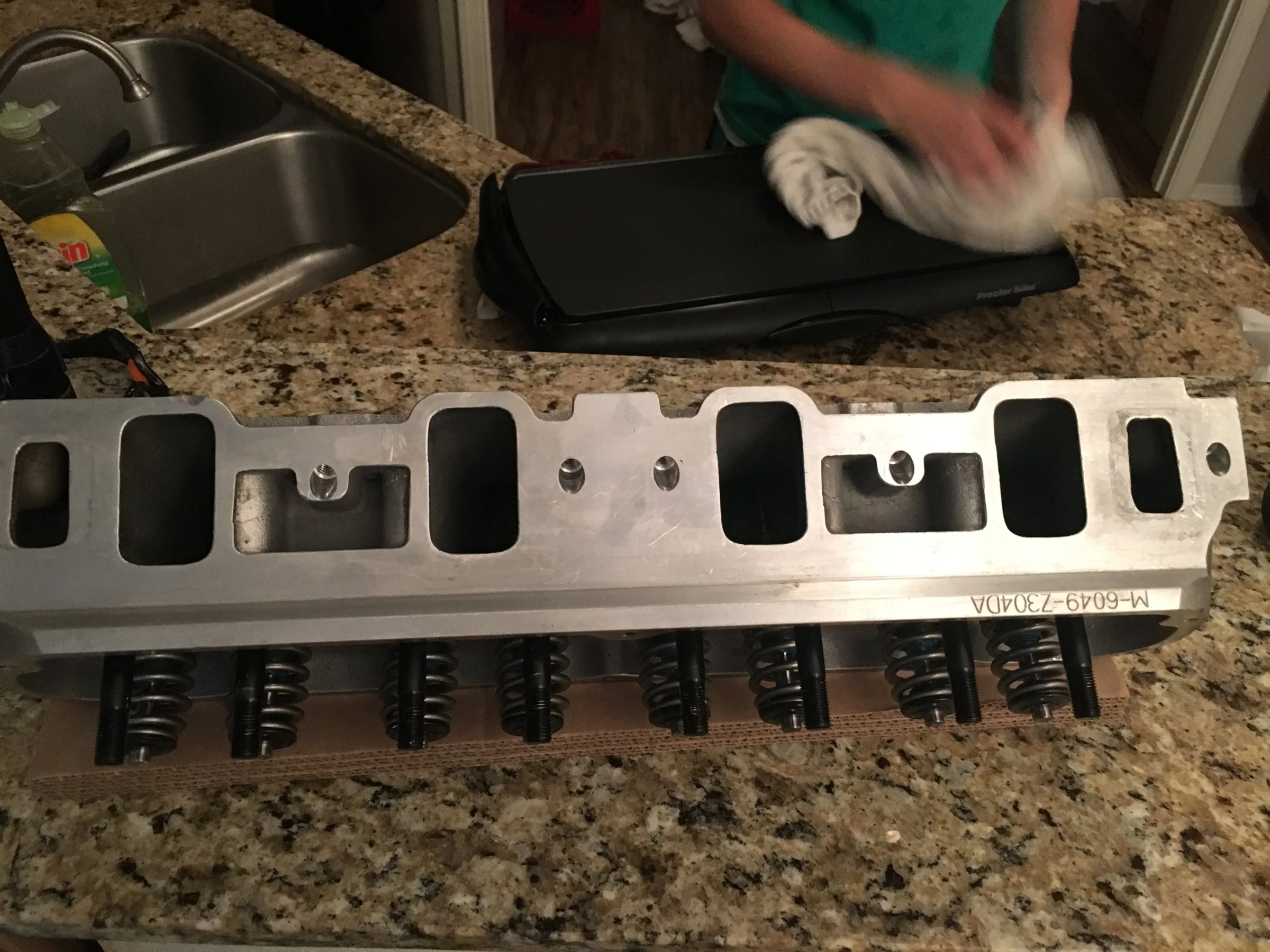

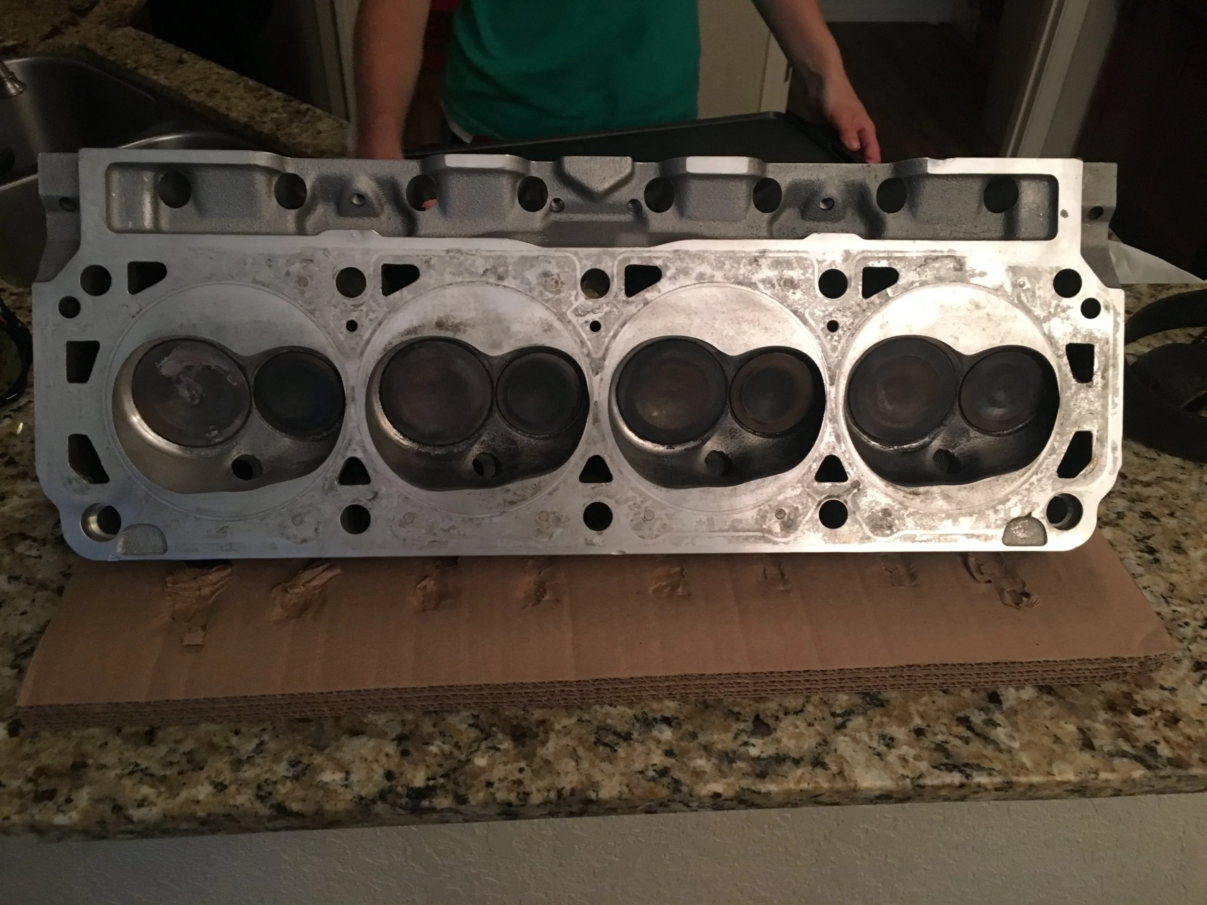

The heads are z304DA CNC chambers 210cc intake and 85cc exhaust. In this case, these heads were not a good choice for this build. The rocker
assembly is offset and expensive to set up, and the high port design makes for more modification to the hot side. What i do like is they are a more
"exotic" head, thick deck bee hive springs, inline valve design. The good part is I paid 1200 for the set so I'm not even half what they cost new. This particular head was run on a circle track car.

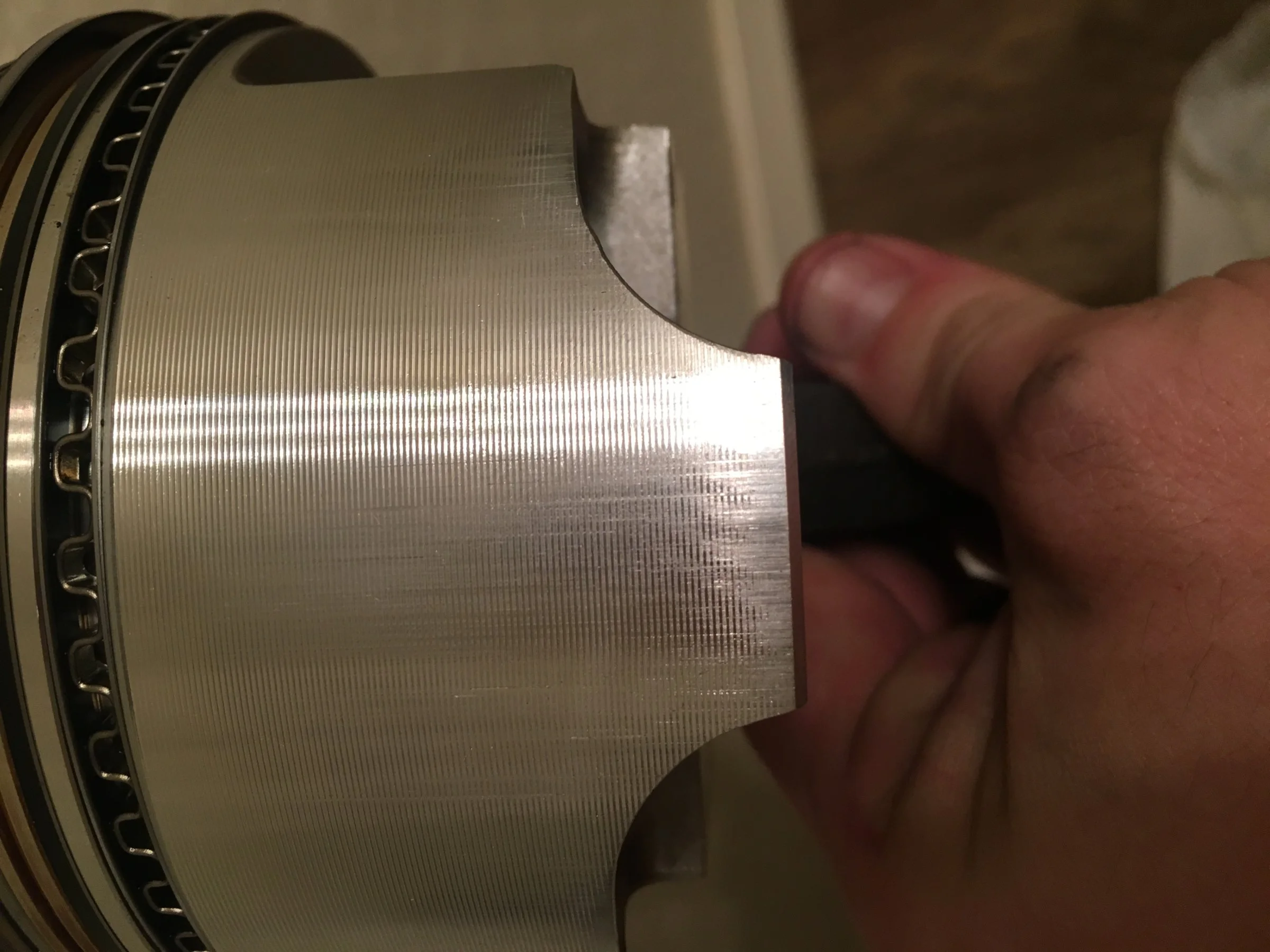

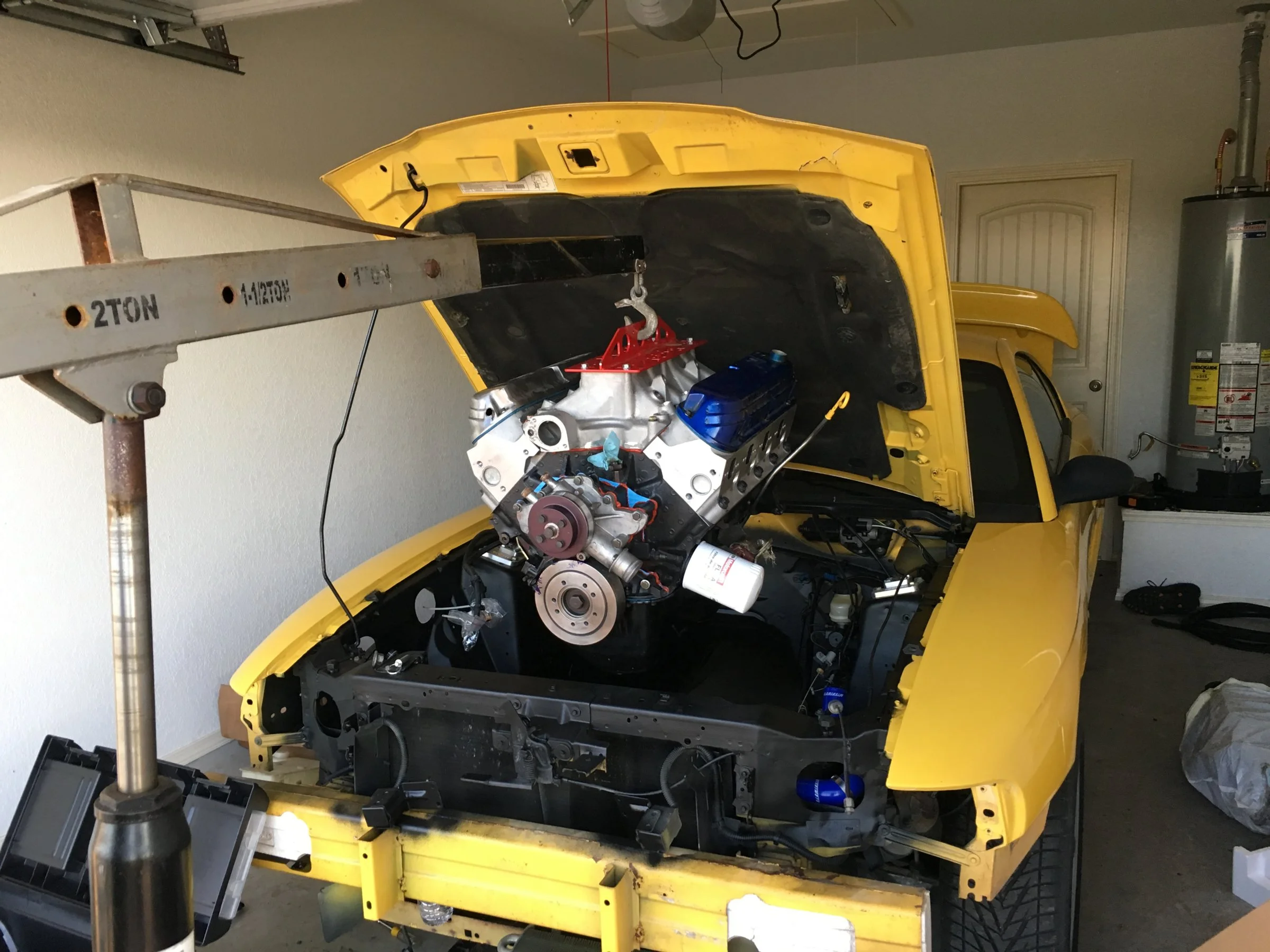

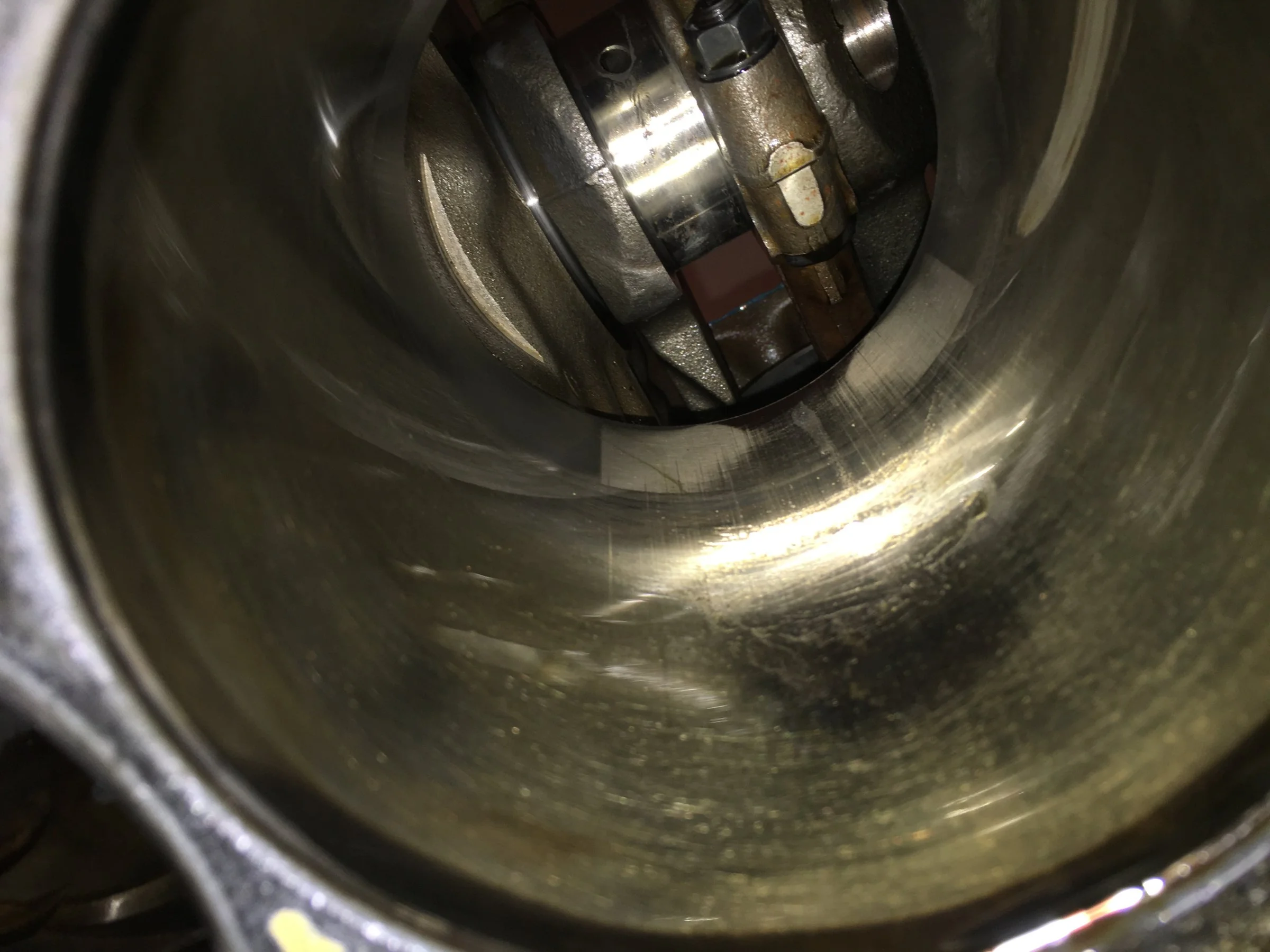

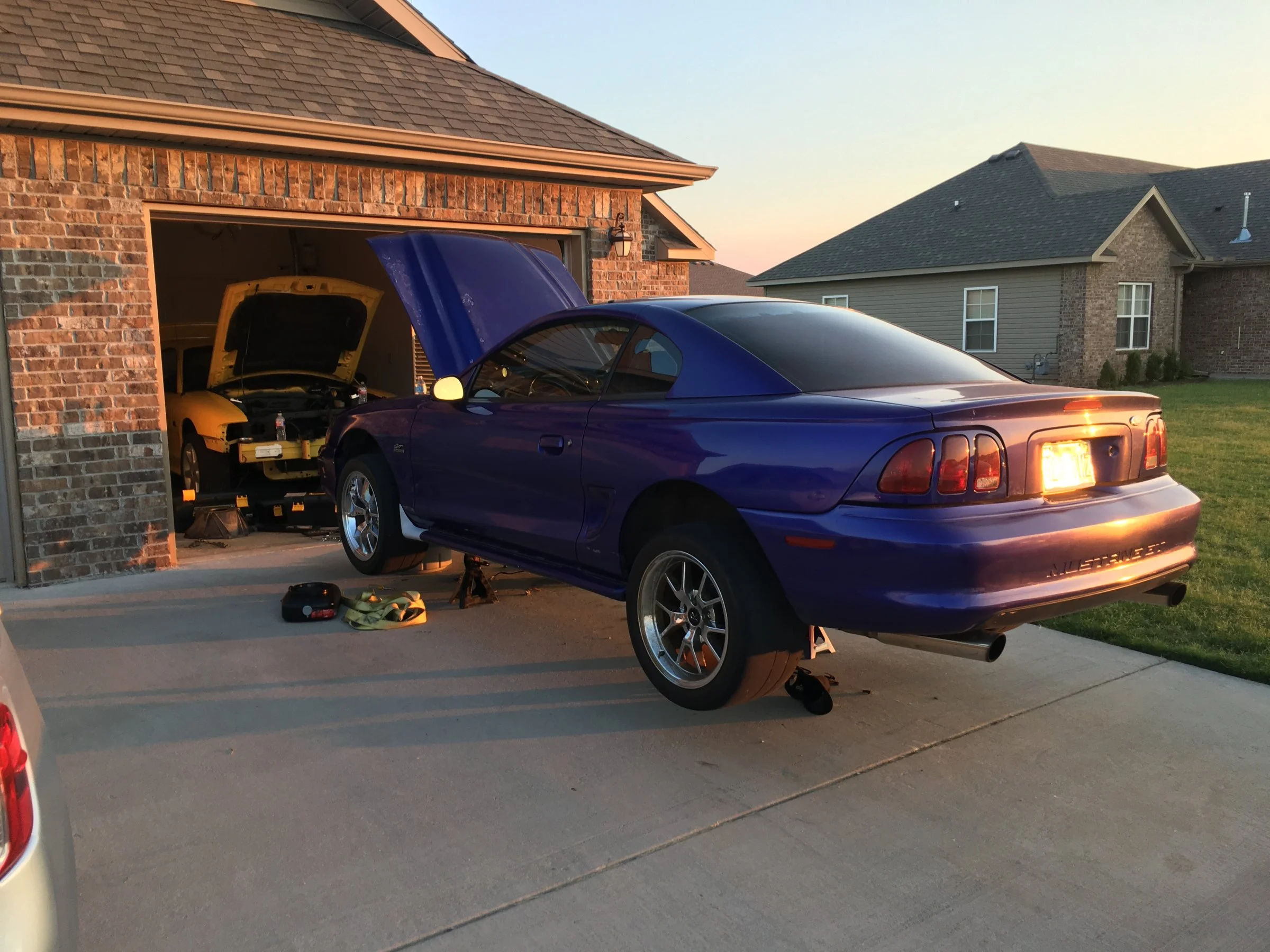

When I started the swap we had just moved so I was renting and owned a home. Parts and tools were between the two and as you can see, I didn't have alot of room. I won't bore with engine build pics. If you want to see those go to the beginning of the purple swap. I tore the engine down and found the wall honing gone on the thrust side and light wear on the piston skirt. My assumption is I was running to much methonal and washed the walls. Other than that everything was fine so I had the engine cleaned, rehoned, put it together and Installed the new heads and cam.

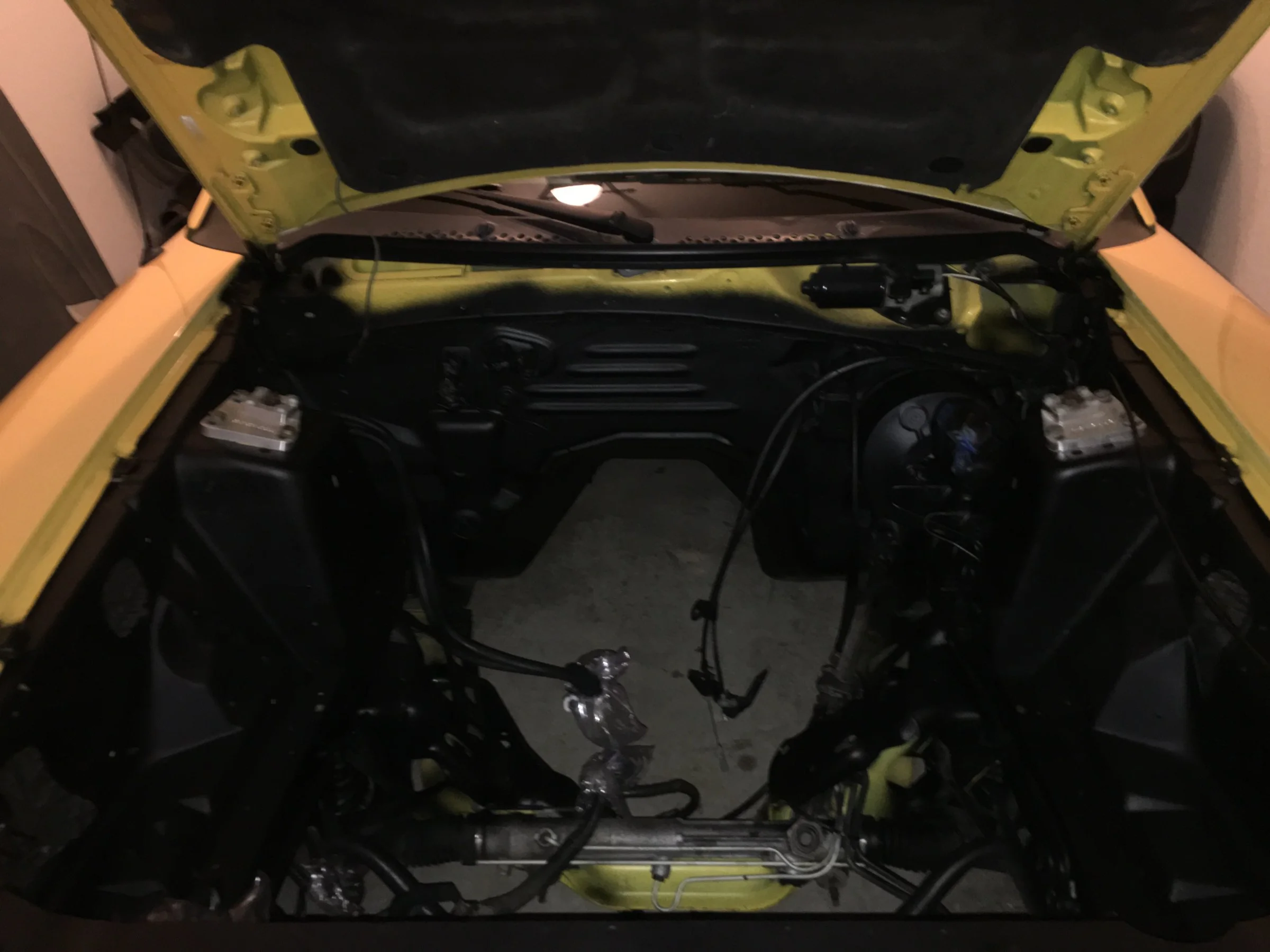

I painted the engine bay the same as the purple one except I used a different truck bed liner. Autozone's version was simply plastidip and peeled over time, what a scam. I went to oreillys and bought whatever they had. It is a very durable finish. I wasn't to worried about overspray, body shop will clean up my mess.
All the wiring was removed and will be tucked away, A/C was scrapped and that sucks, I'm going to miss it!
