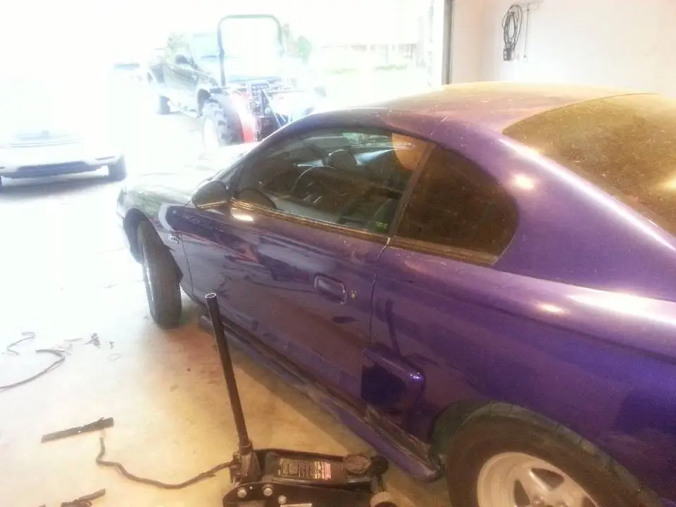

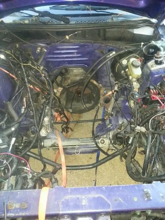

Long story short, I bought this 95 as a project. The car was built by Murillo Motorsports and they did an outstanding job. However the owner attempted to do a few mods himself, not so nice...... The wiring is shot. the good news is I have ALOT of good parts to mess with and the bad news being I have to start all over on the build. Shortly before buying it, the motor detonated and took out 3 pistons. While tearing the engine down, I found alot of cylinder scuffing and pretty bad main cap chatter. So out with the old and in with the 351.

notice the wiring?
Got rice?
So the engine came out last week and there is alot of cleaning, rewiring, and painting to be done

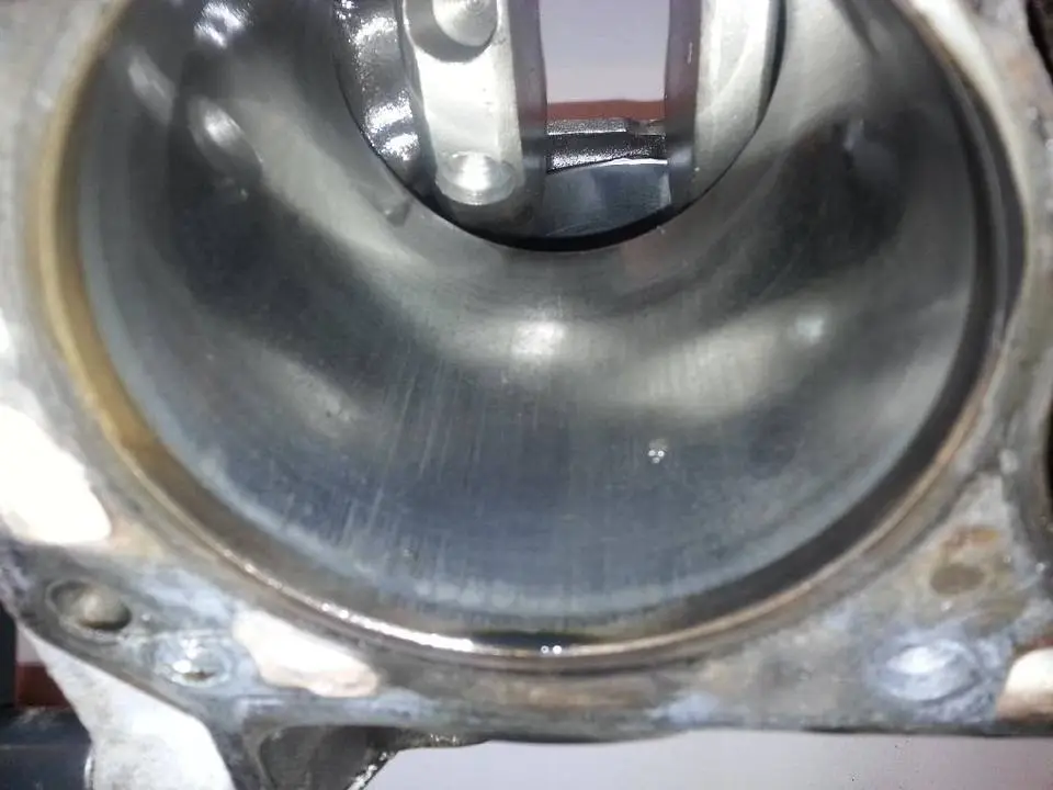

scuffing and no crosshatch after 20k miles

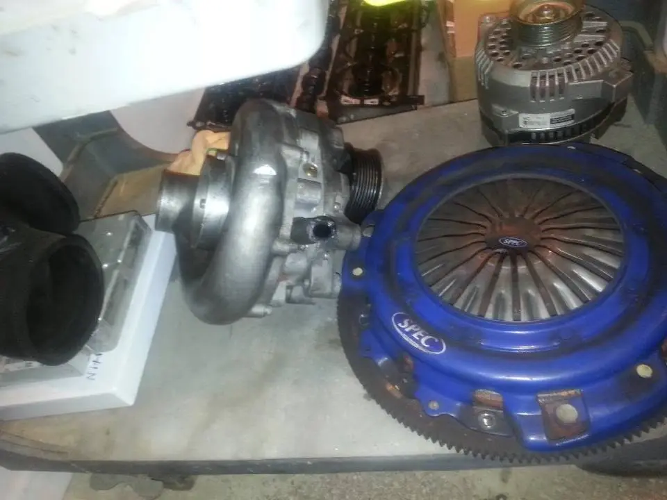

best part of the build! boost
more dericing.......

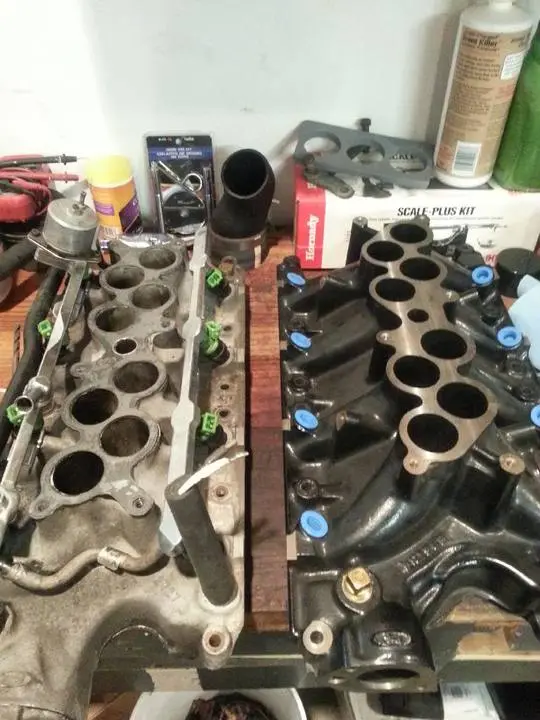

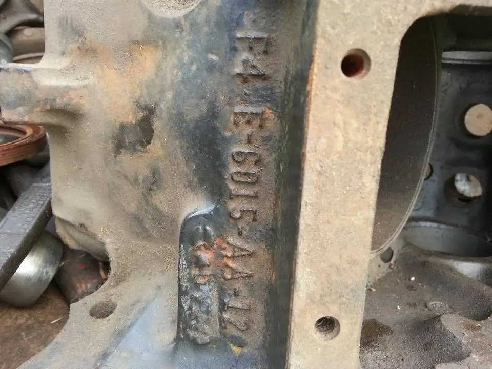

the new block is a marine engine, notice there is no T after the 4. Still has the crosshatching and looks hardley ran

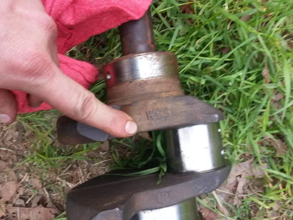

Sorry for the terrible pic quality. Here is the crank. The first thing i noticed was the large transition radius on all of the journals. This is the first windsor crank, I have seen with this radius, other 351 cranks do not have this radius
I was excited to pic up this brand new 351 gt40 marine lower, 330 shipped. Very good quality and i can reuse the upper. Win win

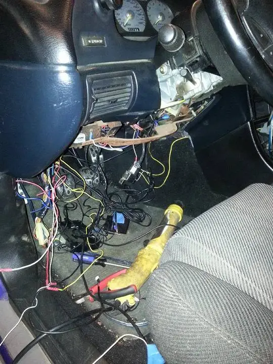

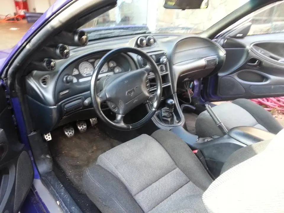

The interior is in perfect shape. Besides having to rewire the gauges(which were professionally wired and then "rev b" by the owner

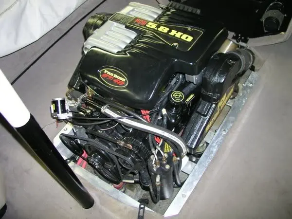

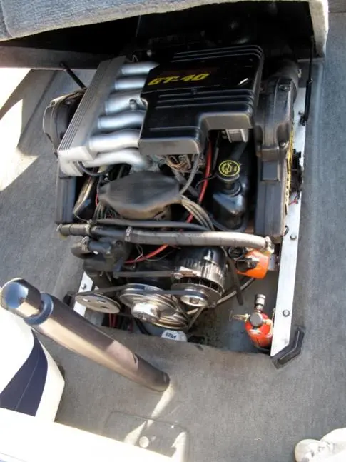

Cool build! I am interested to learn more about the marine engine, I had no idea the short block was any different than the passenger car stuff. I grew up around boats and I always lusted after the marine GT40 engines. They came in a few different flavors, like some with the Lightning-esque tubular intake and some with the Cobra-R style cast intake, but finding real technical data on them is difficult.
I always thought it would be kind of cool to drop one in a Mustang, plastic cover and everything.
Anyway, keep the progress coming! If you have any more deets to share on the marine engine, please do!
Dericed and agreed
Good progress. I'm building an SN95 as well. They don't get as much love but I've grown to really like them.
I also feel your pain on fixing wiring messes by previous owners. I just finished tackling that myself. Good work and good luck. I look forward to seeing some numbers as a 351w is what I'll move onto next
thanks, i think the interior is much nicer than the fox.
short blocks are the same, only the pn reflects a marine use. Also the crank is the only other difference and that is probably the same on all 351 rollers. Thanks for the interest and i will keep posting

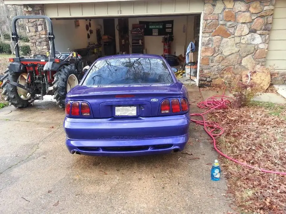

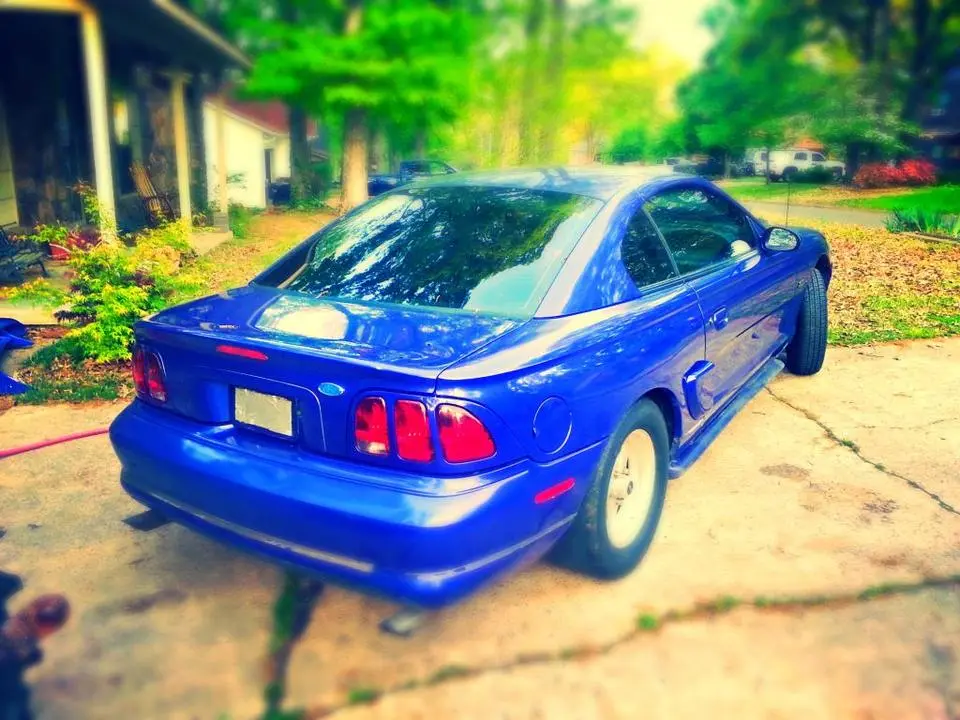

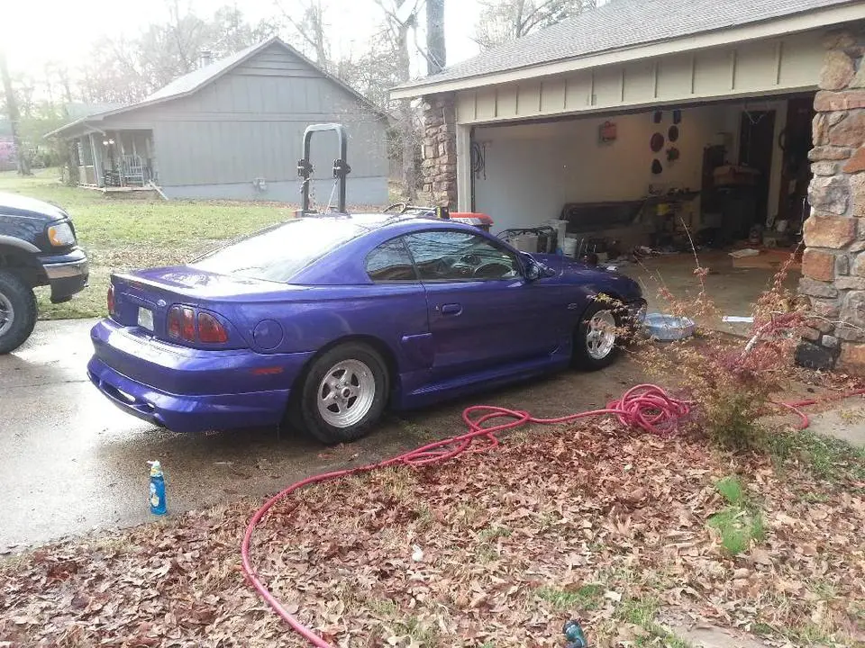

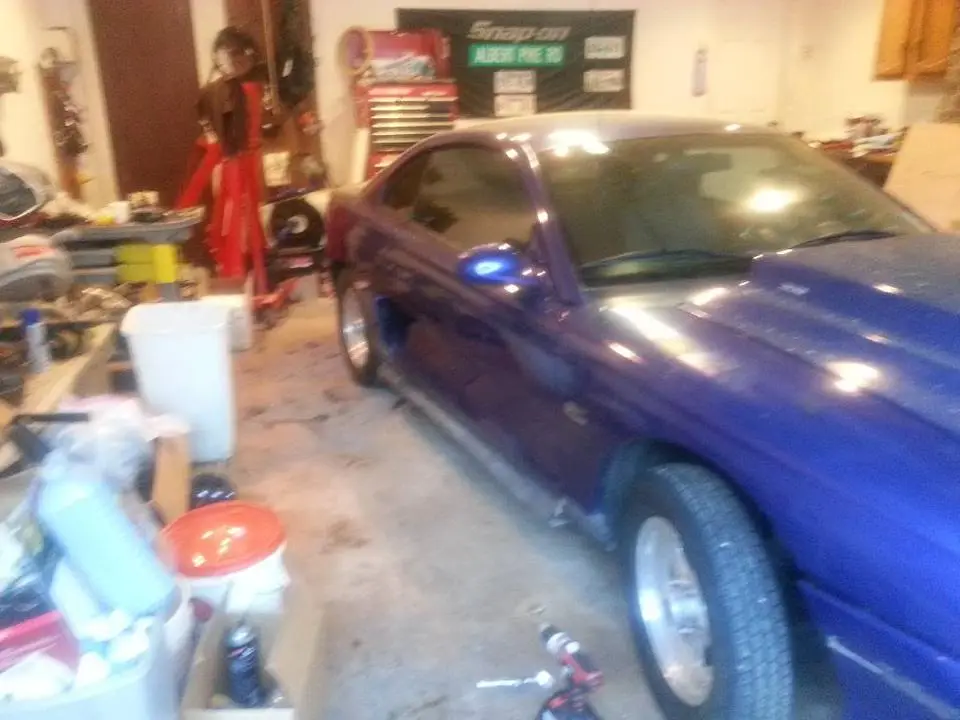

Well, I spent the afternoon pulling the rest of the rice off the car and giving it a well need bath. After a good hour washing and detailing it the paint is getting better. Wow what a difference a little love will make!
The hood and fenders will need to be repainted but the rest really shines. alittle buffing will bring it back. relieved to say the least.

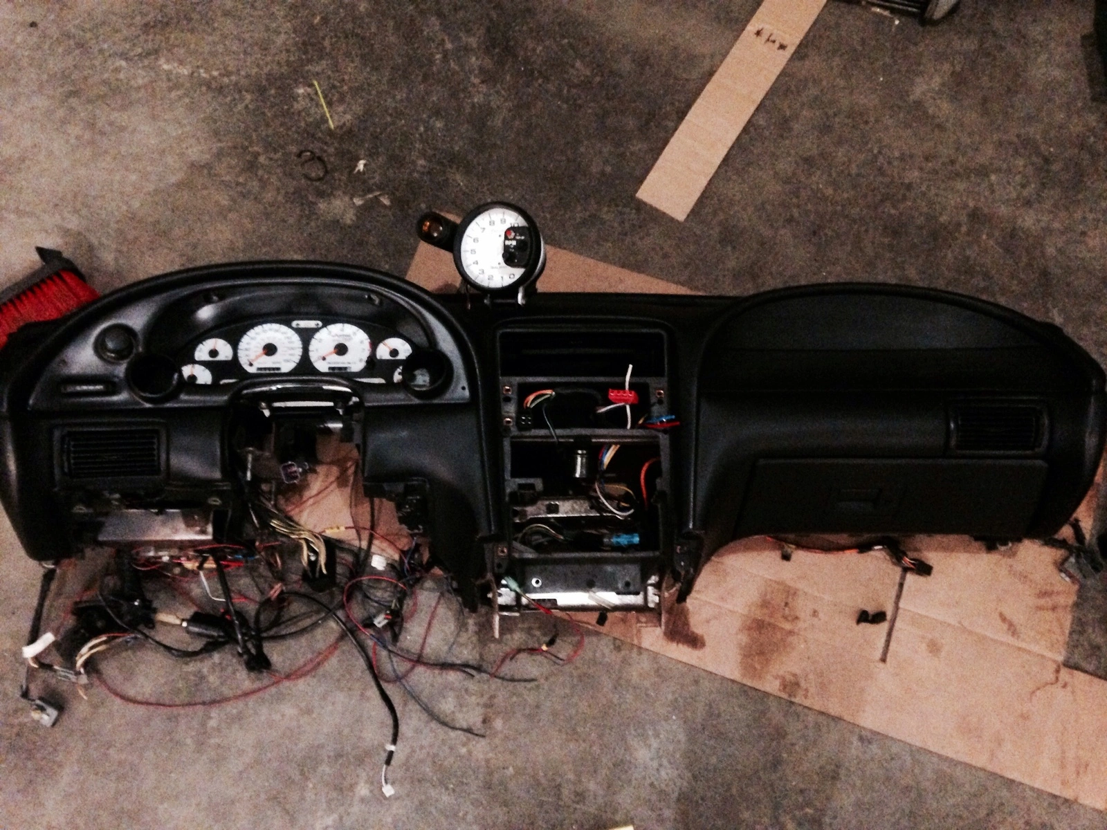

I pulled the rest of the gauge wiring and alarm wiring. He complained the alarm would go off while he was driving and it happened to me as soon as i started the car when loading it on the trailer. the remote has a sticky button and i found the shock sensor wiring smashed in between the steering colum.
The gauges are shift glow elite. I was going to swap it all out for AEM gauges to match my wideband but I'm going to keep these. I am impressed with the quality of the elite series. On top of that they are not cheap like the standard glo shift gauges.

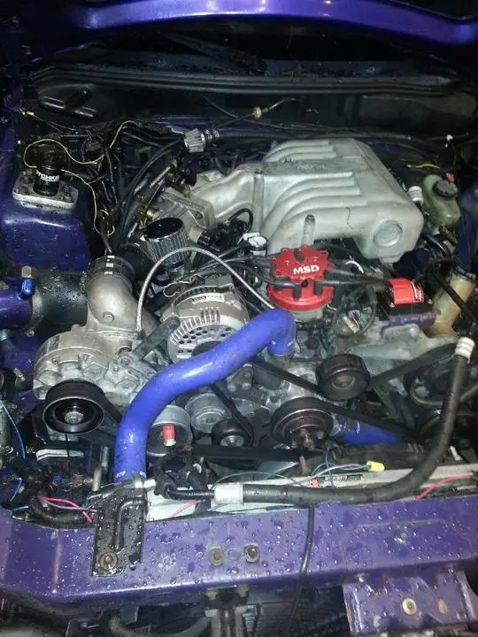

I pulled the MSD 6AL-2 with 2 step built in last night. I'm not 100% sure but the box was hooked up to read amplified point output instead of magnetic pickup I am pretty confidant that could cause timing issues.

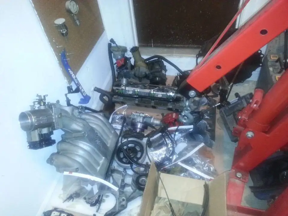

So the mustang is disassembled as far as I think it needs to be. Now the rebuild can start. Hopefully I will have the block back within the next couple of months. then the build, followed by break in. In the mean time I am rewiring all the gauges, alarm and relocating the battery to the trunk. With some luck this mustang will be tearing up the dragstrip by fall.

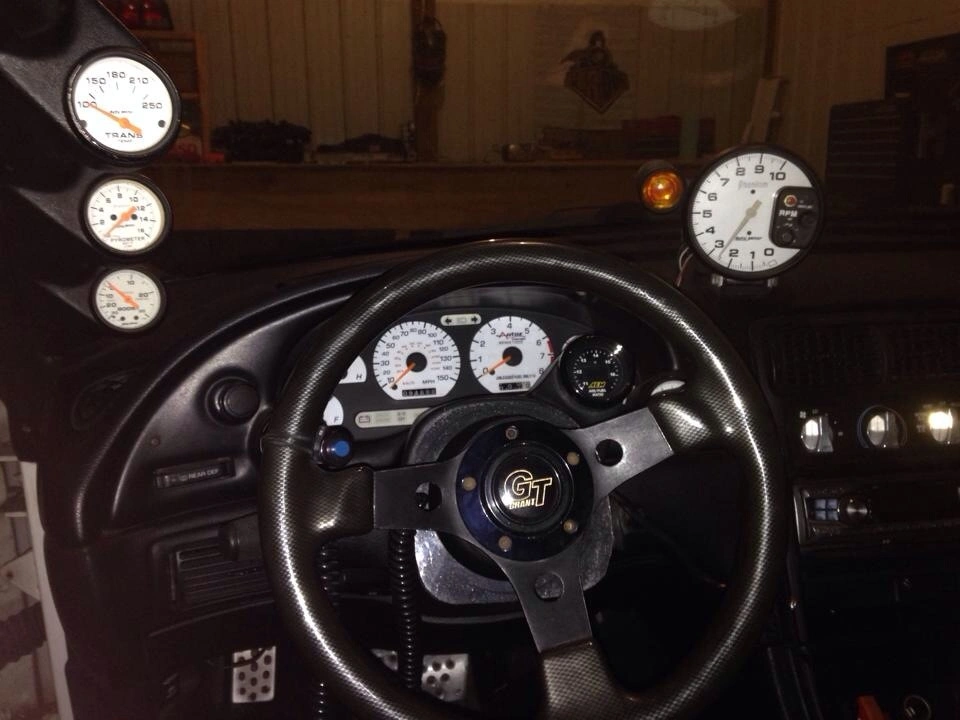

My car also had an excessive amount of gauges. There's also a few more than you cant see
What white faced gauges are those?
