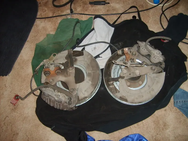

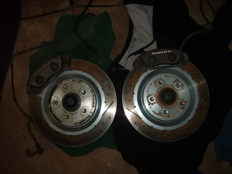

well heres what I got...I have the full assembly not just the rotors and calipers...Now with what i have will I be good to just bolt it all up and be done or will I still have to get the Banjo bolts.

Your banjo bolts are already on there. The other end of your brake hoses (where the small red tabs are) connects to the hard brake lines on the vehicle. It looks good to go, just bolt everything up and give them a good bleed. Good Luck.
