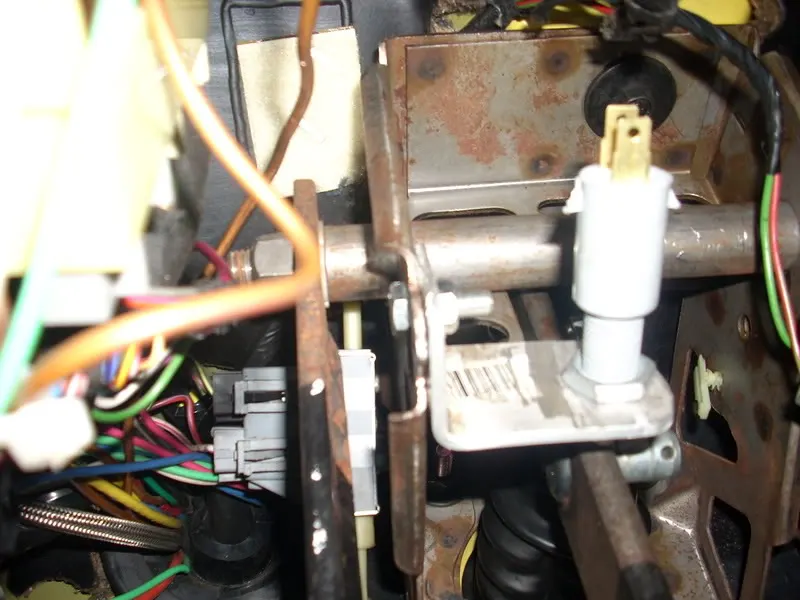

I know I don't have a definitive answer for you, so I'll do my best to help. I know the quandrants are the same, so the clutch pedal assembly will work fine. I had to redo my brake assembly for my manual brakes, which required huge customization. Unfortunately I never took any good pictures. I only have this one picture I took of adapting a Chevy stoplight switch to fit on a Ford pedal. The only issue I would look for is the 4 mounting studs for the brake booster. The 96+ Mustangs have hydroboost, and I'm not sure if those 4 studs that go through the firewall are in the same location and with the same spacing. The vacuum switch is only for the cruise control. The stoplight switch is not an issue, because those are cheap, and you can make either work.
