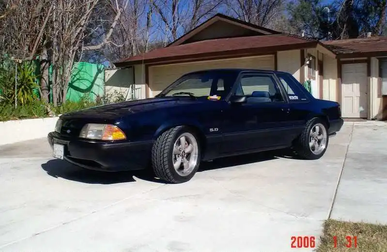

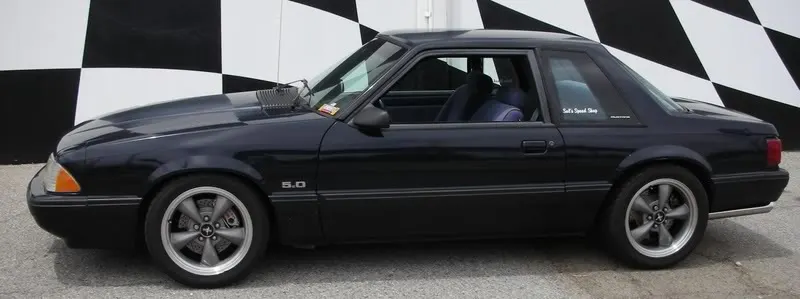

Here is a pic of my setup!
17x8s on a 96-04 spindle will work fine. I'll post a pic in a minute. Thats what I am going to run!

Thanks for the help guys ... Grey5.0 are those the 17 by 8 ford racing bullets up front ? Streetrod's stang looks hot with those wheels...

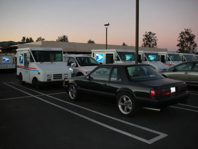

Yep, they are fore sale $300 takes them. Thanks, here are the new wheels 17x9 with +28 offset with 96 spindles. No rubbing and they do not stick out. I run a 235/45/17 tire. I had a set of 17x9 Halibrand rims with 5.5 backspacing and they stuck out about .25 inches.
