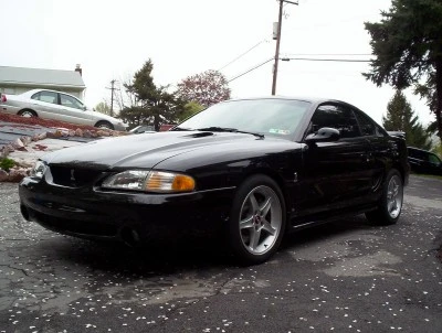

does anyone have the parts list to convert 03-04 cobra blower to onto a '96 cobra powerplant, i bought stock fuel rail, stock injectors( blue- i think thats 30lbs??), blower(w/ 2.850" pulley), throttle body, polished inlet, and a steeda intake all off a '03 at all ford nationals over the weekend, i have a good bit of the expensive parts taken care of i just need the rest. or make an offer ?
more pics
