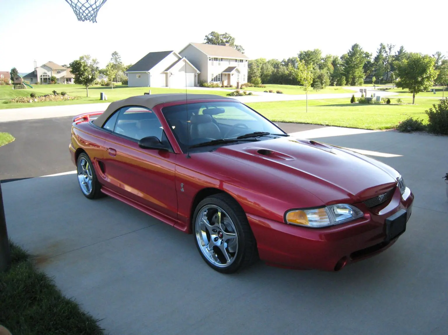

As far as steering and handling. I have 265/35-18's all the way around on my '98 Cobra. Expect to feel the road more, wheels and tires may tend to track and pull to uneven road contours more than the stock 17's.
Hope that helps.
