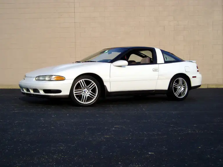

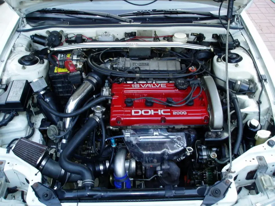

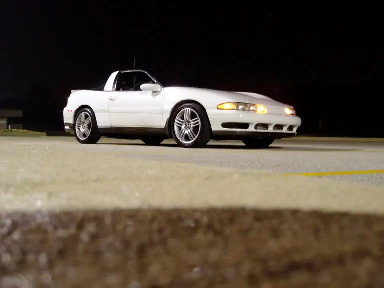

Heh, this should be a fun change in pace for me. I'm a musclecar guy who hated, then stumbled upon 4cyl 'imports' and I'm selling mine now. I drive a 92 Plymouth Laser AWD 5spd, same platform as the Eclipse GSX and Talon Tsi, which I have tastefully modded (farthest guy from a ricer ever, just addicted to boost) and runs religeous high 12s around 106. Cutting 1.73 60's on street tires:nice:
It's fun, but I love stangs and I like driving cars with some tq. I really wanted a 5.0 sn95, but the price is just too good on this 96, and it seems they can be very compotent runners, and the modular sound is really clean.
Here's some pics of my car, should be gone soon tho:(

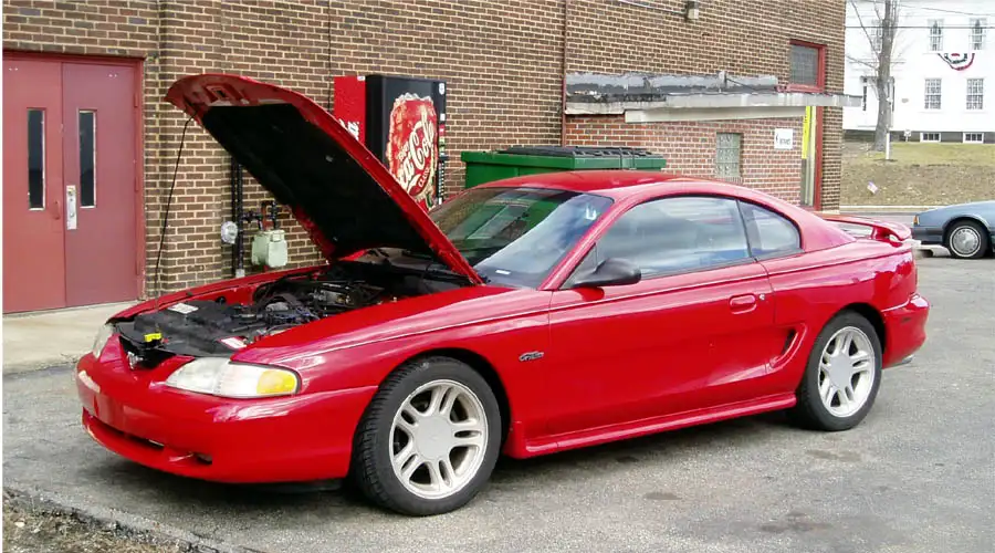

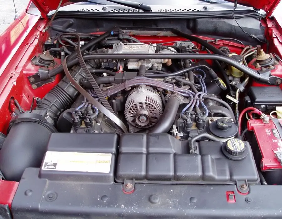

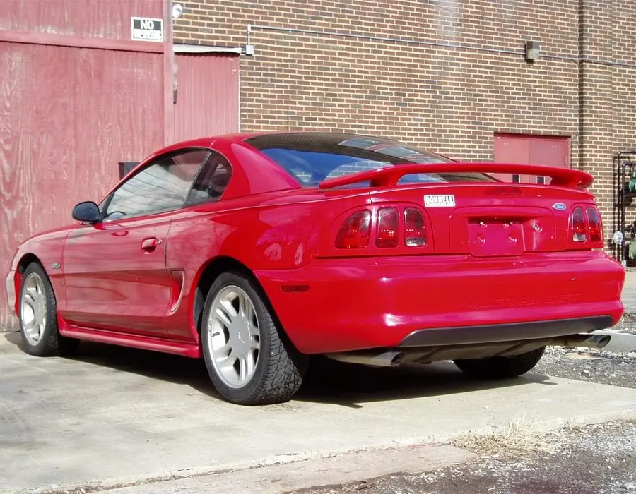

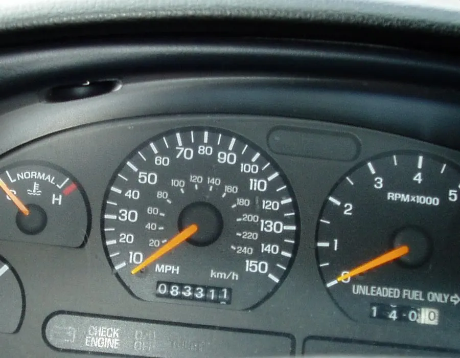

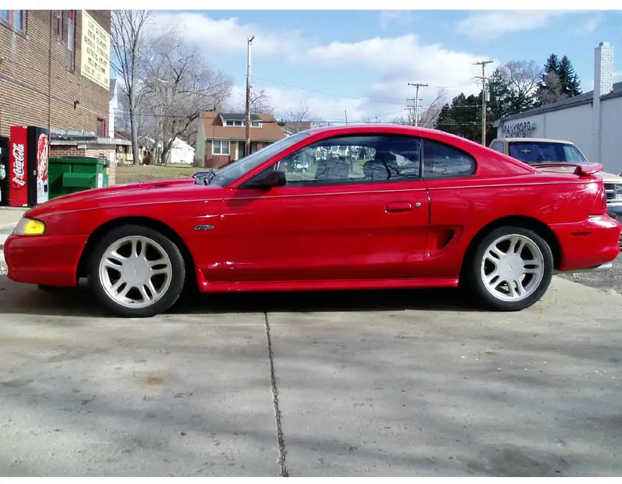

He had the belt off on purpose, as the a/c compressor was frozen up, the belt itself isnt bad. I am located in Northeast Ohio though. I'm not really lookin for any other 4.6 cars, this one happens to be real close and in nice shape. Here's some pictures of the car.
I took those today when I drove it. Any opinions?

The powersteering pump assists in braking power. With the belt off, there was no power steer pump, so it would make the brakes very hard. It will be fixed when you put the belt back on.
Did not know the powersteering assisted in braking! Good to know! Cause this thing wasnt stoppin for anyone.
Now I gotta decide whether to pull the trigger on it or get a 5.0 variant. How do these computers take to mods? I'm going to thoroughly research the PI swap and what it involves.
Thanks for the help!
The PS pump double as a brake pump. Put the belt on and you have no problem. The AC may just need a pulley swap. If the bearing have gone it probably seized up but the compressor could be fine.
