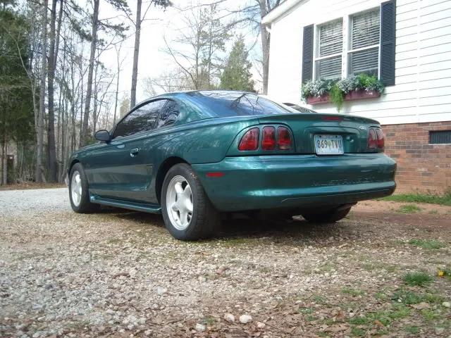

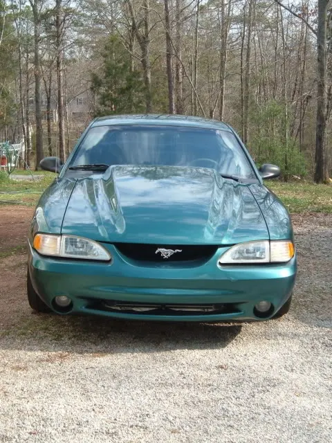

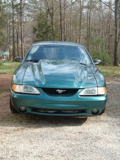

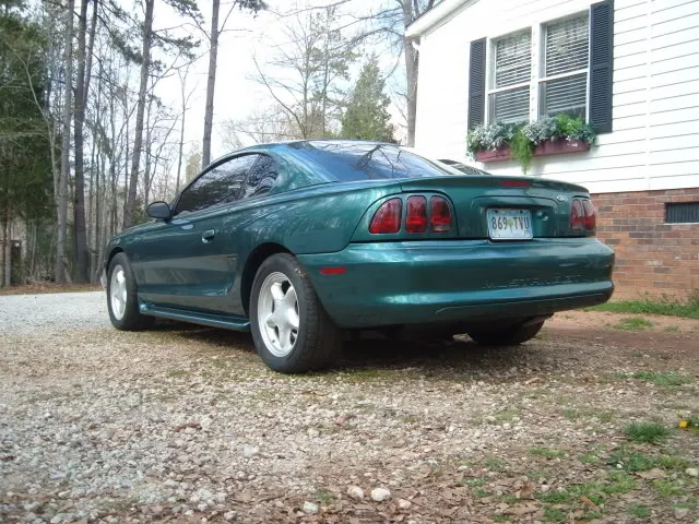

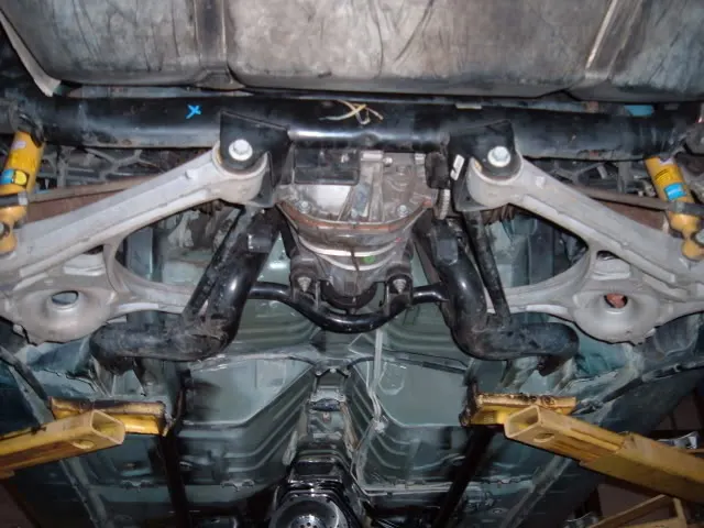

Ok here's the suspension setup:
QA1 K member and A arms
GMS front Coil Overs
KYB Struts
Steeda r bolt C/C plates
03 cobra IRS w/ stock springs cut 3/4 of a coil w/ all isolators and MM diff bushings.
Turbo.. what turbo :D :jaw: :lol: :lol:

Is the IRS stock or does it have some upgrades?
Do you get any wheel hop when doing burnouts?

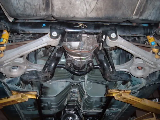

Ok.. here we go.
Yes it bolted right up, but the 96-98 cars are missing 2 bolt holes for the IRS subframe rear mounting brackets so i welded them in.
The IRS is completely stock except for MM IRS bushings. no wheel up from this one from what the last owner said, i haven't tried any b/c i'm breaking in a brand new motor and burnouts = no no
Car drives absolutely AWESOME.. i WOULD NOT go back to a solid axle at all now.

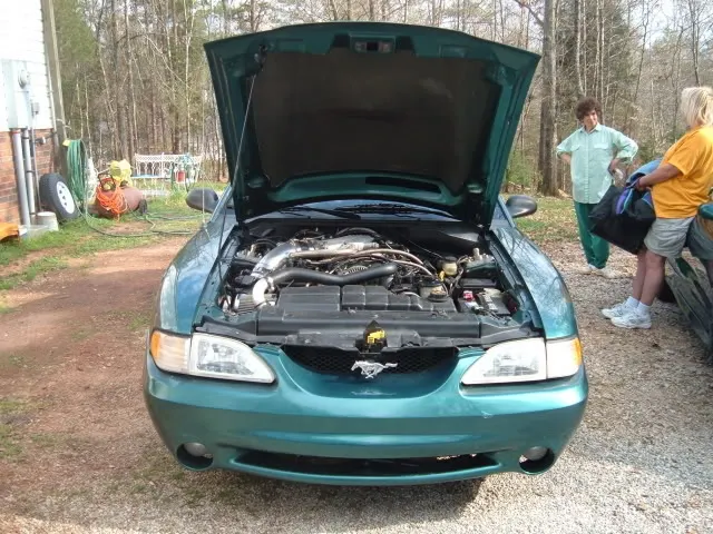

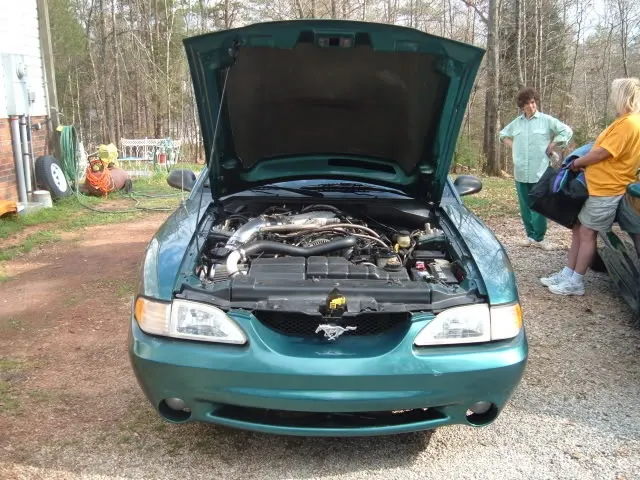

I apologize bro....I didnt mean to offend you if I did.. Anyway the car looks nice & looks like a great sleeper. I once had a black 96 GT & I wanted to turn it into a sleeper with an 03 Cobra motor. I like the IRS swap, & the Cobra front fascia & R hood are a nice touch. The only other thing I would do is add some nice wheels, 18-9 & 18-10, & an S197 spoiler.

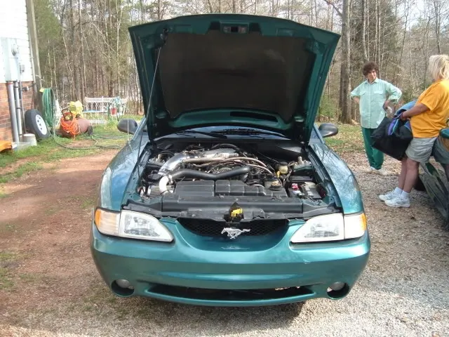

Ok this is way off the subject, but why is that dude in the matching green pants posin like that in the background? LOL...Is that u?
Cause thats not a dude, lol.
