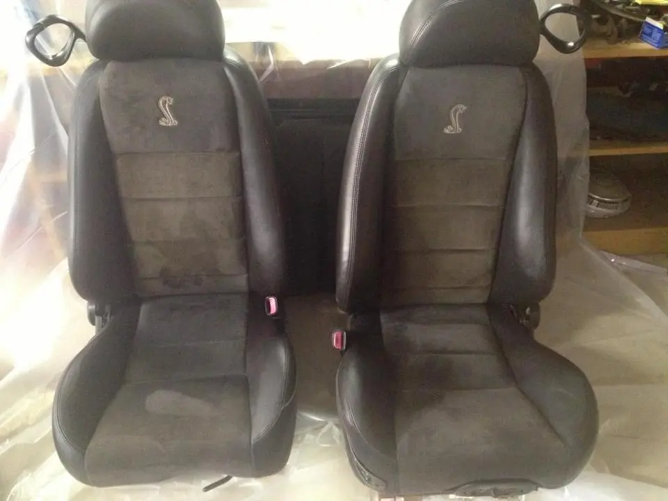

Those seats look mint. By far the most comfortable seats I have ever sat in, and everyone else that rides in my car says the same thing.
I sat in them when I got home and they felt awesome. They are in mint condition with just needing a good cleaning and leather conditioner to loosen it up just a bit. I can't wait to get them in.

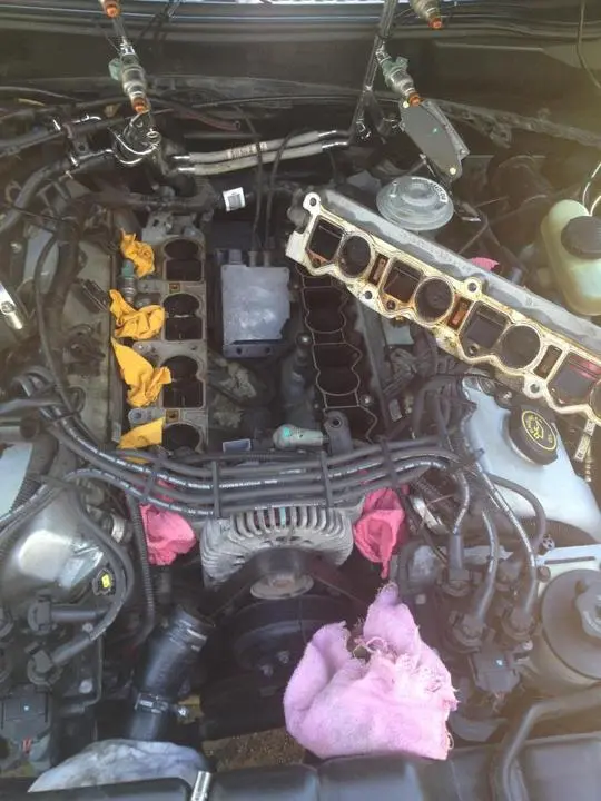

On a side note I just got an IMRC code so that will be the first thing I need to do before installing mods, it's a never ending battle.
Wow man, those seats are in gooood condition. I bet it was a wee bit of dough for those. Back seats as well? Those tail lights are pretty sweet too.

Nice score on the seats - my suggestion to bring those things back to life is to go to Autozone or any other auto retailer and pick up some of Lexol's Cleaner and Conditioner - I use the cleaner with a light brush and wipe away all the old dirt - then put the conditioner on good and heavy, let it sit and wipe off the excess. Depending on how dry they are - you could condition them more than once, then just keep it up once a month. I have a 2003 and the leather is still like new. Again - nice find on both items!

I was very happy to find these seats in the condition they are. I drove up from San Antonio to near Denton and back in the same day to get them even. They were $1K which I was very happy to find for that kind of a deal and yes they included the rear seats as well.

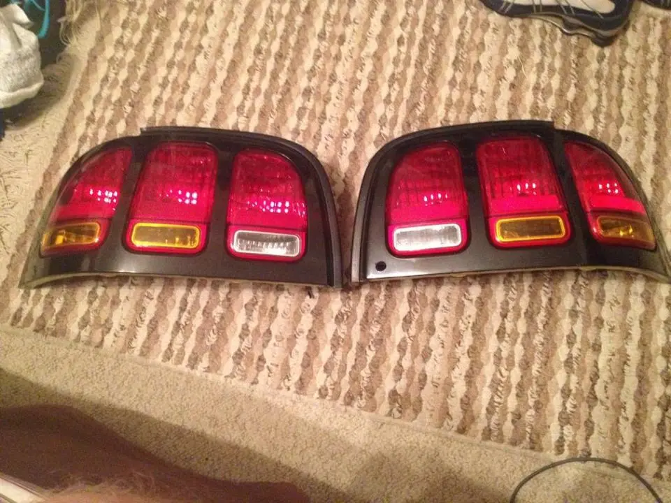

The taillights are more of a rarity being they were only on the 96-98 cars that were exported outside the US. I had the car running (or what I thought was running good) but I just got a CEL for the IMRC's so I am in the process of pulling the top of the intake off and cleaning those.

The leather I have that cleaning under control its the suede I am a bit more worried about. They have a very light hint of brown which I will need to clean and get them to looking like they rolled off the floor nearly 10 years ago.
light soap and warm water - using rag in a light swirl motion should help. Make sure you only have the rag damp, don't want to soak the seats. If you can clean them, then leave them in the sun - then clean them again - you should be in great shape. I'd just make sure to do it in small steps. It's not an actual suede, it's a synthetic suede - so it is not AS particular as real suede would be. G'luck.

Seems like I cannot get ahead of this car and some bugs. After getting the IMRC's taken care of I swapped in the 03-04 seats and I really started to enjoy the car again. Went ahead and purchased subframe connectors and was just about ready to get them put on along with the HID's I picked up and some window tint redone until I blew a plug out of the passenger side head. I knew she was hurting and I don't have the knowledge on this level to diagnose/repair so I sent it to a local shop. They proceeded to do a compression and then leakdown test to reveal 0 compression in the #4 cylinder passenger side and 60% leakage as well.
So it's rebuild time of at least the heads and from what the general rule is I will need to get the shortblock done as well. Sounds like it is on to build time!
