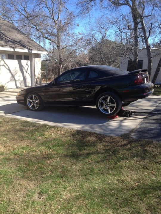

Apparently my car loves to be on jackstands:

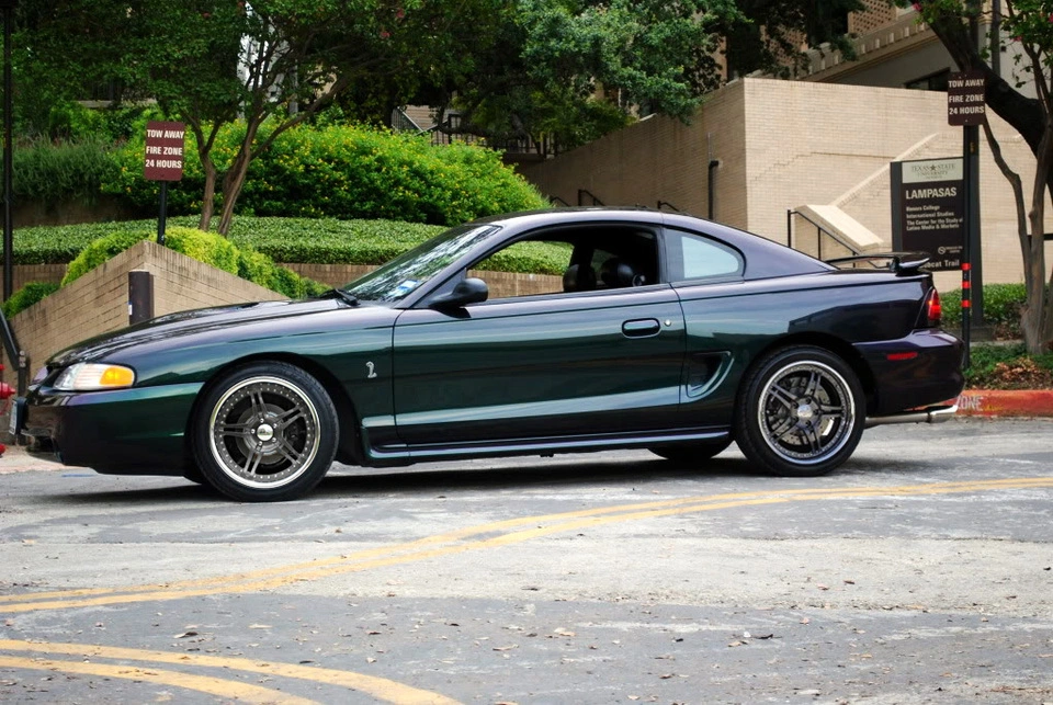

Vote for your favorite finish on the wheels, First is a double brushed with polished lip and its shown with rivets and the 2nd is a fully polished setup. Let's hear opinions!
Thinking polished as well. And if you can get away with it...the red calipers to go along with it
Too late on that front haha. I got them powdercoated black with the cobra polished and the front brackets in silver. I think there is a picture on pg 4 of this thread of the brakes that is.
