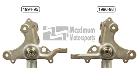

Here is some info on front end (spindles) geometry differences over the years. Moderator Mike (Mustang5L5) actually came up with this info, so blame him, not me. :D
Maximum Motorsports said:
Do not install a 1996-04 spindle on a 1979-93 or 1994-95 Mustang fitted with a stock-geometry k-member!​
Doing so will significantly increase bumpsteer because...​
* The steering arm on the 1996-04 spindle is about 1.02" (26mm) lower (relative to the rest of the spindle) than the steering arm of any 1979-95 spindle.​
* The lower steering arm forces the outer tie-rod end to a lower position.​
* That new position is far too low for the steering rack location of any 1979-95 Mustang, and radically changes the steering geometry.​
* It is impossible to correct the geometry with a bumpsteer kit because the outer tie-rod end needs to be raised so much that it would have to occupy the same physical space as the steering arm.​
Having said that, there ARE people who get the '96+ spindles to work with the stock K member. I can't really add anything about that from personal experience, because I've never driven a Fox car with stock K member and '96+ spindles.

Visuals:
