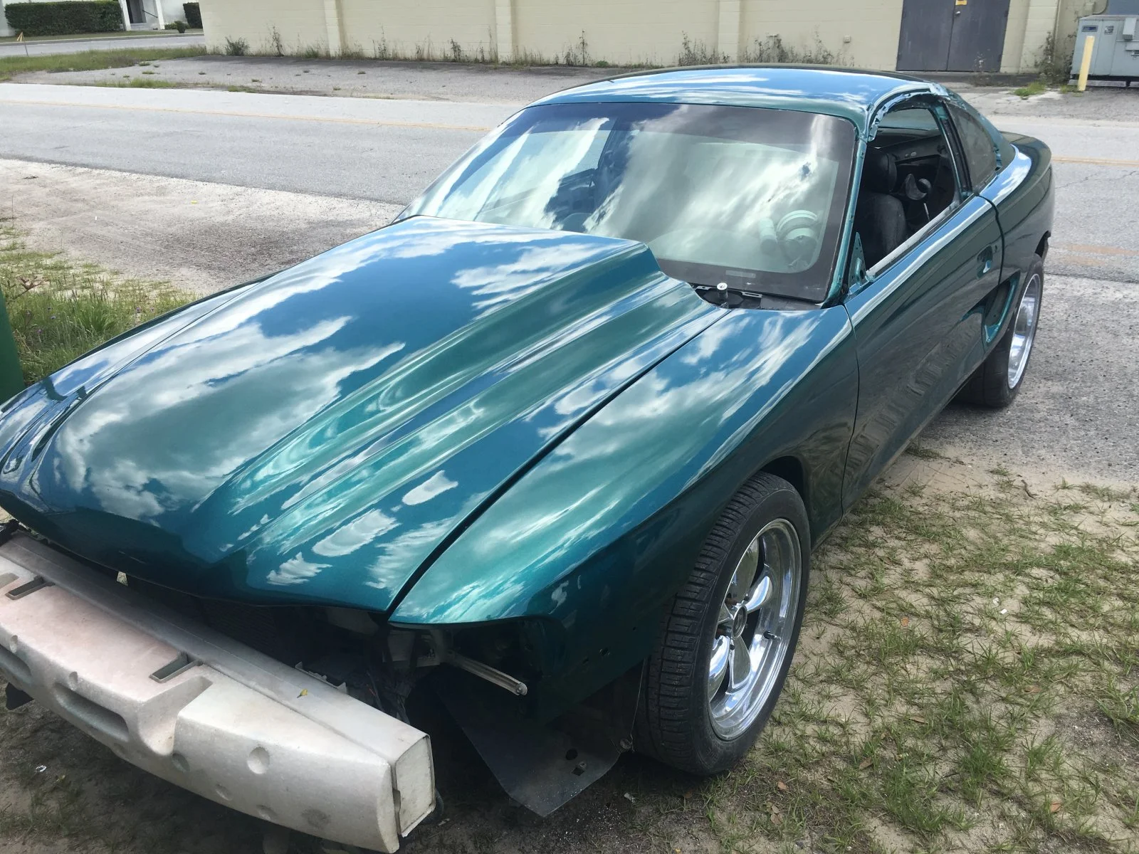

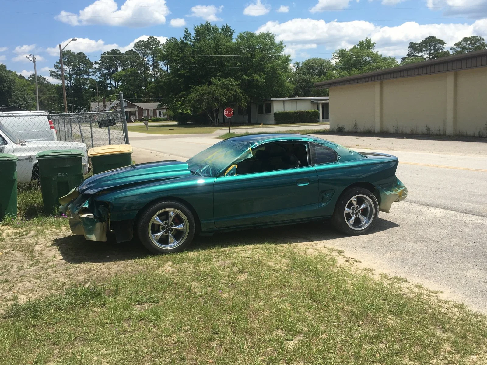

Well the 96 had a date with a deer while going down a country road, so that car is no more. Was quite a bummer.

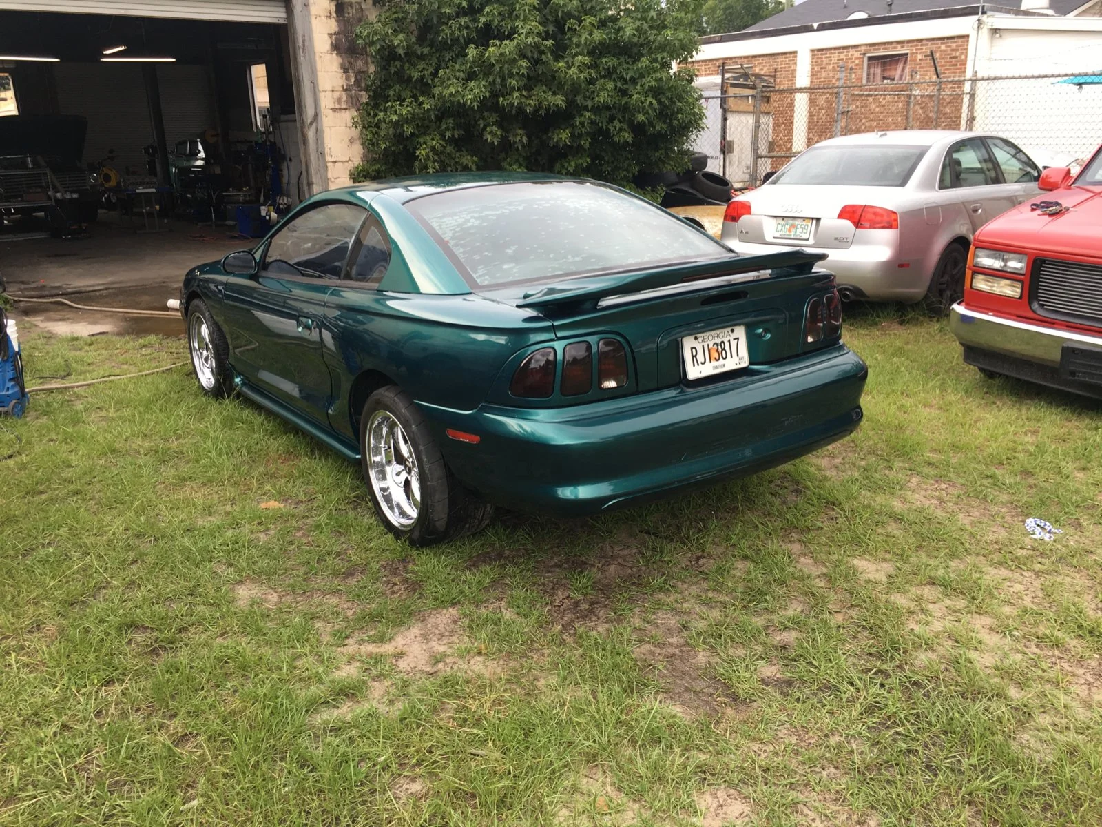

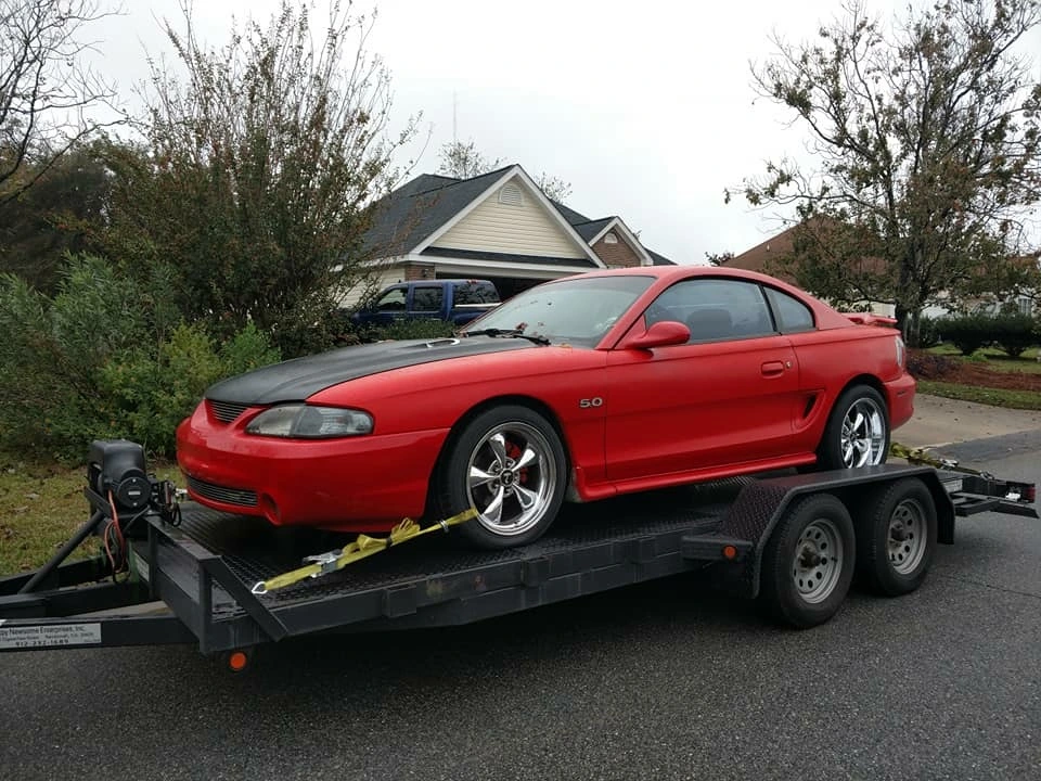

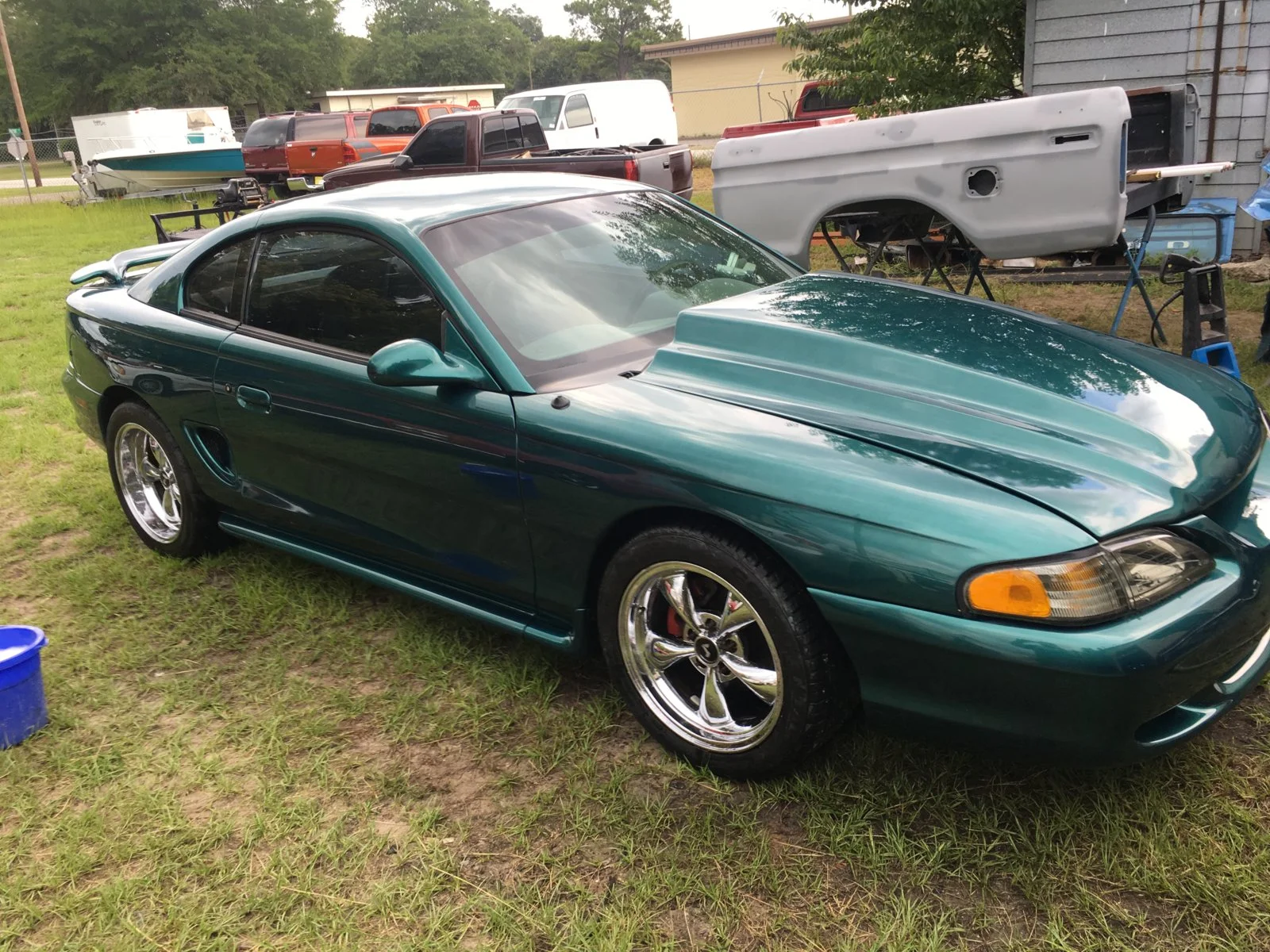

So I picked up this and built it.
Got the car for $2500 running and driving. Test drove it and it wheel hopped like a sonofabitch. Got it on the lift and discovered the lca’s were both sheared clean off. Never seen that before.

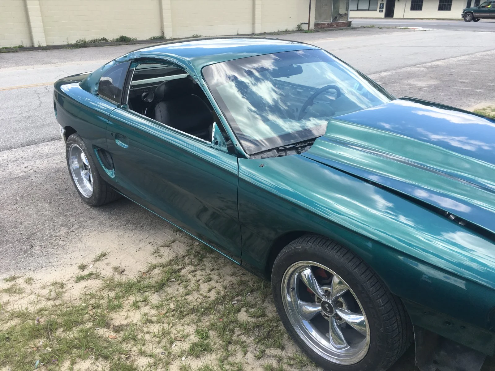

I transferred over all the guts out of the old car into the new one. The orange had to go.

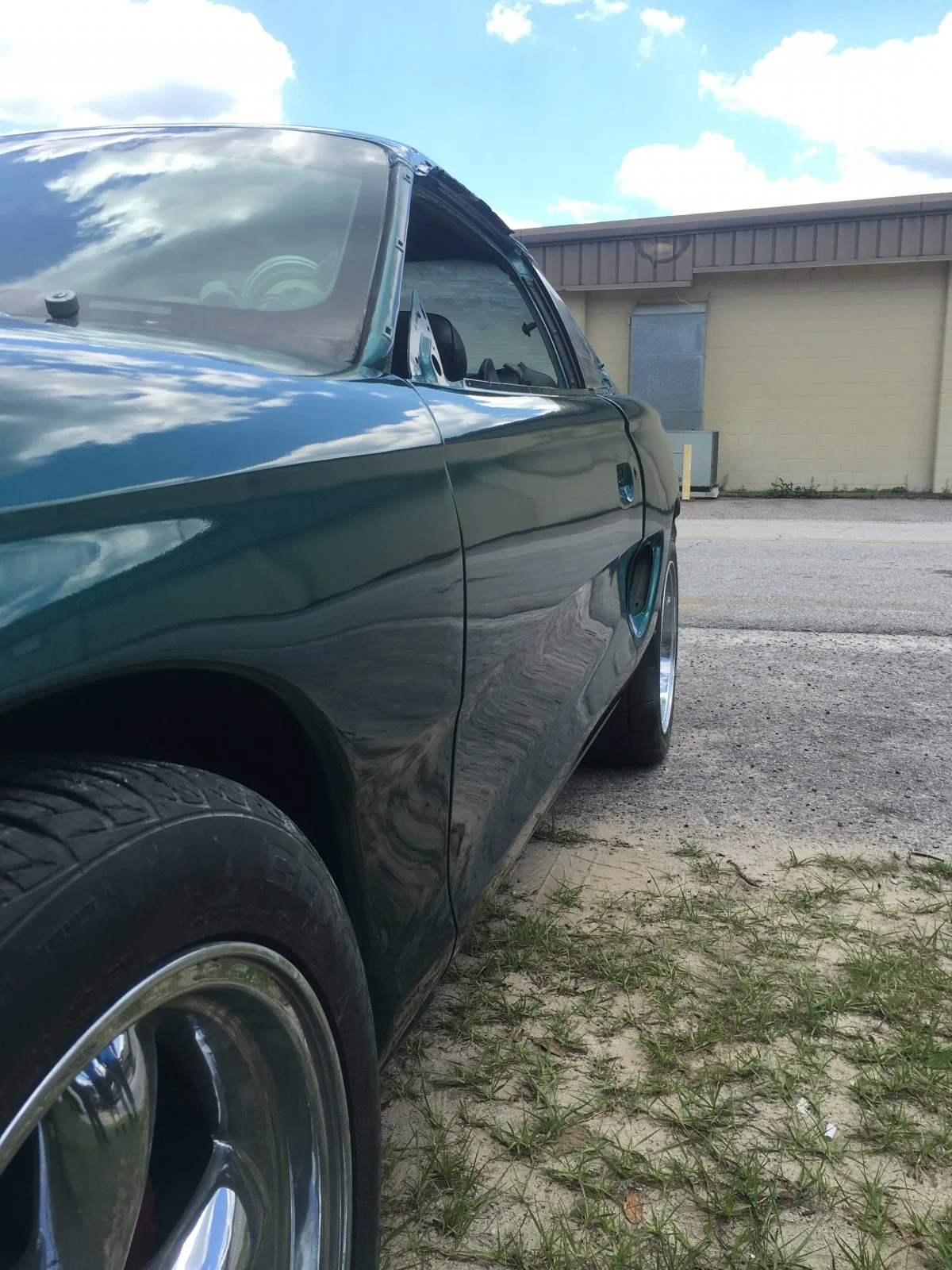

Thanks Dave, the official color is “dark teal metallic” and it’s looking great so far.

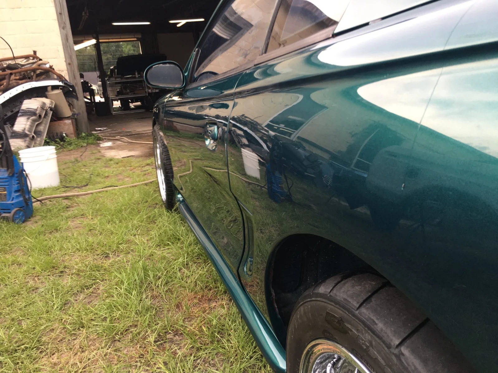

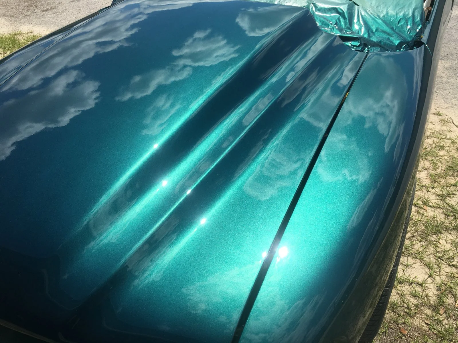

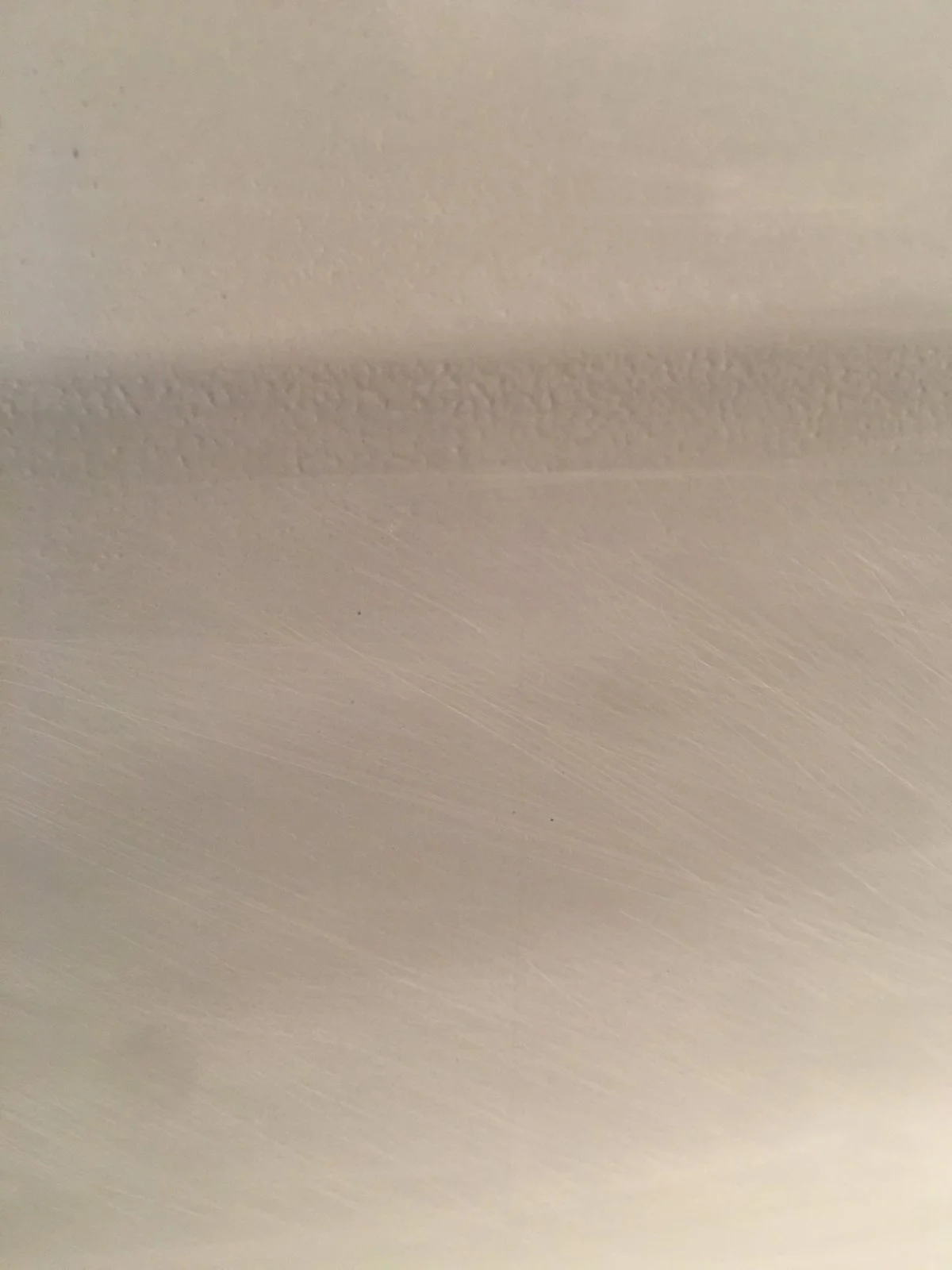

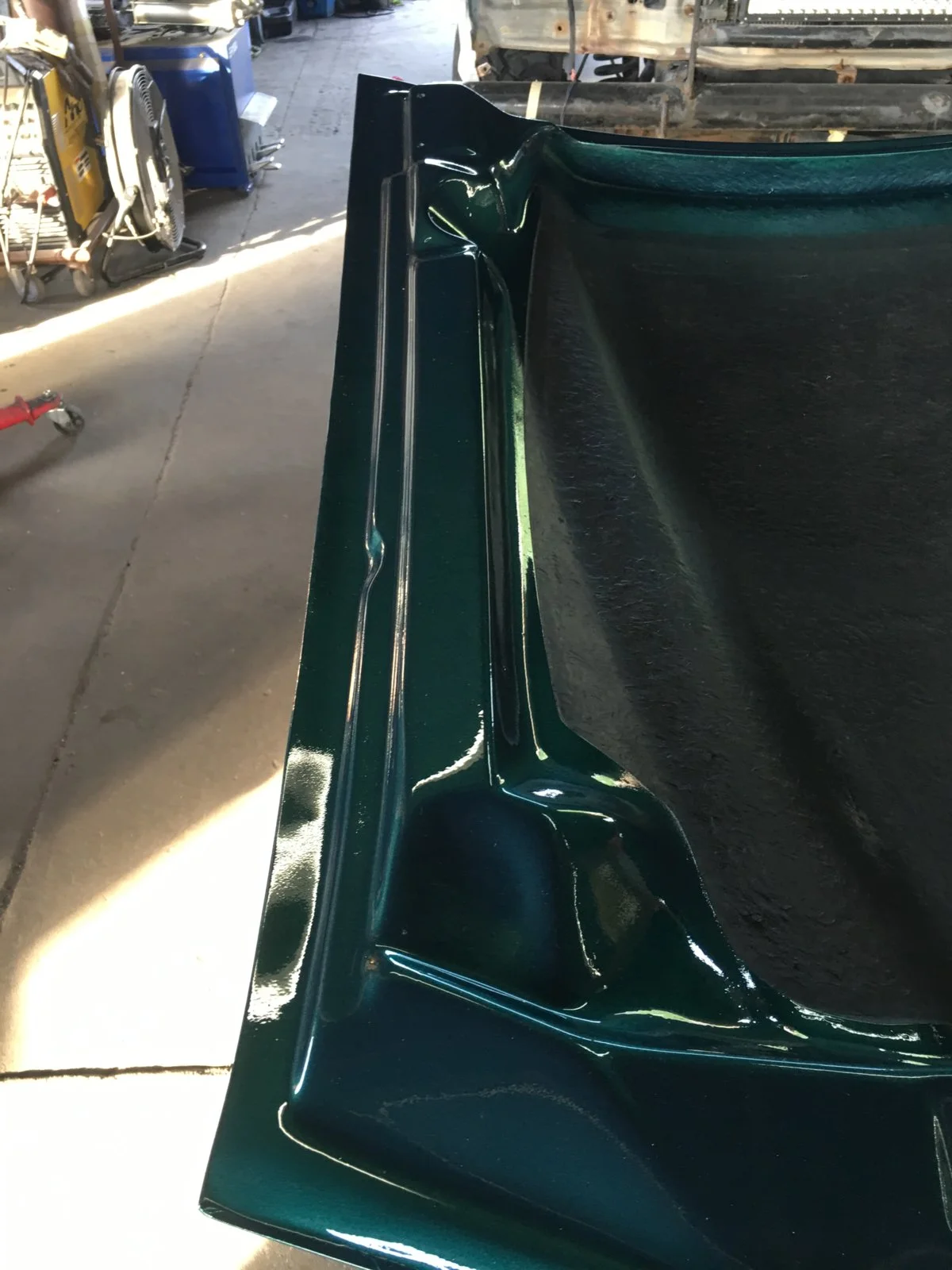

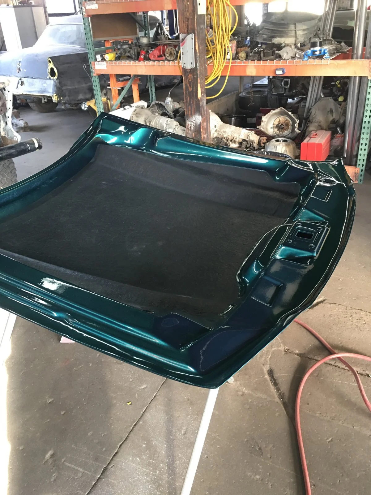

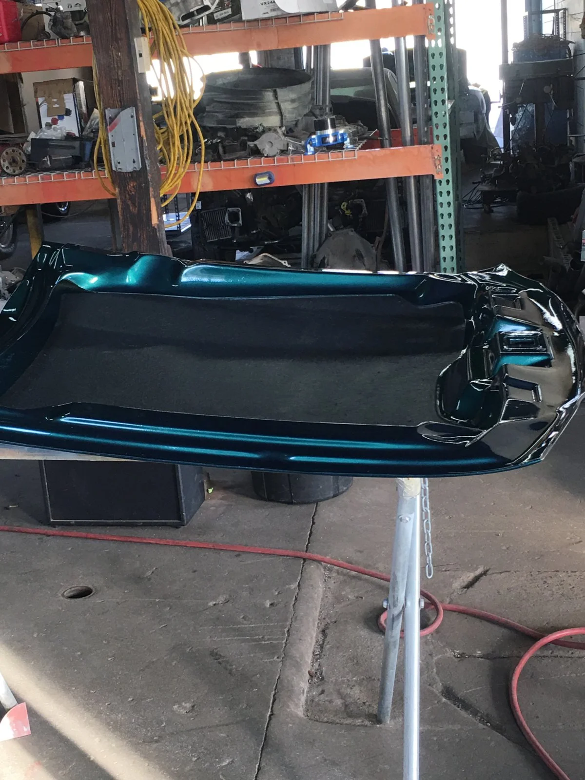

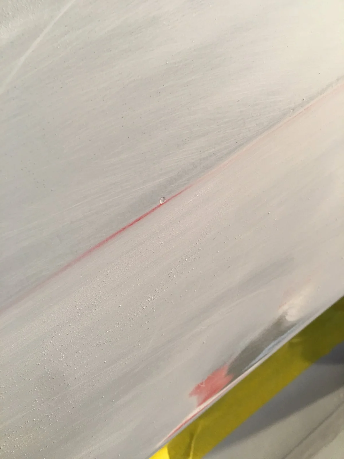

Man yesterday was kind of depressing. We have a body guy at the shop, and from what I heard he did good work. I threw him some money to break down the car and get it ready for paint. Well yesterday and Wednesday night I discovered his pisspoor workmanship. Yesterday’s paint day turned into blocking every bit of primer again and mudding a couple small low spots. Needless to say I was pretty pissed.
On top of all that he’s currently in jail. Jesus.
Was hoping to have the car ready for a show tomorrow, but those chances are looking slim now. We might be able to pull it off, if it can get sprayed tonight.
All right! Its all looking real good!
