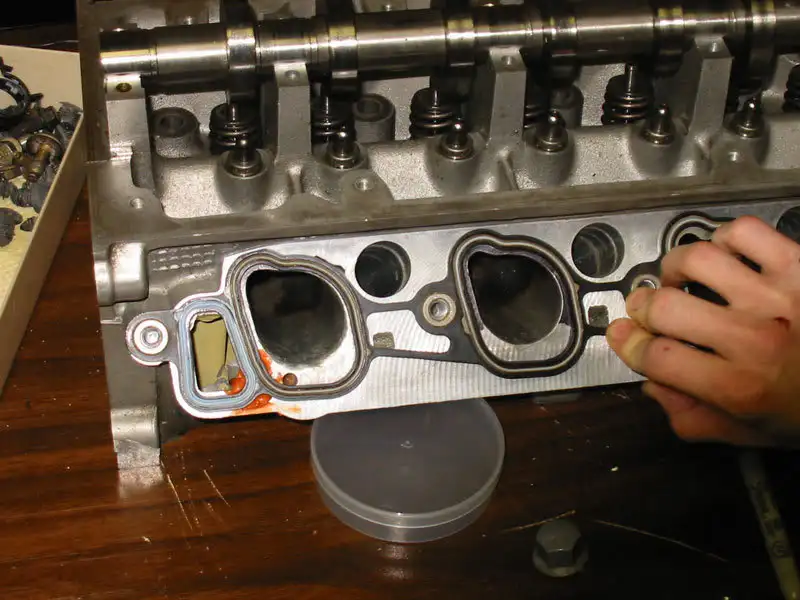

you do not need to run the adapter plates, all you have to do is put a little sealer on the rear on the drive side head, and on the front of the passenger side head.
heres a pic, hope it helps
Oh wow thats it!? well thank you i did not see that picture before ! my dad used to do that when he ran Cascar ! my only issue really is ive had a car where my grandpa put stop leak and he blew the motor because he put to much and it plugged the rad ! mind you he ran it even when it was steaming it was over heating so much !
