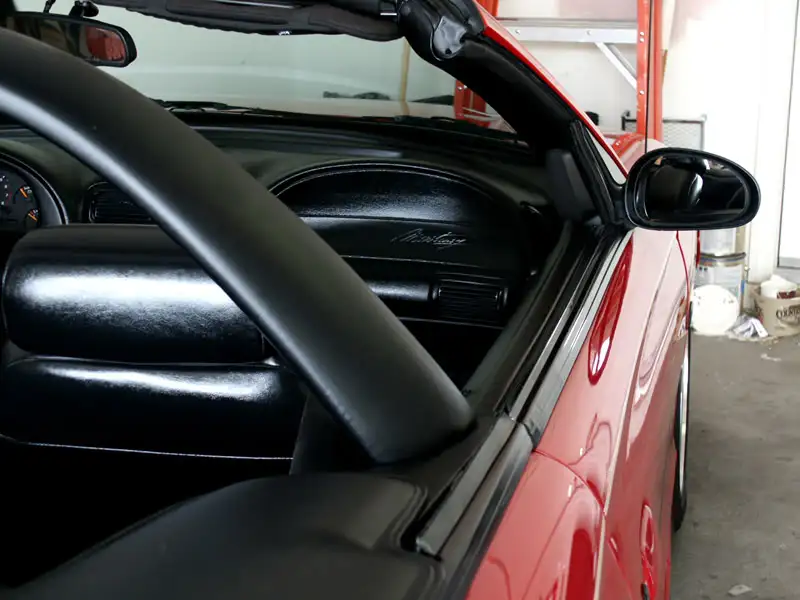

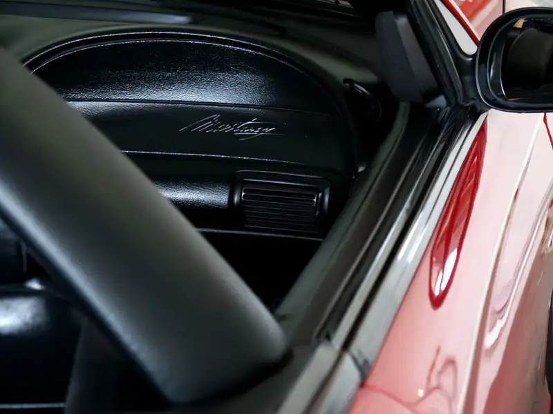

UDTBadkarma said:
...The only thing that looks better (interior wise) on the 96-98 stangs is the Black interiors on 96-98 GTs is actually black...not dark charcoal like the 99+ models.
Funny thing is... a couple years back a guy rear ended me and blew out my rear interior panels... After the insurance company paid for the shop to fix it and I picked it up, the first moment I was in the sun, with the top down, before I left the lot I noticed they had put in a charcoal panel along with a black one. At first the moron tried to pretend he couldn't tell the difference...
THIS... is black....
