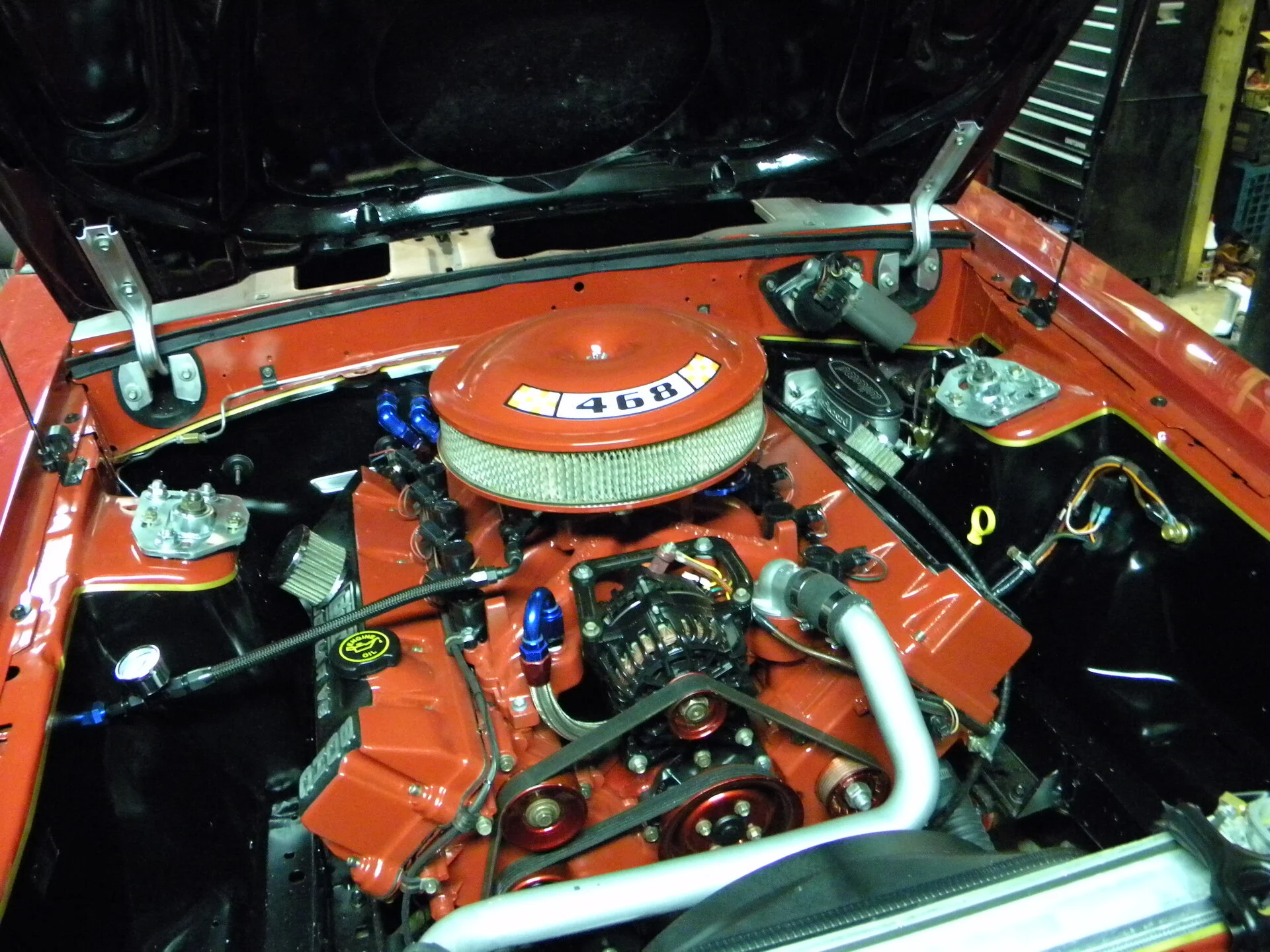

4.6 2v in a fox. Ported p.i. heads, stage 1 cams, Edelbrock induction, MSD timing computer. Tr3650 trans, 8.8 rear.
Manual brakes, Manual rack.
A Genuine pain in the dick to drive, and an even bigger one to stop.

So was it that bad putting the 4.6 in your Fox ???
Thx Dave
He don’t know me very well....he thinks I have passion for a 302 :rlaugh:
I chose to make my factory K member work. I heavily modified it to allow the engine to set lower, and cut it up for the clearance necessary for the headers. I relocated the rack lower by 3/4”.
There was bumpsteer. I had to correct that. I didnt wanna fck with the Pats system, so I ditched the factory ecu, and ran a carb. I used a msd timing controller to fire the coils. The fuel system was upgraded to provide a better supply.
It ran great from the jump. It didn’t make any real power, but was fun to drive. It got great gas mileage on the few drives I took it to,...but it wasn’t cheap, it took somebody with decent fab skills to make it fit, and even when it did, compromises to the braking and steering systems made it a “ less than” when compared to the stock systems that were already in place.
No offense but why does your steering and braking system suck ? Why do guys constantly "upgrade" to 5 lug wheels ,hubs, and brakes if it is less than stock. Did you cut corners on your braking system ? I don't understand how it could be less than stock ? Why was the power less than stellar ? Was it because you deleted the fuel injection ? Thx Dave
