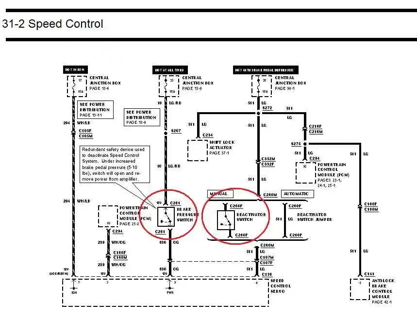

I have two connectors above the driver's footwell jumpered. According to my 99 mustang service manual (on CD), one is called the "deactivator switch" and the other is called the "brake pressure switch" (see my attachment). With these connectors jumpered, my cruise is working. Both need to be jumpered for the cruise to work.
I want to buy and install the switches that I have jumpered. Nancygrl identified a "cruise deactivation switch" (motorcraft PN: SW5954). From pictures of SW5954, it looks like it mates with connector C261 in my attachment. If it mates with C261, my manual is calling it the "brake pressure switch". Nancygrl said that it attached to the brake pedal.

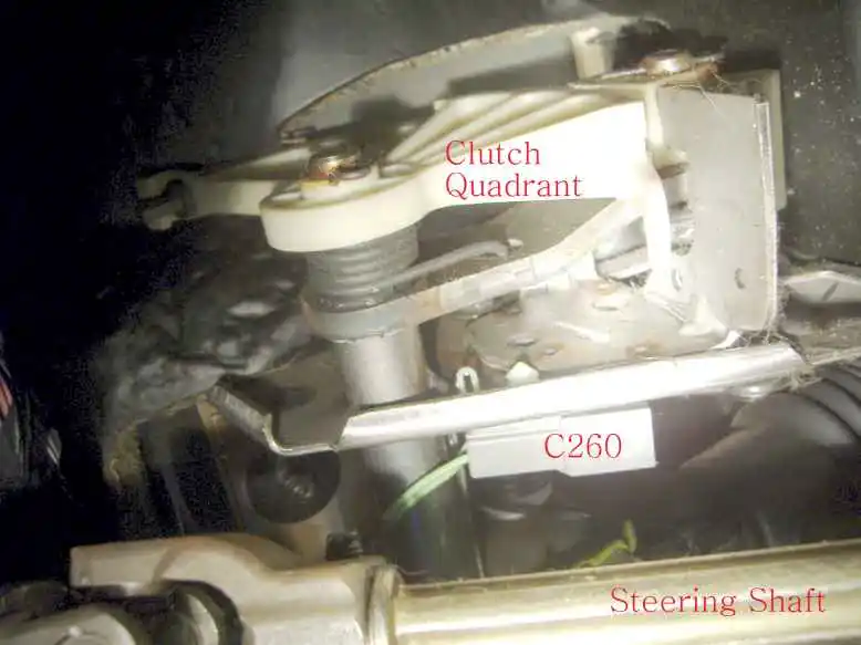

The other switch attaches to connector C260. My manual calls it the "deactivator switch". I assume that it connects to the clutch pedal since the auto trans has a jumper from the factory. I can't find any info on this switch. It plugs into a gray connector with two light green wires. The connector is mounted above the steering shaft, near the clutch quadrant (see picture attachment). Would a kind soul show me a picture, describe it, or give me a PN?

I have a 2000 GT manual transmission with cruise control. It should be close enough for what you want to do. I have a few pictures (hard to take pictures in this area). PM your email address and I will send. These pictures are too large to post.

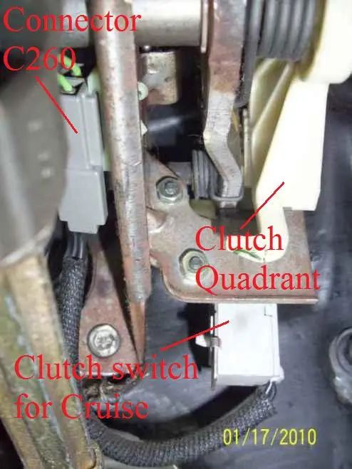

My install was/is for an automatic transmission. Yours is for a manual. I know on my 2000 escort ZX2 that's a 5spd there are 2 switches, one for the brake pedal and one for the clutch pedal. Here is a picture of the deactivation switch. It may or may not be the same for a manual 'stang. I got mine from my local Ford dealer....You might want to check with your Ford parts guys as to which switch(s) you need. This is the switch I installed.
Thanks to wmburns for providing a picture of the clutch switch for the cruise control. I can probably take this info to the parts guy at the Ford dealership and get one. I'll post back a switch PN if I find it.

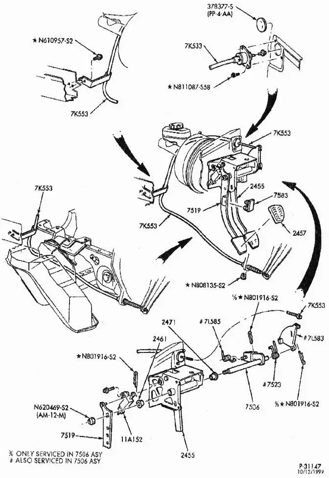

No luck on sourcing a clutch switch. I called two dealerships and neither could find it. One of them sent me this parts diagram and the switch I need isn't there. I think that I'll just make one since I know how it's supposed to work.
