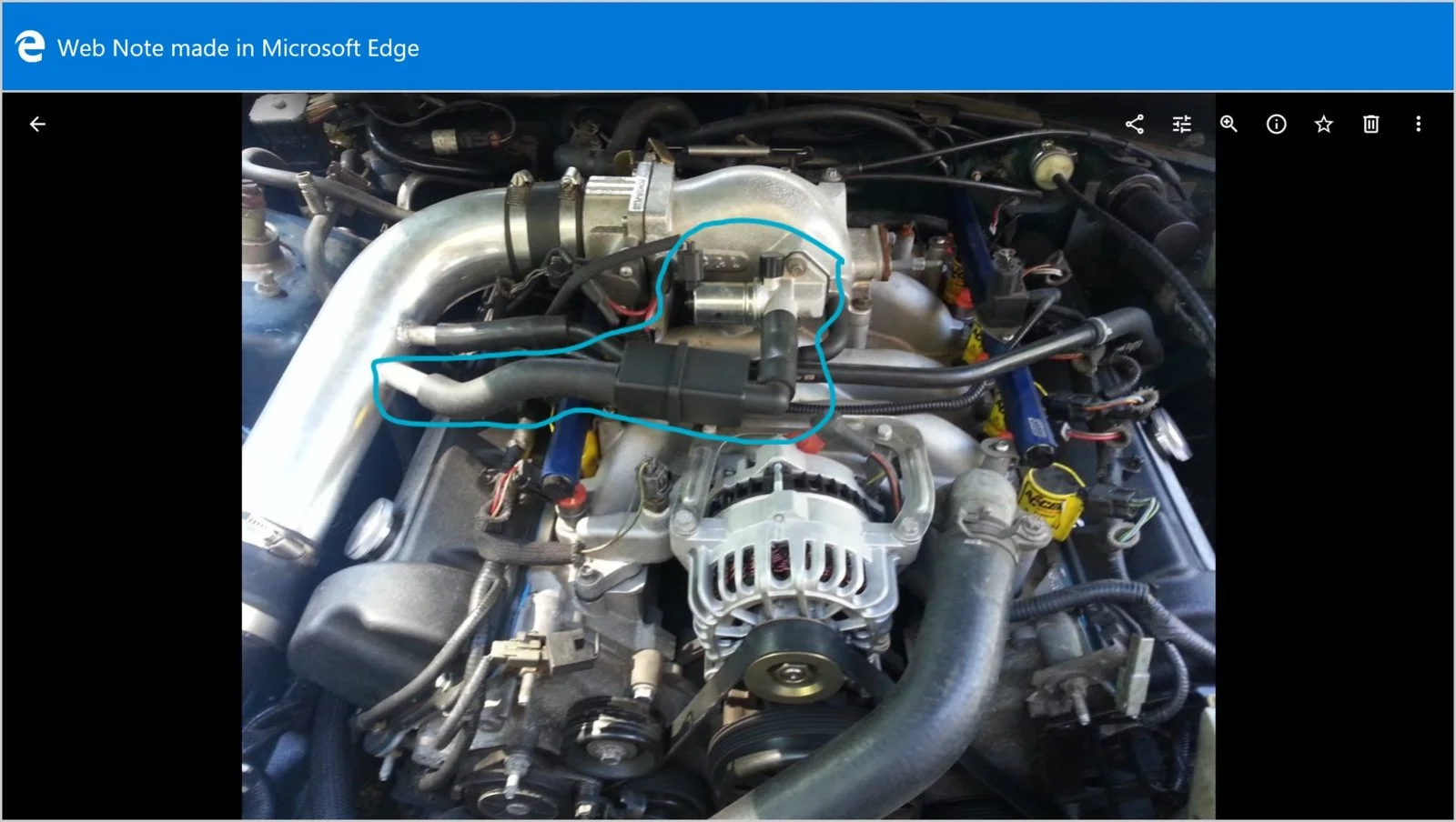

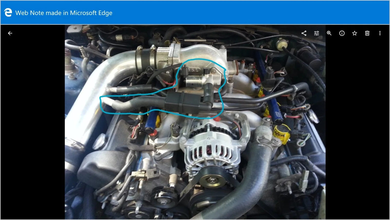

So last night I was playing with my IAB with the car running and noticed when I unplugged it during idle my rpms were more consistent and it idle'd exactly how it should.
^^^This all but proves that the idle stop screw is set too high or there's un-metered air entering the intake.

Update! My MAF sensor had a piece missing off of it after I replaced it with a bama one. I can almost bet it came like that when I ordered it from American muscle. After installing it, I no longer have a high idle but it wont stay running due to it idling too low. I also have an error code 0122 low voltage on the tps. I'll be checking the voltage today and adjusting the TPS to see if I can get it to idle better. I may end up replacing the TPS again for good measure then re-adjust. I took video and pictures that I was going to post but at this point I'm fairly confident I can fix it since I know what I'm dealing with.

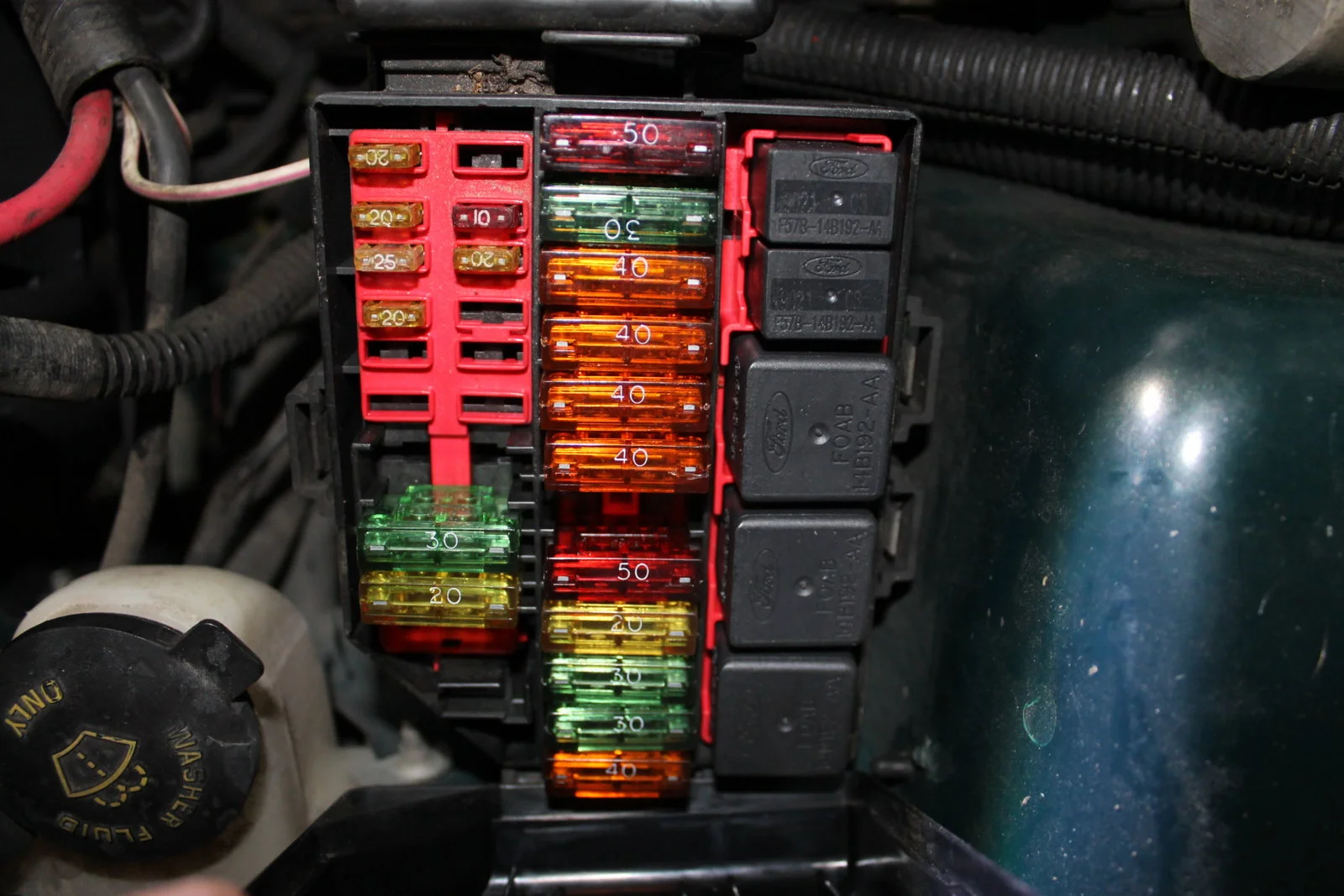

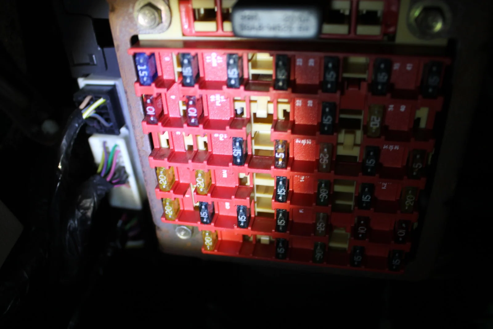

Got to test the continuity tonight from the IAC to the 21 pin connector on the PCM. I didn't know which input was the 21pin so I tested each one until I came across the 21pin connector sounding the solid alarm. Its getting 12 volts at the red wire and has good continuity to the 21 pin connector. Wanted to give an update on that. On a side not I tested the following fuses underneath my driver side dash panel and here is what I found.
F2.37 0 with or without fuse in with key turned on.
F2.34 1.0 Volt with Fuse in/-6.98 without fuse in with key turned on both times. The IAC has 12 volts with the fuse in and has 1.0 volt without the fuse.
F2.21 -.230 volts. I was completely confused on this.
F2.5 1.2 volts with fuse and -6.60 without fuse
F2.13 This was the fuse blown I found last night and replaced unrelated to problem I believe.
After re-connecting the PCM I had no check engine lights BUT now my odometer isn't displaying anything. Its in the dark when it was working before. I do remember earlier this year that dashes were being displayed and when I hit bumps or turned off the car and back on it would display the mileage. It started working just fine a few months ago. Not sure if this is related to anything.

Is there anything else I should check. Should I check the fuses in the engine compartment and which ones if I need to.
