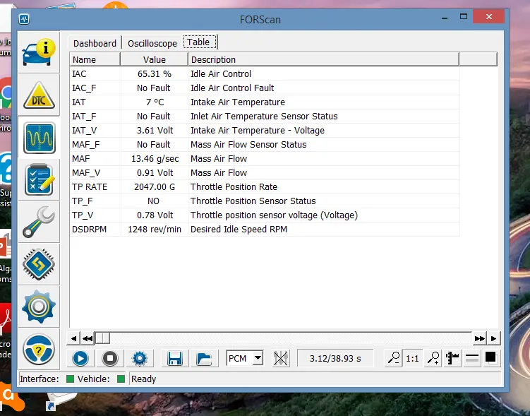

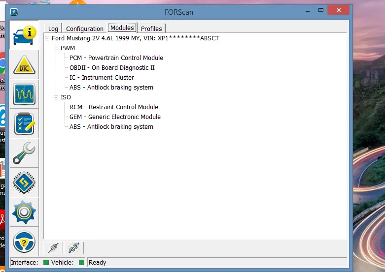

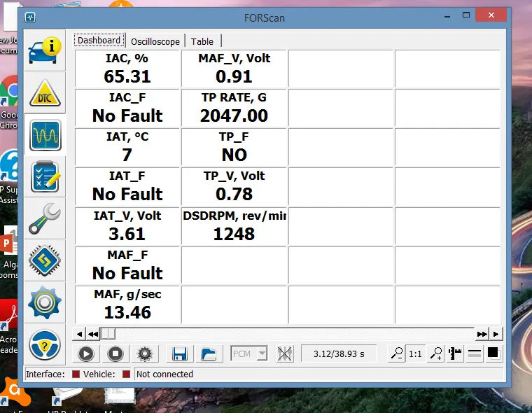

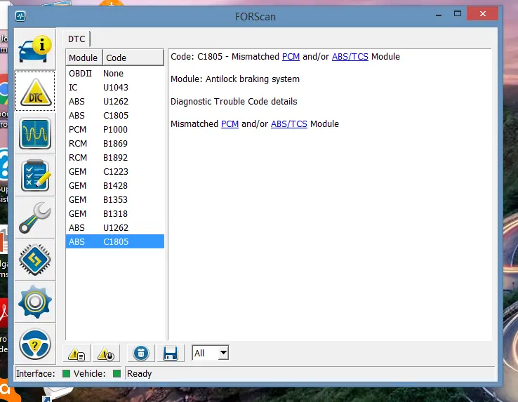

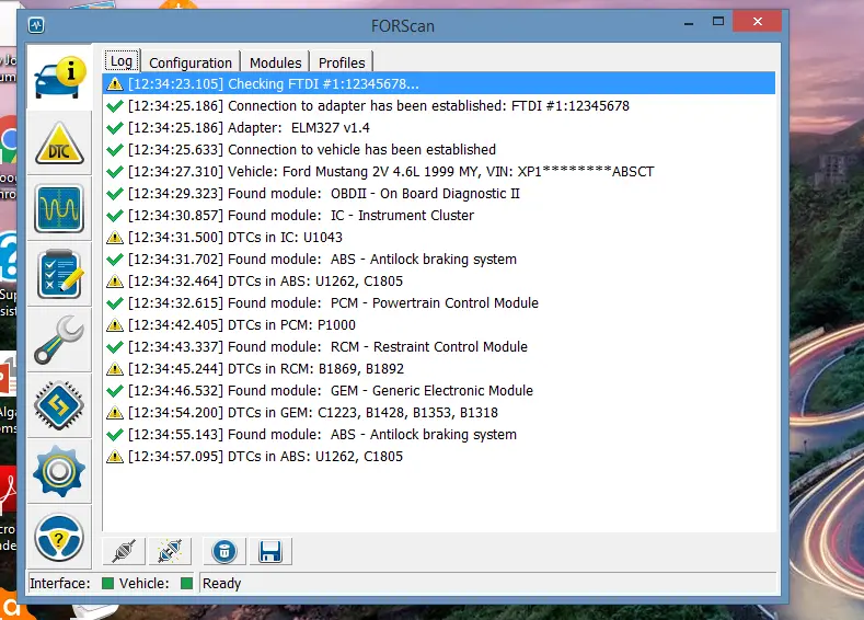

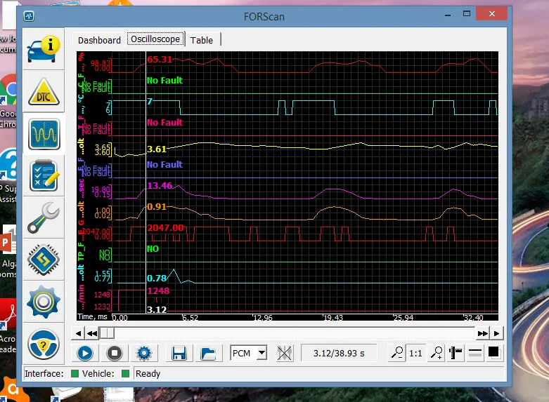

Attached are some of the files I ran during diagnostics on my mustang with the software you requested I buy. Let me know what you think might be the issue.
