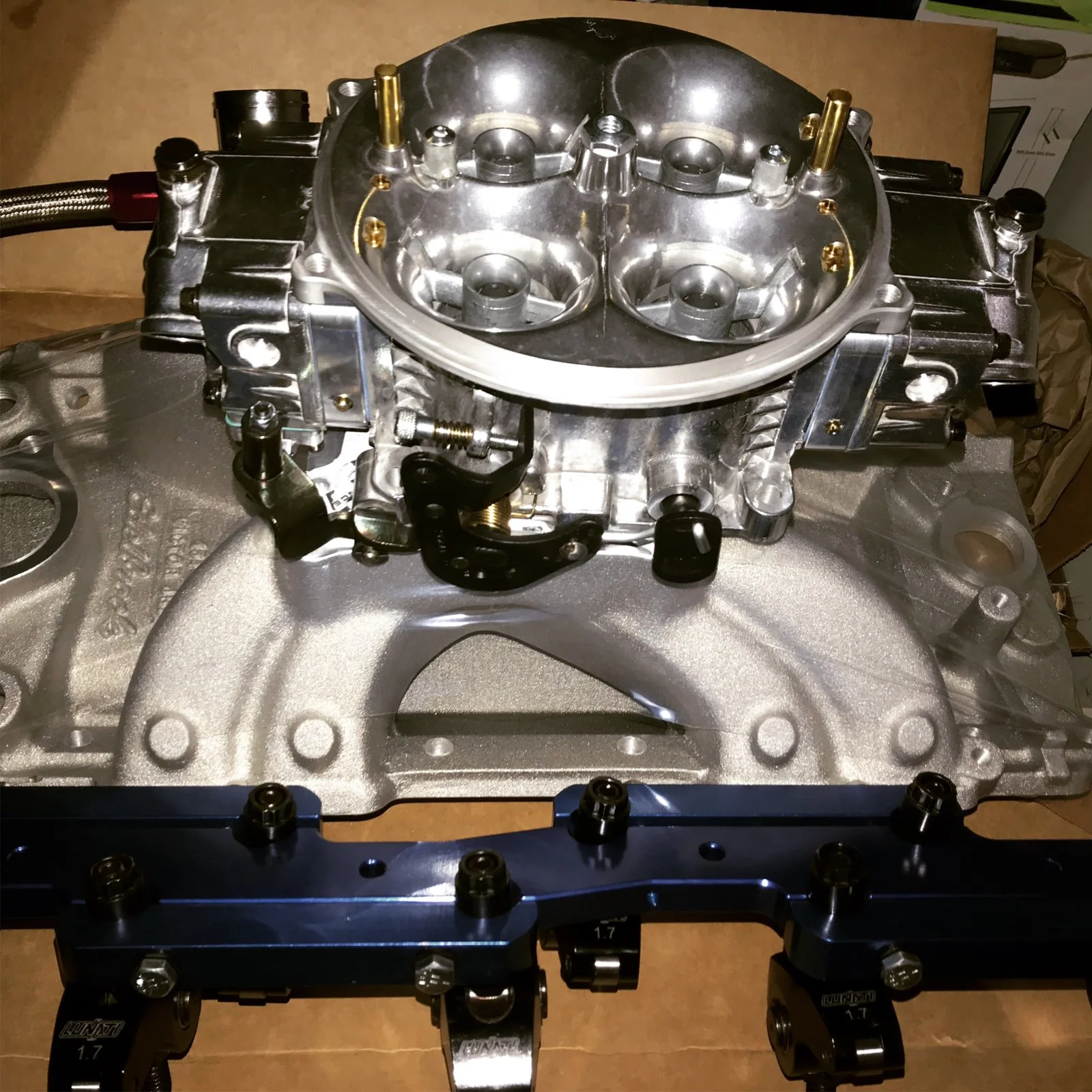

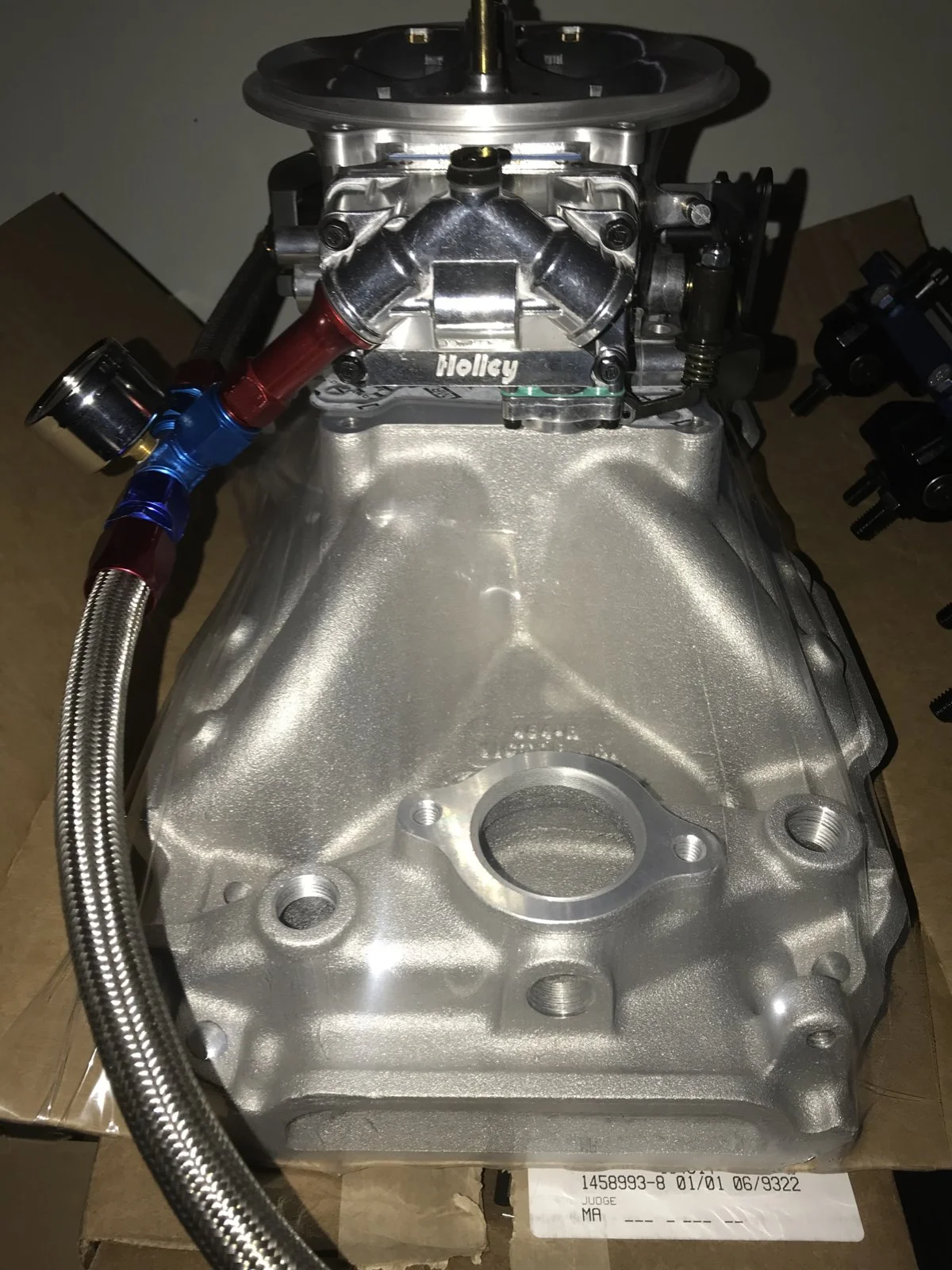

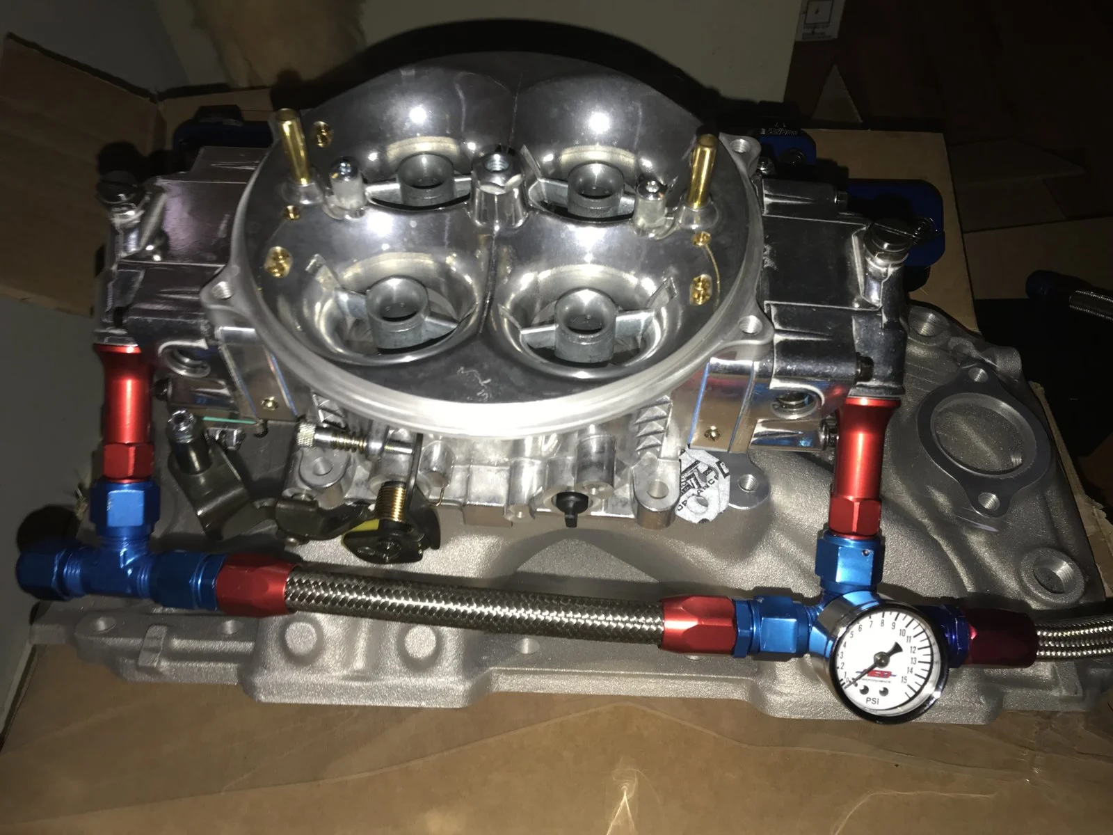

These pics are my own..
Stup girdles so pedestals won’t bend/break under spring pressure & higher ratio Lunati rockers for more lift once rings seat, note NOS bosses for drilling & tapping direct port NOS injection on all intake runners.
Carb height is about 5 inches above stock, will it & an air cleaner clear your existing hood?

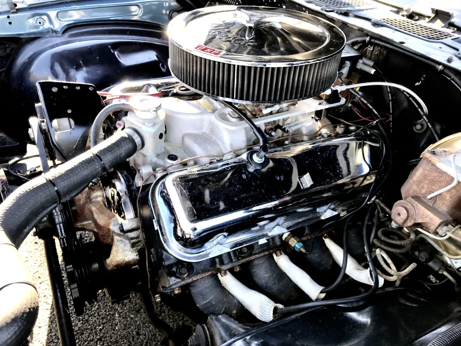

Not a Ford motor, but this 11:1 bored & stroked 454 (532) runs reworked Ford big block pistons. I’d rebuilt it, internally balanced/blueprinted, etc, street-able with a solid roller cam & still drives good on the street
