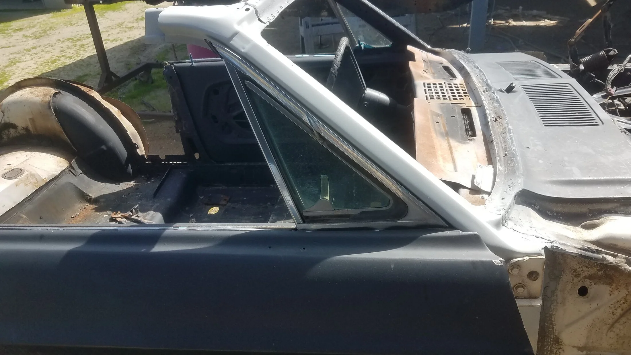

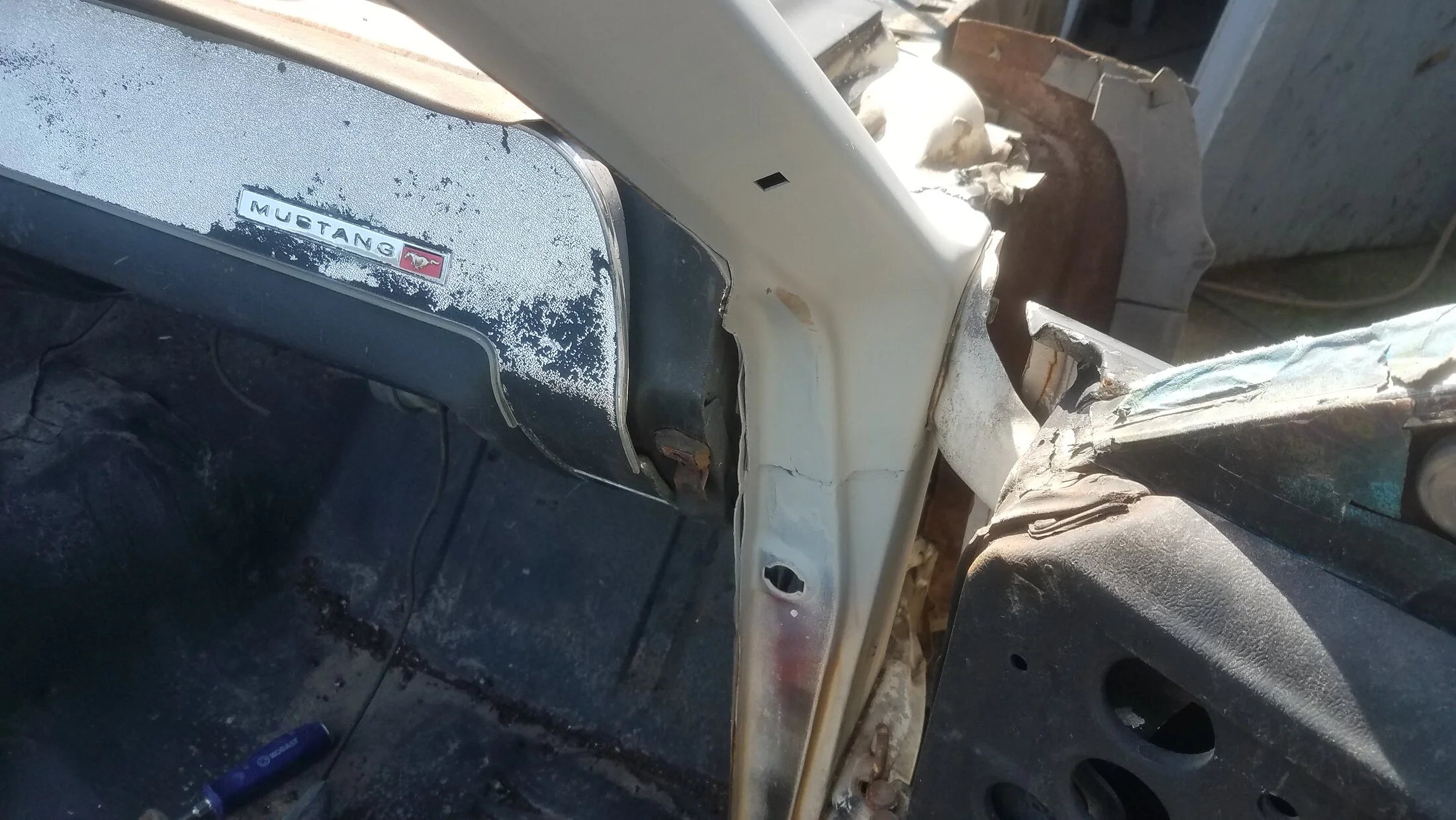

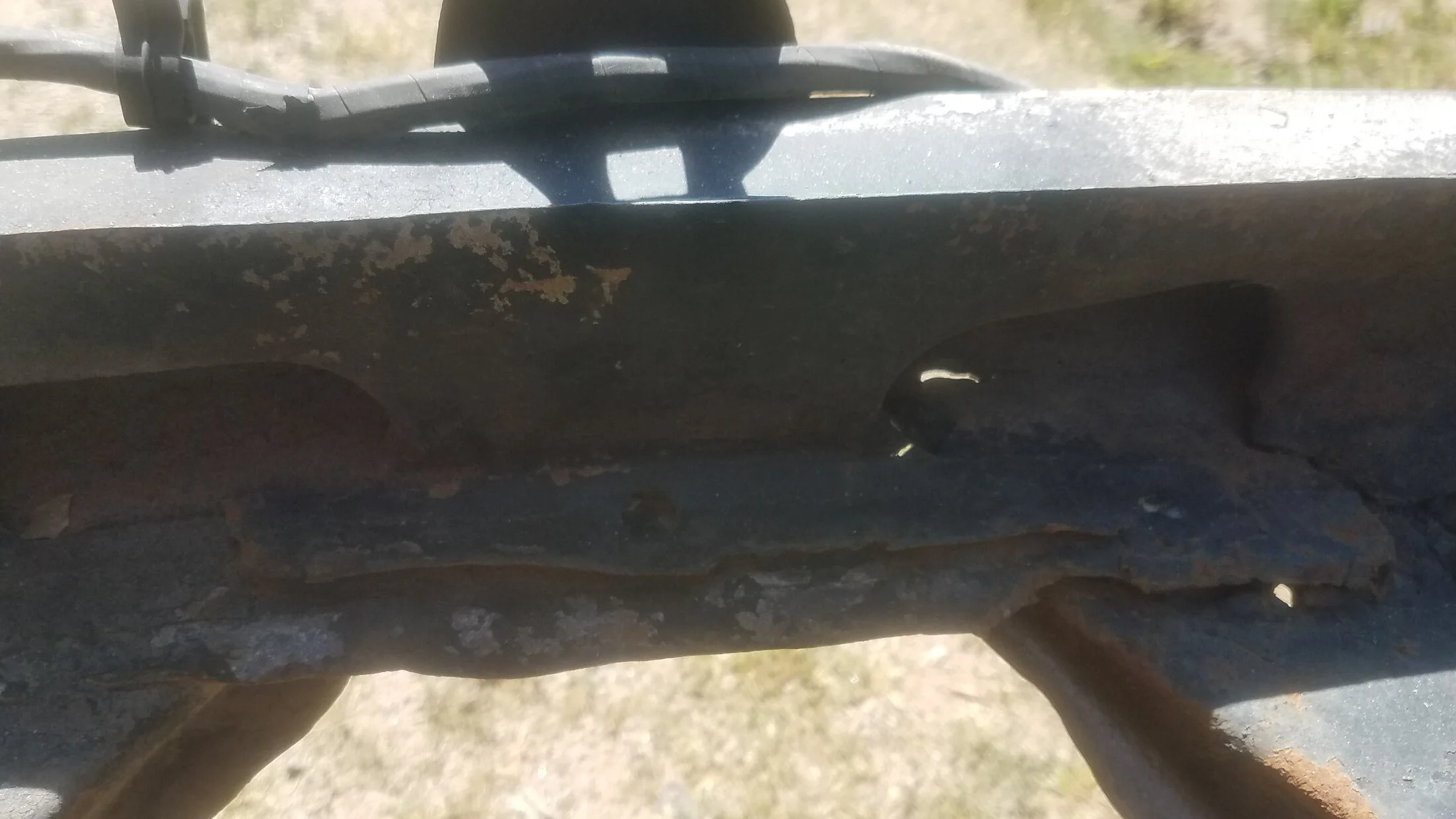

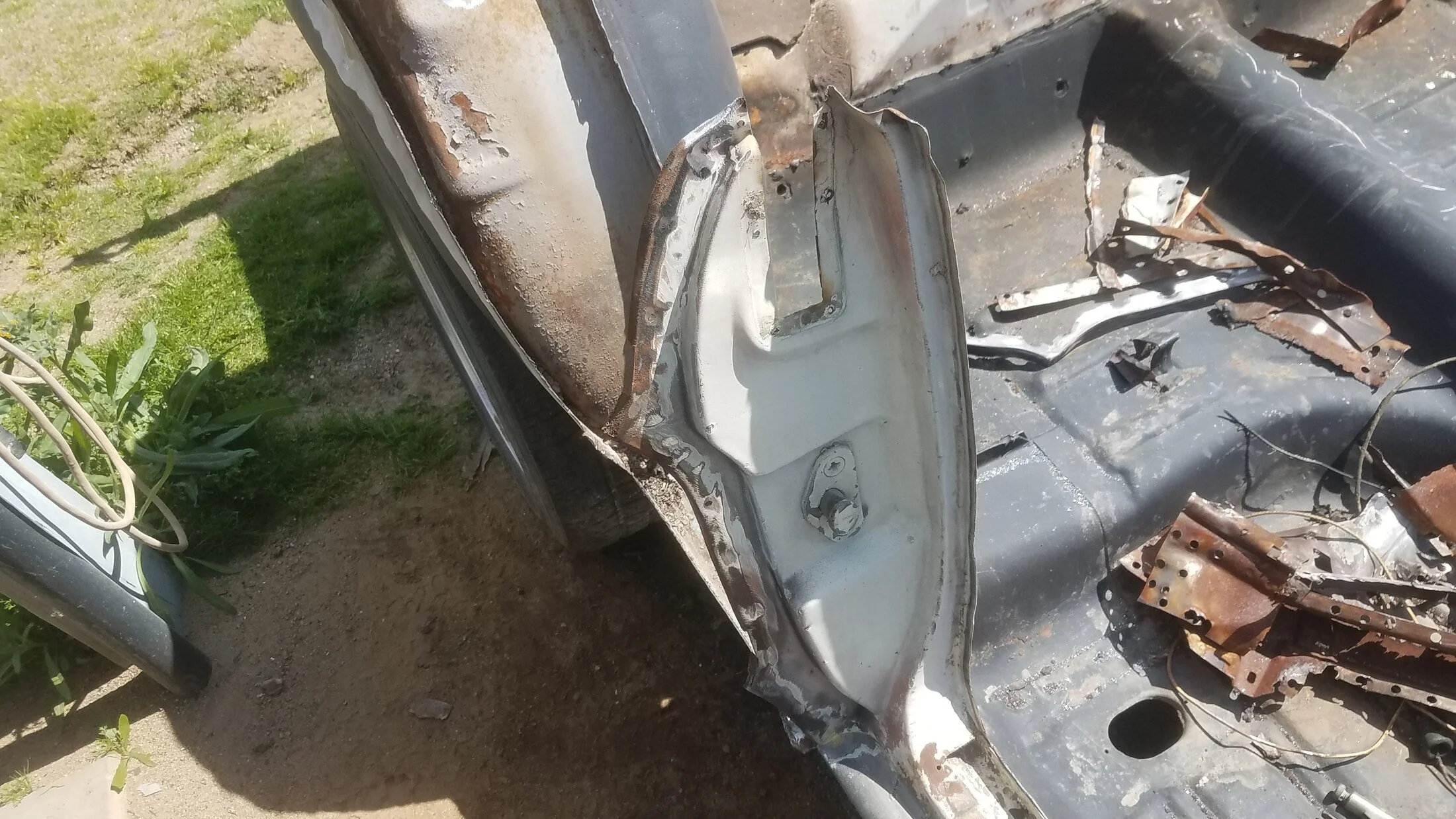

Outer door post replaced ,grind the welds and i can re mount the door.
The inner post was in great shape so i dont know what caused the outer to rust like it did .

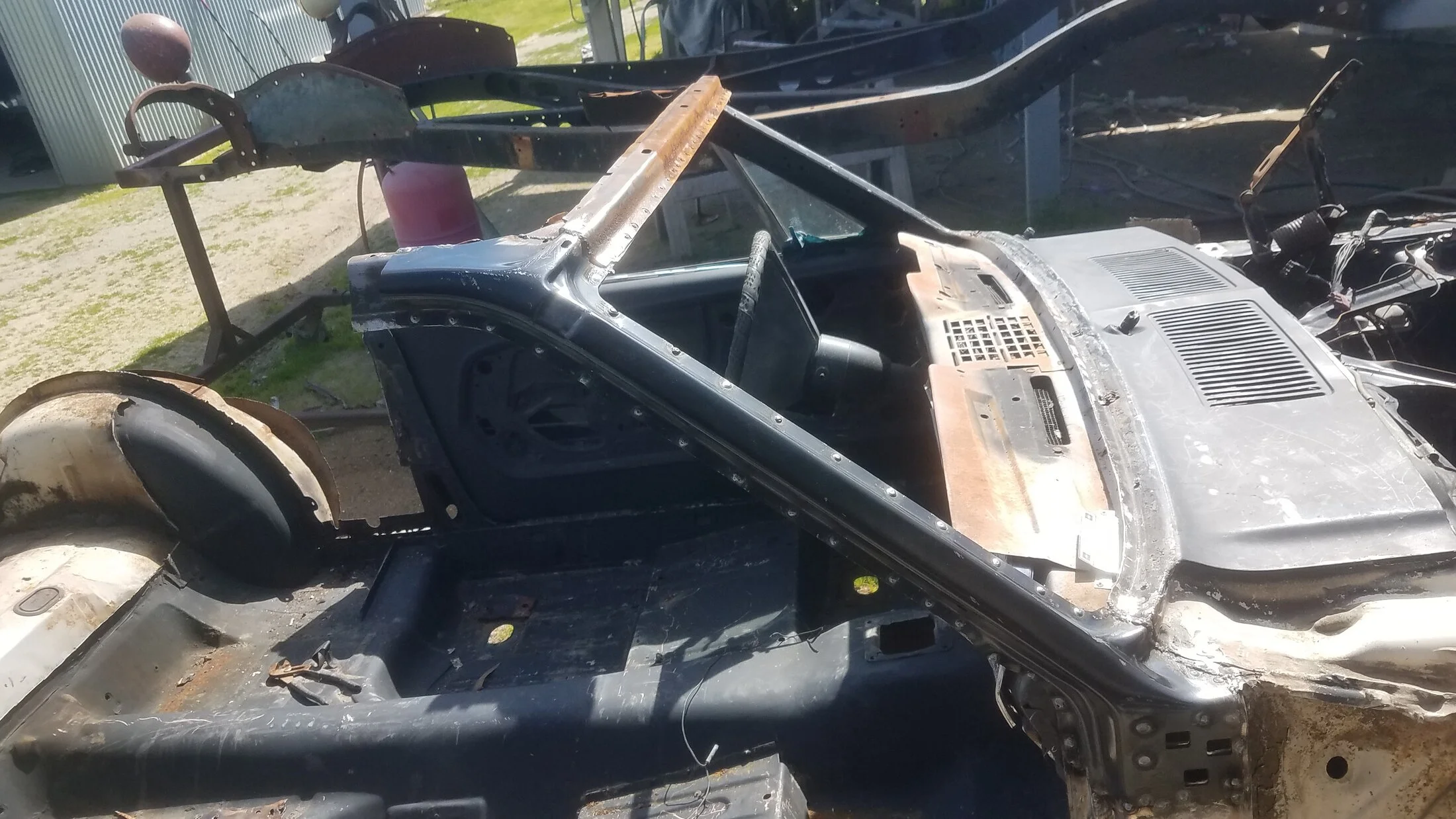

Welds ground ,i primerd the post ,cant see anymore holes its as good as new!

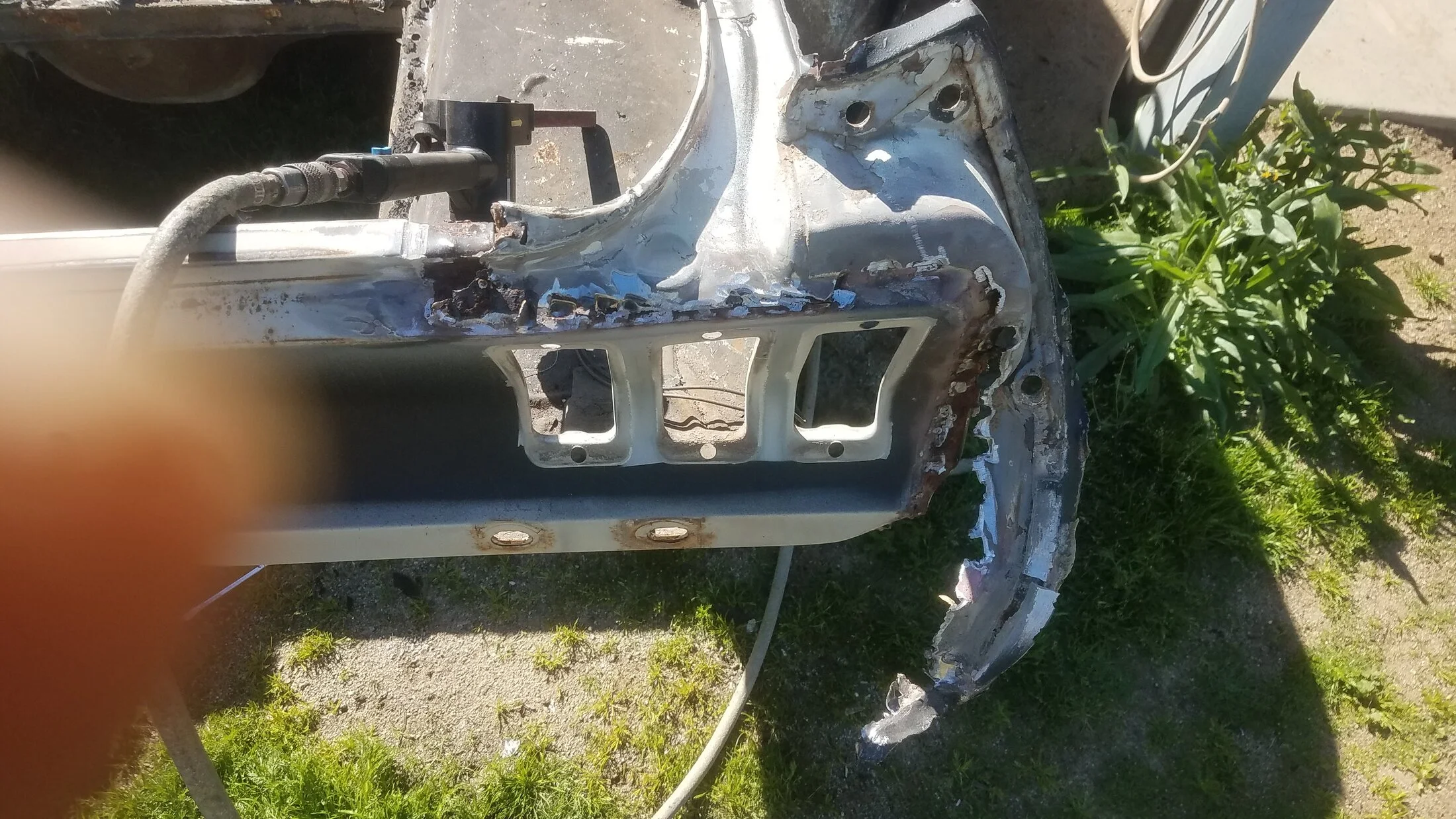

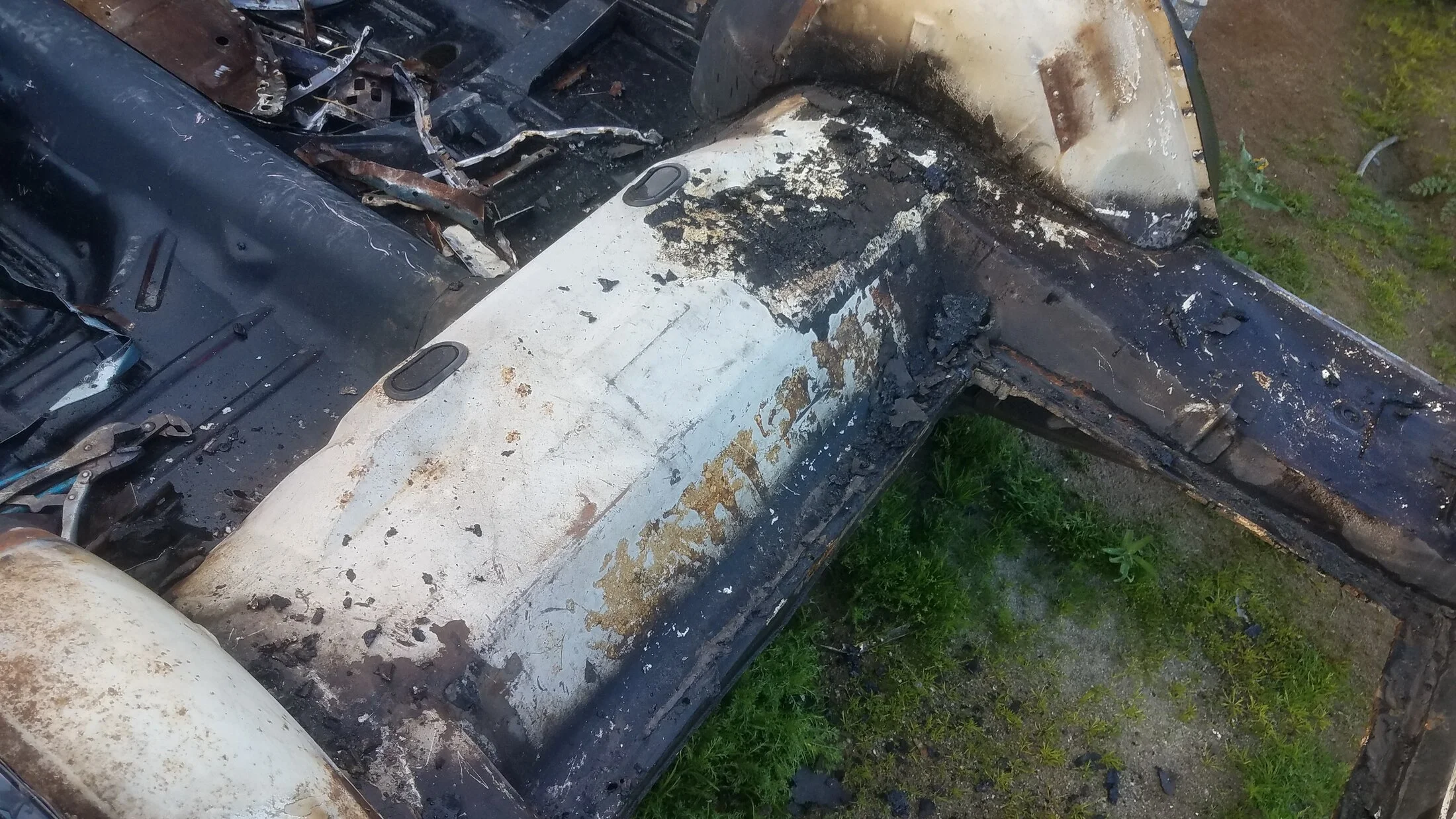

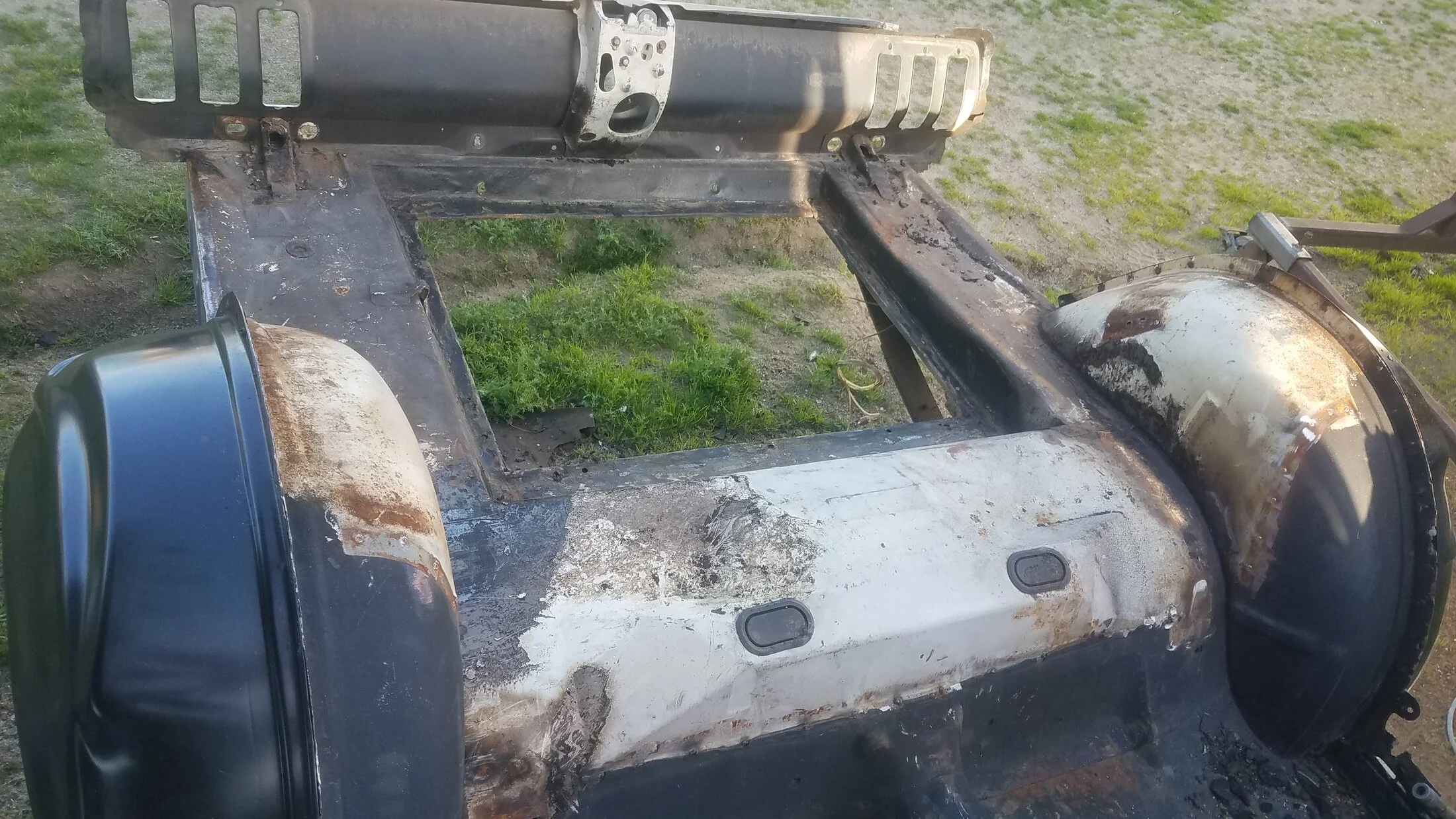

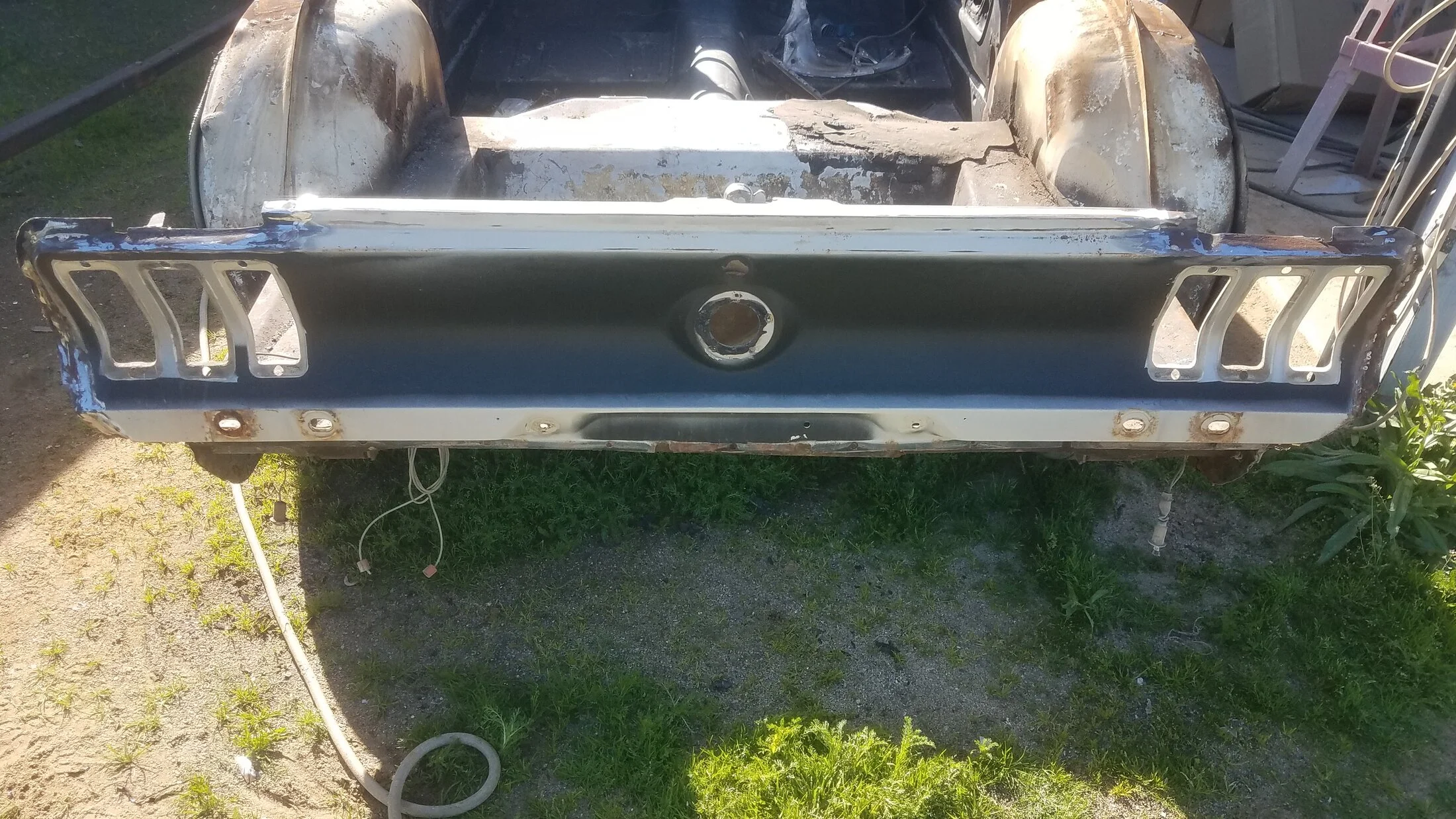

I wanted to have it all trimmed out today ,but the way they replaced the tail panel took me the rest of the day just to trim it out. They cut the old tail panel but left the tail panel flange around the quarters ends so all i could do was cut as close as i could and grind the rest away! The tail panel was still good so i didnt want to replace it if i didnt have to . I still have the wheel lips ,door jamb and the trunk drop offs to trim then i can blast .

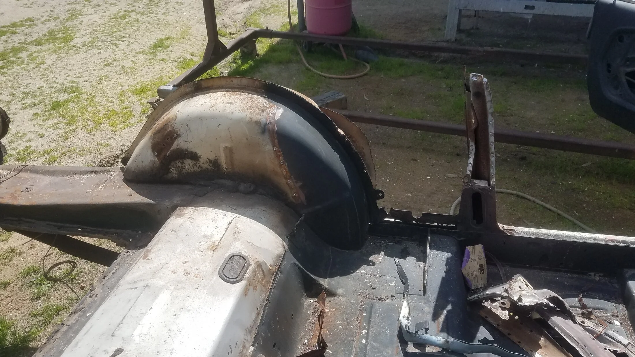

All trimmed out except the wheel lips. Looks like i need a couple of small patches on the tail of the wheel tubs and a couple of small patches on the drop offs way down at the bottom

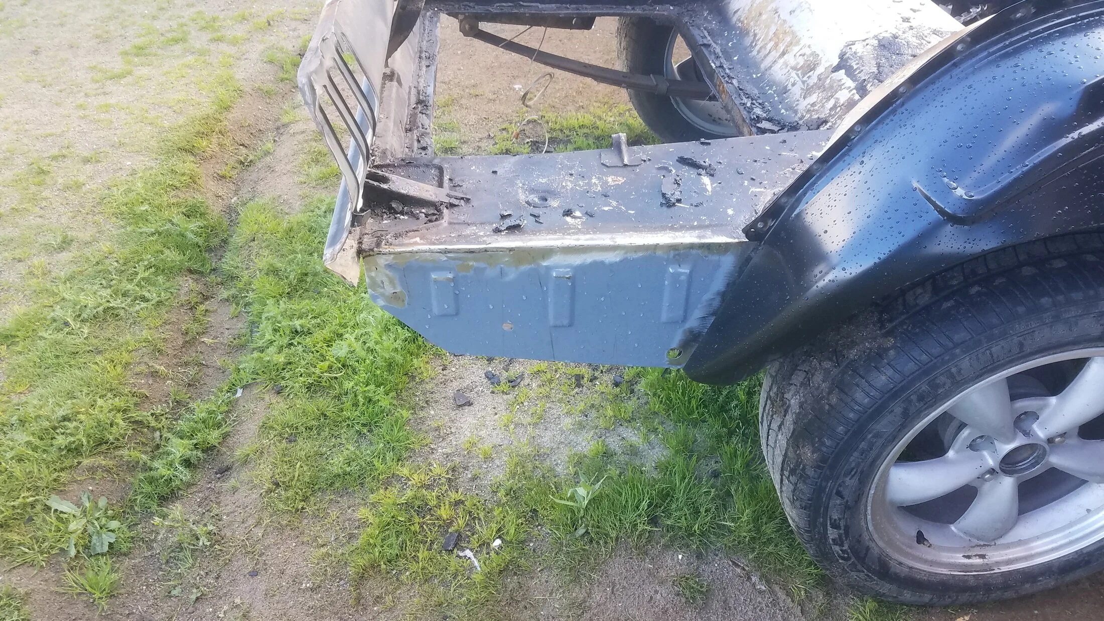

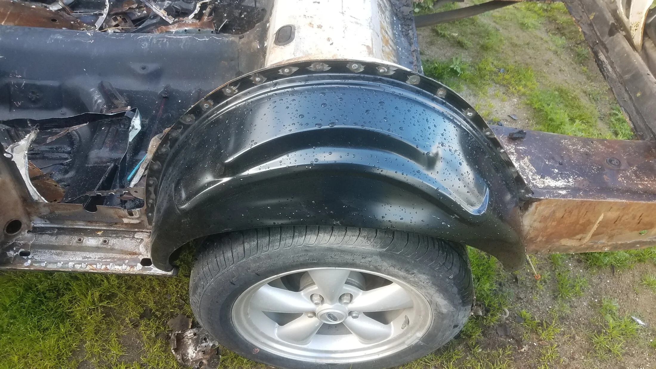

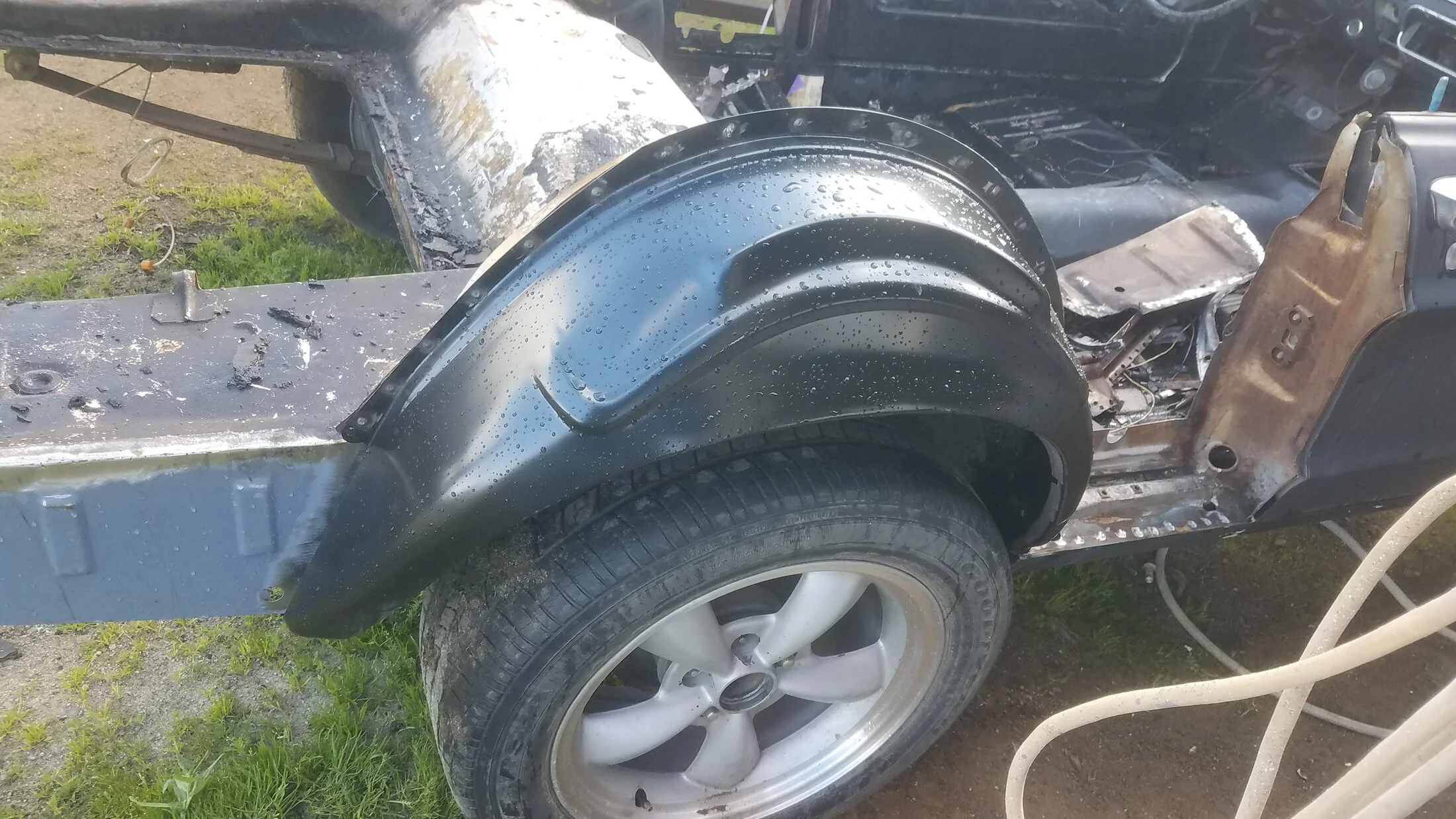

I had to replace the passenger side trunk drop off ,it was rotted at the bottom ,the wheel lips were rotted off on both outer wheel tubs so i went ahead and replaced both of them . I didnt get any pics yet because as i finished the last outer tub it began to rain really hard , as two squirrels and then two rabbits wandered by i figured if two of anything else goes buy i may be needing a big boat tonight!

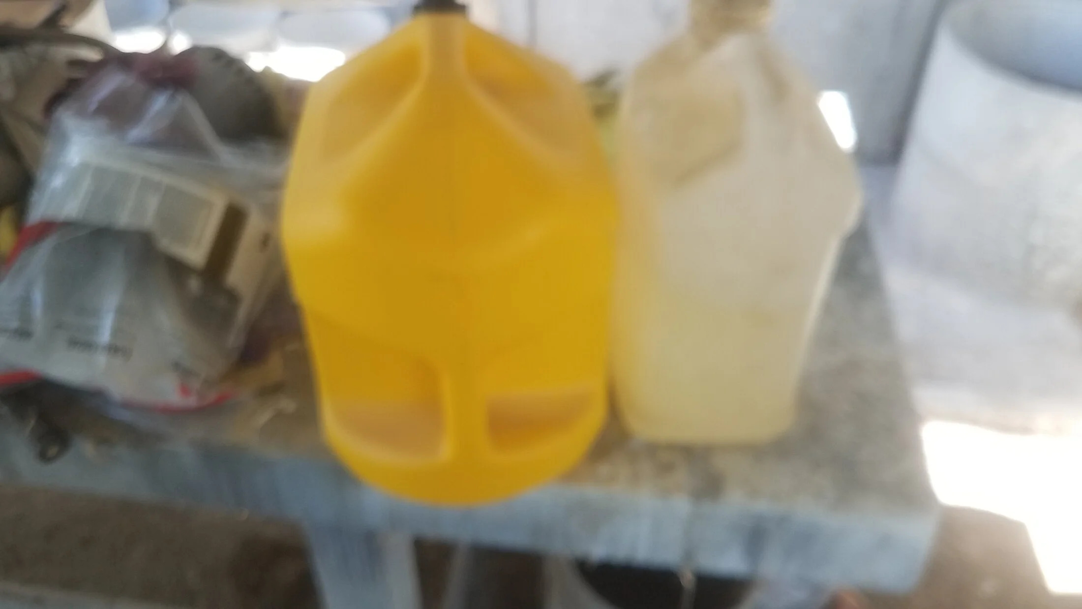

Last week didnt work out ,rained a couple of days and cold ,tomorrow looks like a great day at 78 * for sand blasting . Picked up the sand ,gas and a new face shield so i can see what i am doing. Leroy is ready to go . I have to primer also so it will take up most of the day
Broke my camera lense so pic may be a bit fuzzy ,well ,the new puppy broke it ,little snot took my phone and took off running and when i caught her and got it away from her i noticed she bit through the clear lense ,mean little shnit !

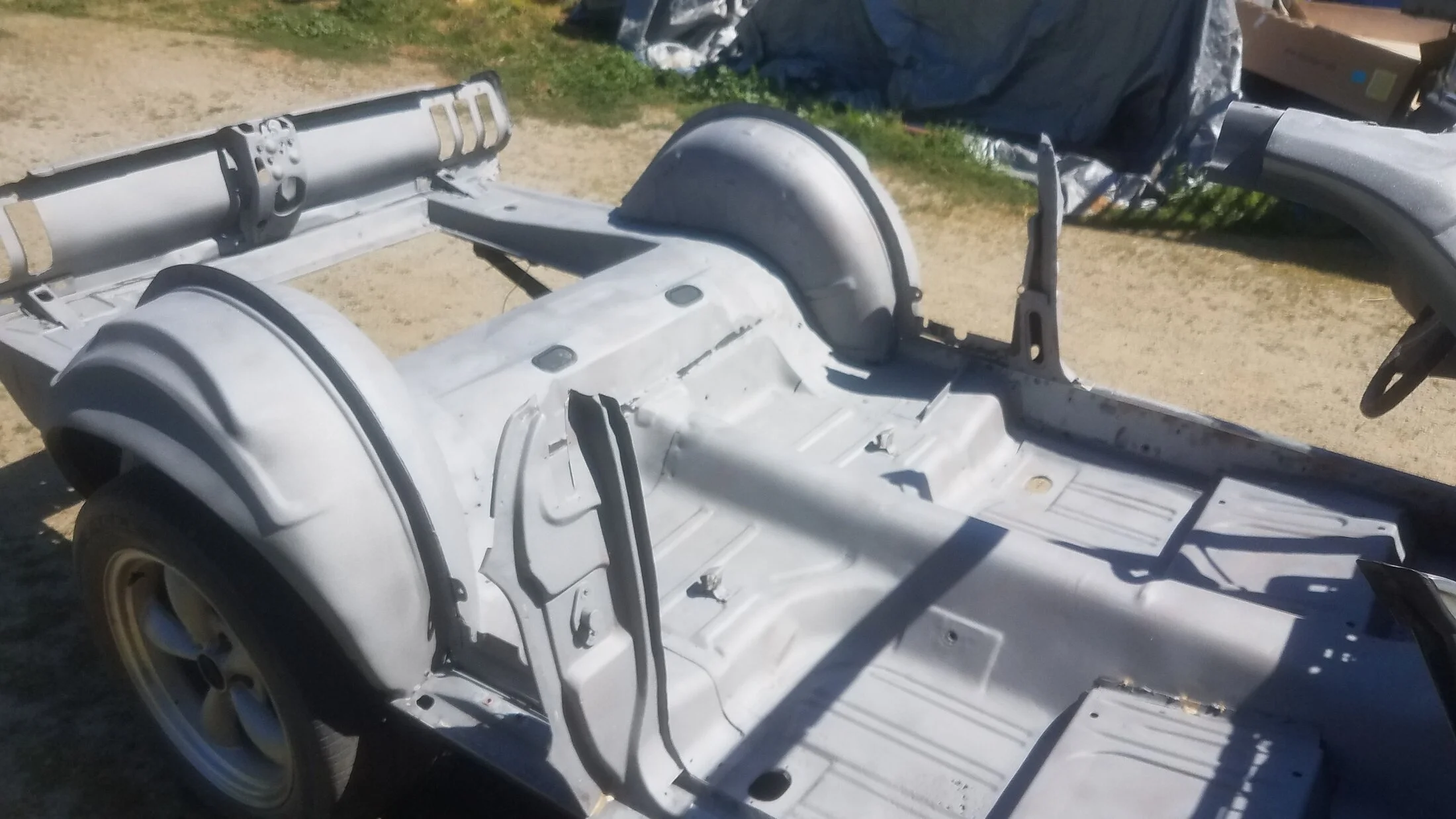

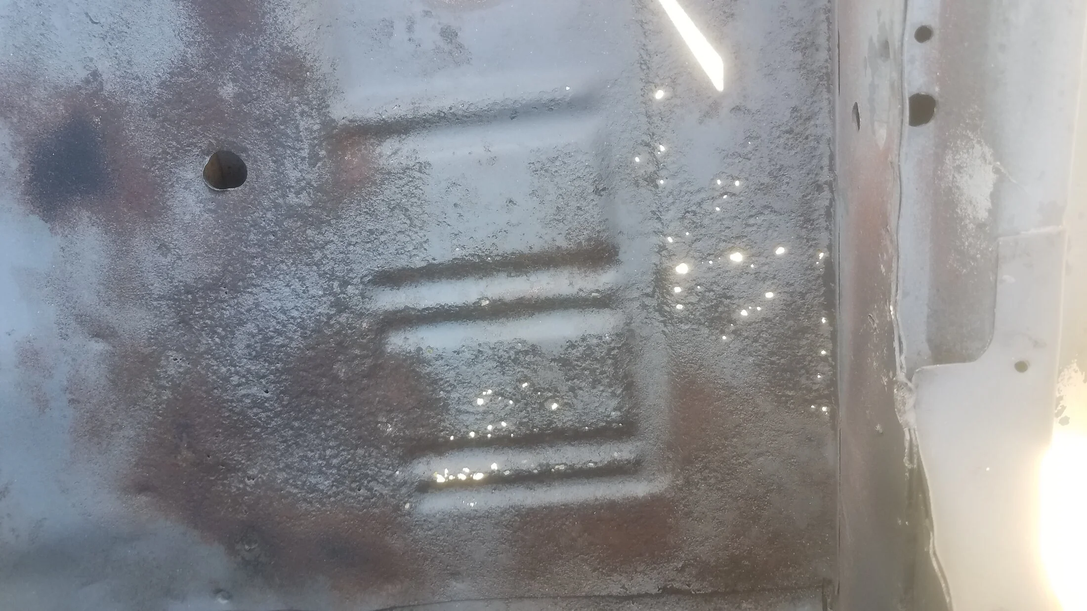

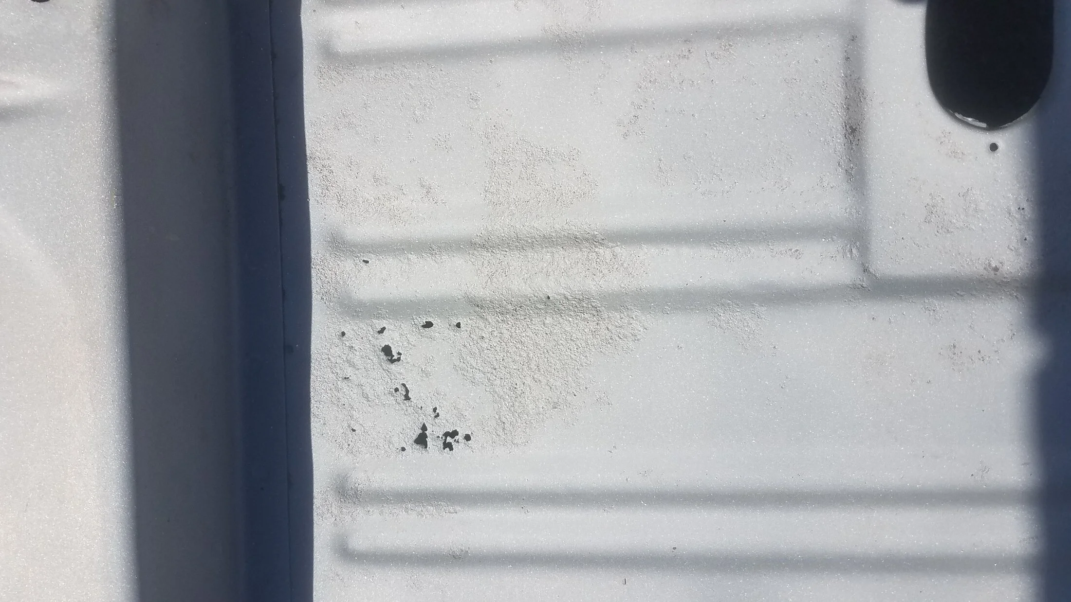

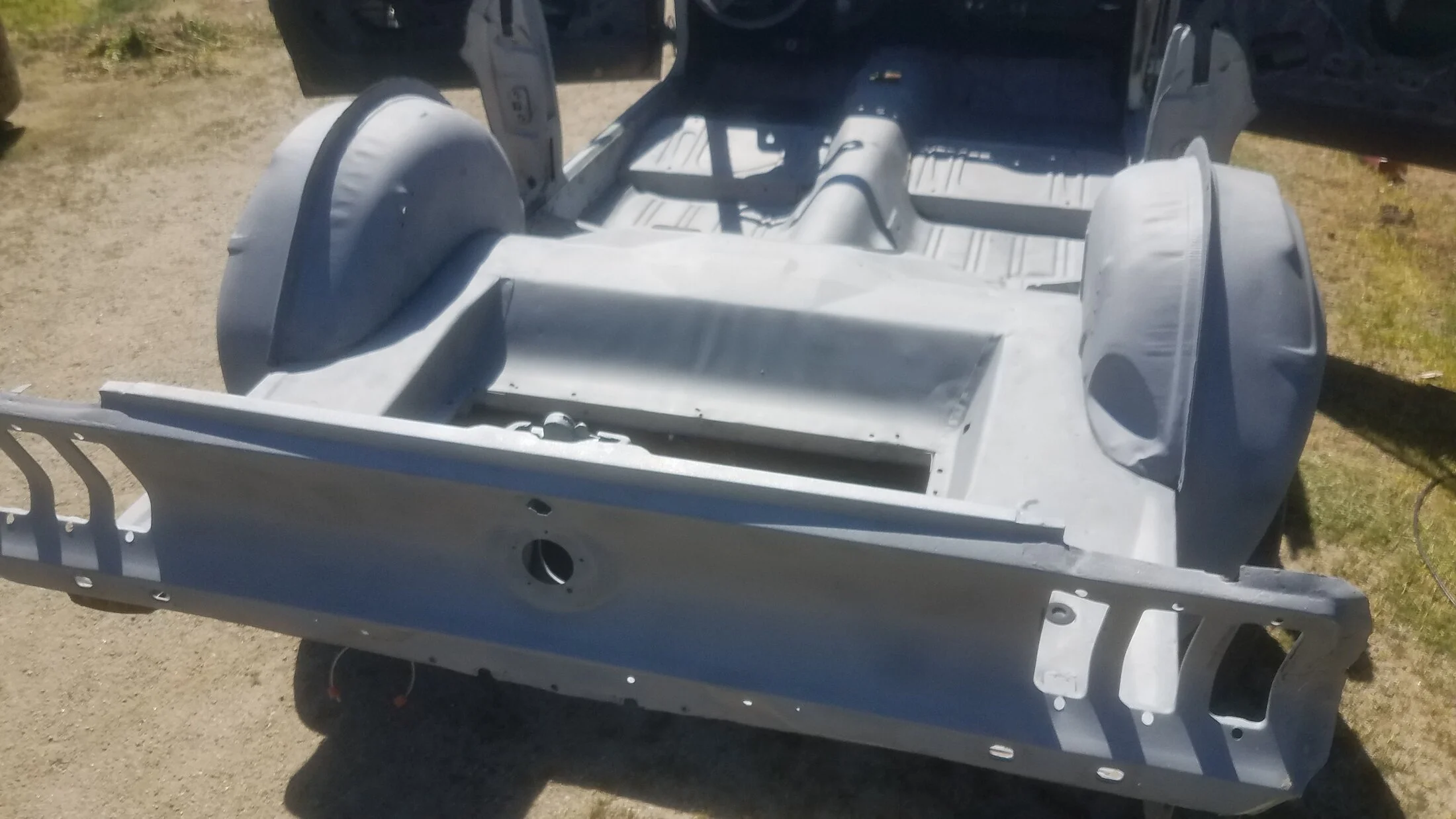

Blasted ,looks a bit better than i was expecting . Toe boards are good ,passenger front floor is good and so is driver rear floor. Passenger side rear floor needs two small patches ,drivers side front is toast !

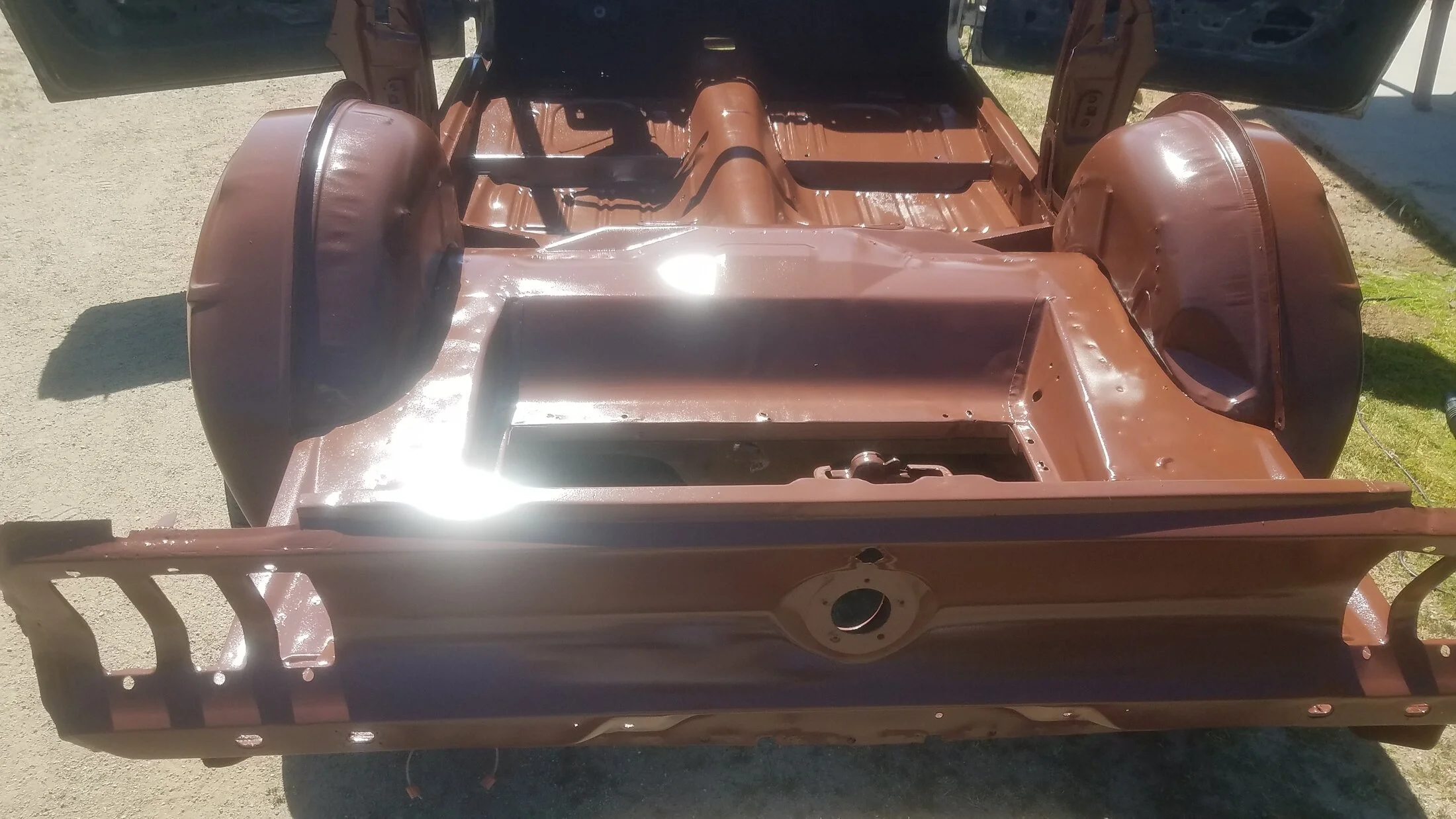

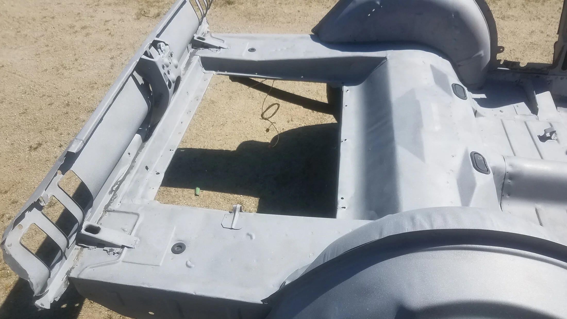

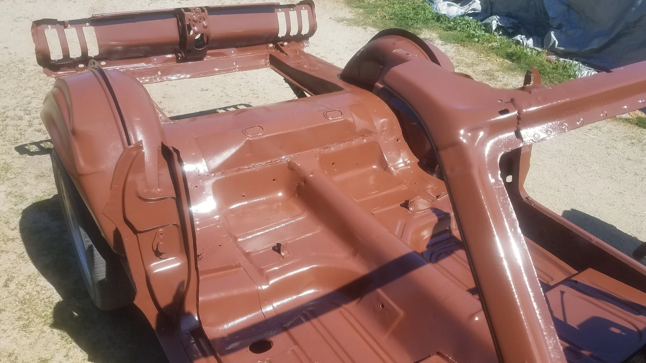

Mmmmm , Chocoooolate ! Thats the last of my epoxy primer ,have to see if i can find some more somewhere!

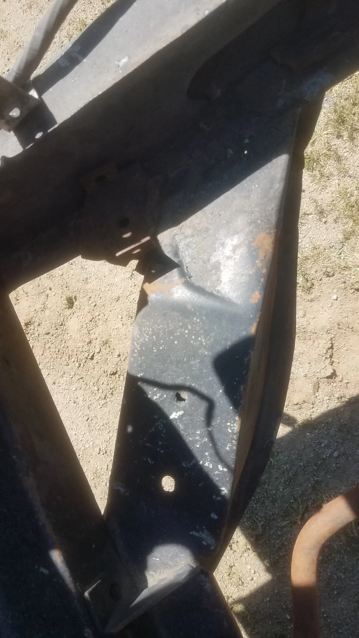

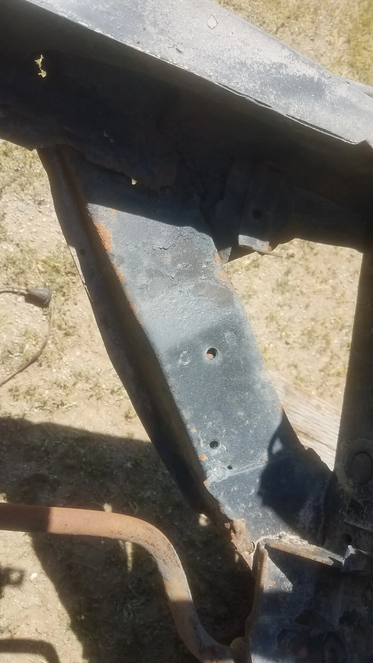

It looks like the radius rod frame brackets both need to be replaced ,the front frame cross member and radiator support will all need to be replaced .

Making progress! Looks like the car was in a pretty square front end collision at some point in life.
