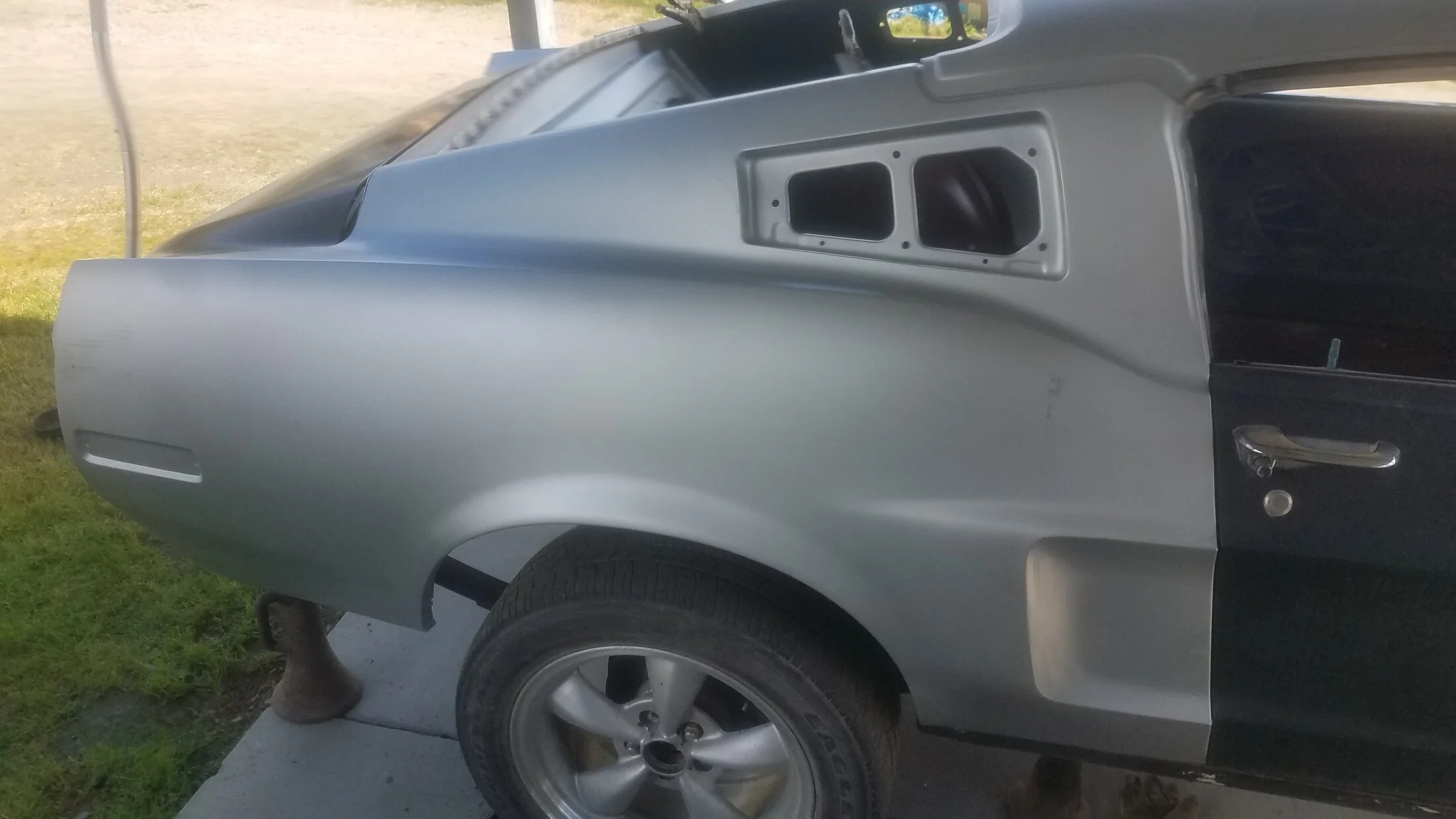

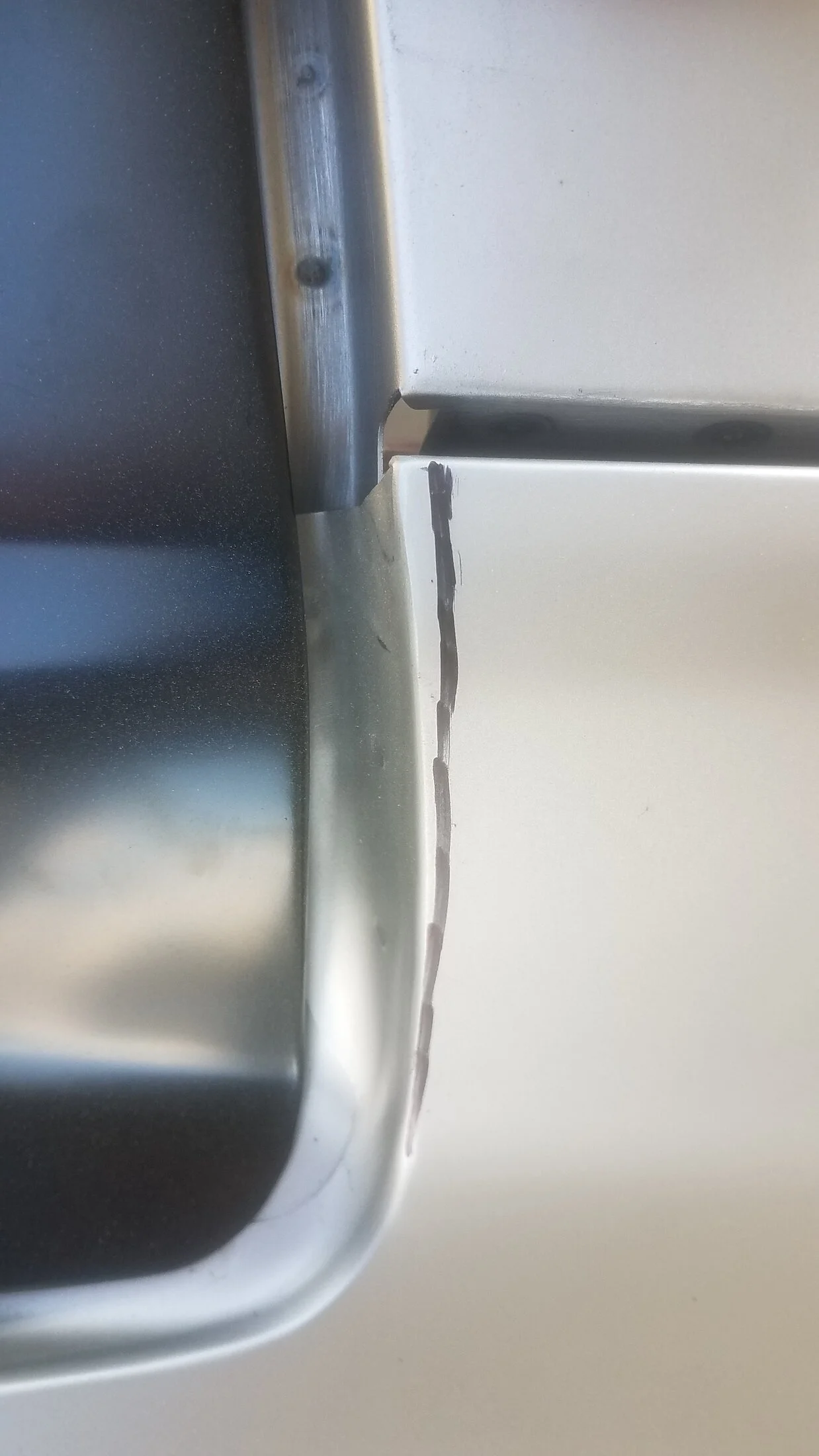

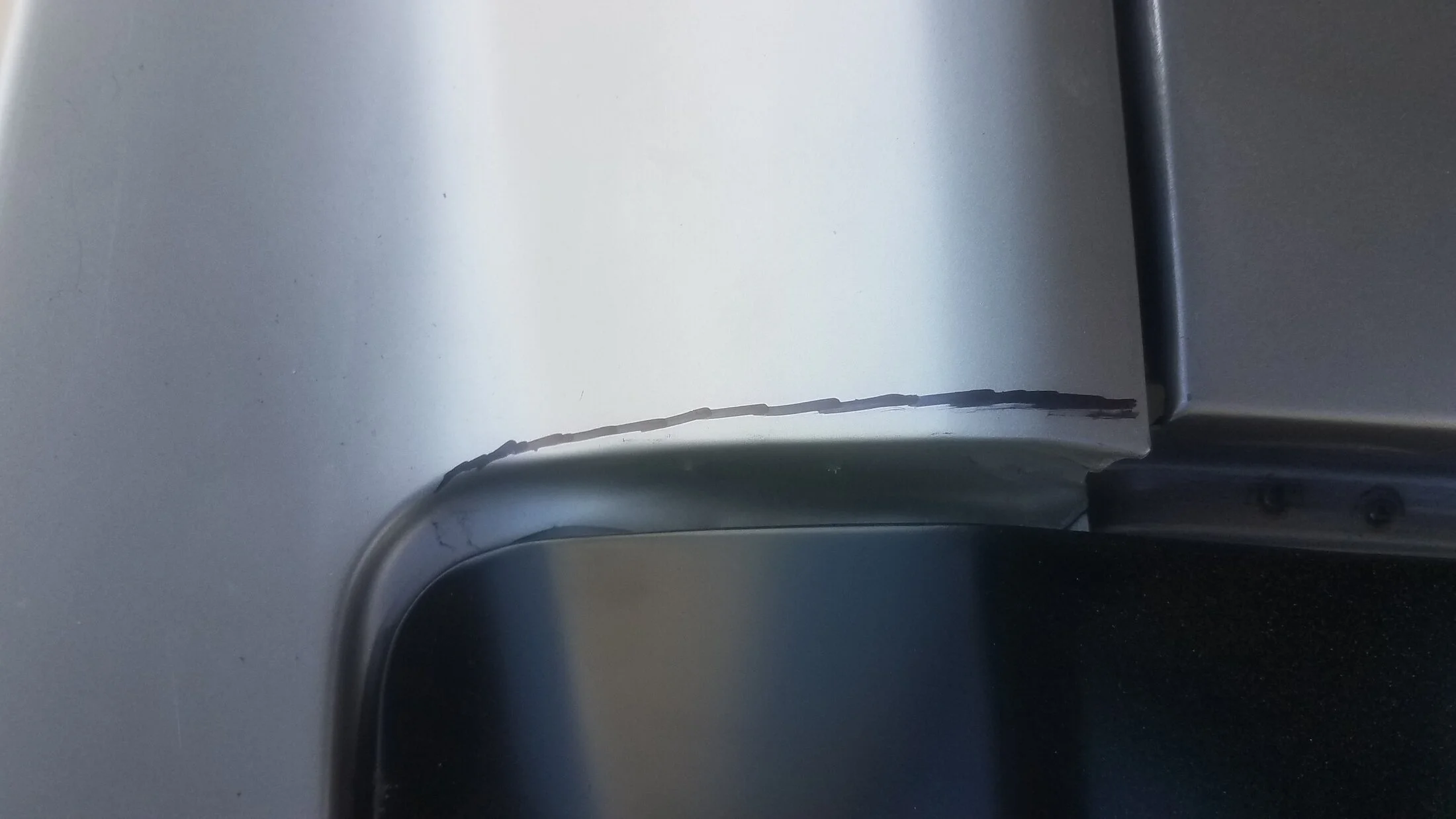

Passenger side just setting in place and it is just about a perfect fit. But when i get back to the trunk lid to quarter and lower window panel i see the quarter is kind of fish hooked where it meets up to the lower window panel ,this keeps the trunk lid from coming all the way forward so i will have to slice it and push it forward about 3/16 where i have it marked but not quite as much as my mark shows . Shouldnt be a big deal just have to weld up the slice once i get the gap correct.
Do you typically have to slit and reshape the quarters by the rear window panel? I didn’t know if all the 67-68 dynacorn quarters are like this and need correcting to have an even gap around the trunk lid.
While trying to fit my quarters and rear window panel, I’ve got a difference in my diagonal measurements of the back window and I believe my passenger side quarter is an 1/8” longer at the rear window panel and I am thinking slicing it like you did is probably the solution.

The 68 quarters i do but the 67 quarters are usually fine .
