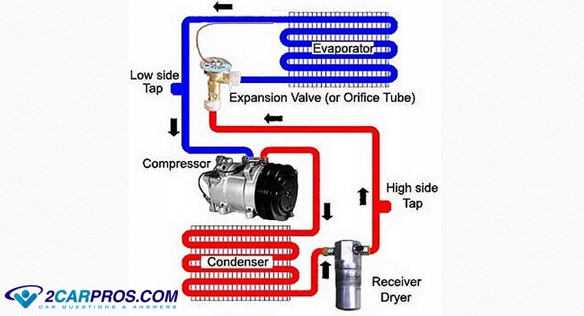

That's not possible, the fittings are two different sizes.
I don't even remember a valve on the compressor. That's definitely not the normal place to fill or check AC. These cars are R134a with the pop on style connectors. I don't know if someone screwed a conversion cap on there or something. Who knows, but that is definitely not where you check the low pressure where a hose from a can would normally be used. Low pressure is checked on the line from the evaporator to the compressor.
Kurt
Kurt
I didn't say there was a valve on the compressor, nor that it was the normal place to check or fill AC. I was talking about the port on the compressor that the suction line would bolt to (a.k.a "the line from the evaporator to the compressor").
Again, R134a service ports are two different sizes, you can't screw up which one is where.
I do A/C work on cars FOR A LIVING, you're not telling me anything I don't know, and you're putting misinformation in this thread and doing nothing to help.
As I said before, the pressure is dropping to zero when he engages the compressor because there's a blockage somewhere on the low pressure side of the system. The low side port is on the suction line running to the compressor, the gauge is bottoming out when he engages the compressor because he's creating vacuum in the low side of the system. I'd bet a paycheck that if he had a full set of gauges that the high side is reading VERY high at the same time.
Again, the reason those bogus recharge kit "gauges" read "dangerously high" when the compressor is OFF, has nothing to do with which port it's hooked up to. If he magically made it fit the high side service port, it'd read exactly the same when the compressor isn't running because the system EQUALIZES when it's not operating. That equalized pressure is usually well above the operating range of the low side of the system.
I spend my summers fixing A/C systems that people with your level of "knowledge" have worked on.
The OP said there was a valve on the compressor. Your diagram does not have that valve on it. I'm just trying to figure out what's going on. You're just being mean. I'm going to report you to a mod. Oh wait never mind.
I am not spreading misinformation. I've probably done more AC jobs than you have. I did one 3 weeks ago, and it blows ice cold. I've fixed many after a "pro" worked on them. So let's stop the BS, and get to the bottom of what's going on here, without comparing penis length. Of the short list of people regularly on this forum, I'm a top 5 fastest car, 25 years of experience, and top 5 with total mechanical experience, so you need to put your opinion in perspective when you pass judgement on my knowledge. I certainly don't know everything, but I sure as hell answer a lot more questions than I ask. The OP said there is a valve on the compressor that he is filling and or checking from. He needs to know that's not how you do it.
Kurt
Reactions: General karthief
No he didn't, he said it was on the line coming from the compressor, and you quoted ME on that post, hence my countering it. Confusion all around! Yay! :jester:
I'll do it for you. Hey @Noobz347 ! There you go. Now I'm gonna be in trouble with my boss, ya happy? :(
