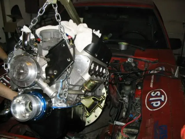

im a little intoxicated right now.''does this help. you will have to figure out how to mount the pump to the head on ur own. we used the a/c bracket piece and fabed it up so the pump could bolt to the head.
Here is a photo that shows it with the power steering pump mounted. I had this setup on a previous car and it is pretty straight forward. If you have a Haynes manual, I believe there is a diagram in there for this. This is basically the same bracket Ford used on non-ac cars. Just move your power steering pump up to the AC spot and your good to go. You will need the belt for a non-AC car if you have all your other accessories. Hope this helps.
