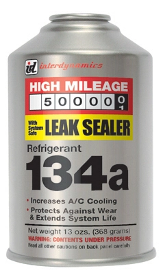

I always get the best results with this brand 129116.webp Walmart sells it, my ac blows colder in my mustang then my truck i hardly use it tho really only time is when wife is in car
