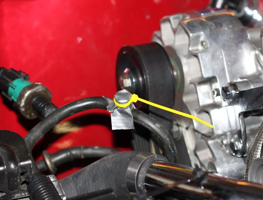

Let car sit Thursday, the started it up FRIDAY.. Still ice cold....Parked car in garage and went inside...Came out an hour later, and it was hissing through the H-side Valve...I pushed down the stem and let it pop back up and it shut off. WHen I went to add a little more gas, it started leaking again.

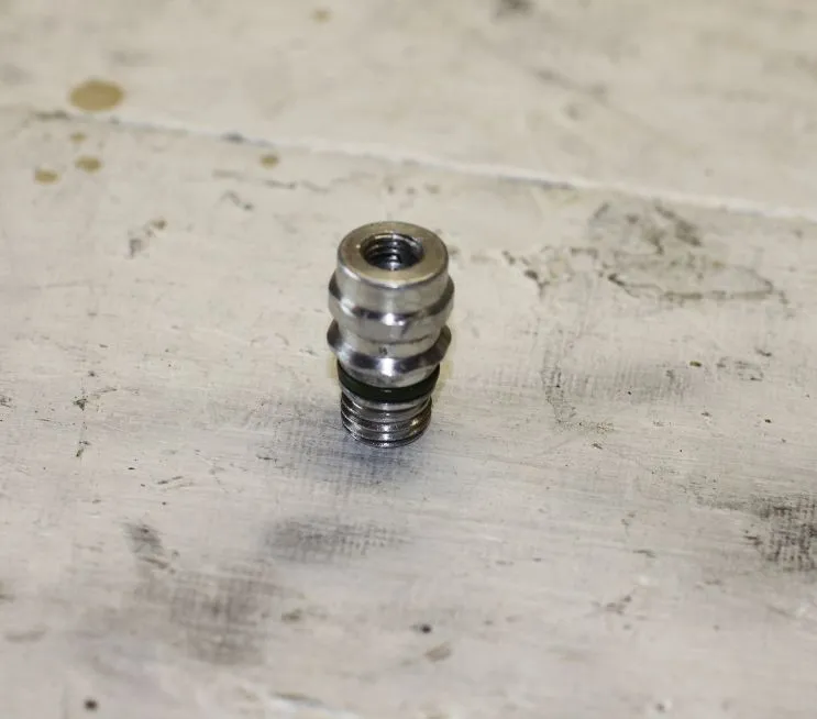

I decided just to change the little metal piece that contains the valve. I found a universal kit, but the piece that looks like it is for my car is a 7/16, and the one I removed looks like 12 mm.
The pics im talking about here. The piece is the one I removed. Is there a place to get this, and are there any tips for getting this corrected? The stem itself is not replaceable.....it looks as though is fixed insided the little housing.

Those valves are specific for Fords. You have to buy the replacement vavle from the dealer directly. The asshats at Ford also made it with a non removable core, so you have to replace that whole piece. The universal one you got was probably a conversion valve from R12 to R134a. I would just buy both the high and low side at the same time, and replace them both. When the manifold gauges are hooked up, it doesn't leak, which is why it passed the vacuum test.

You can get the valves from the Ford dealership, and they keep them in stock. It's one of those nickel and dime items that isn't worth searching all over the internet for. I can't remember what I paid for mine at the dealership, but I know it was under $20 for both of them.

My mechanic picked them up for me today from his A/C guy. . They only came in boxes of 5, but both boxes cost me $23...If they fit, I will have extra ones if anyone needs them. I dont have a FORD dealership really close to me, so it's worth the extra couple bucks I saved on Gas.
