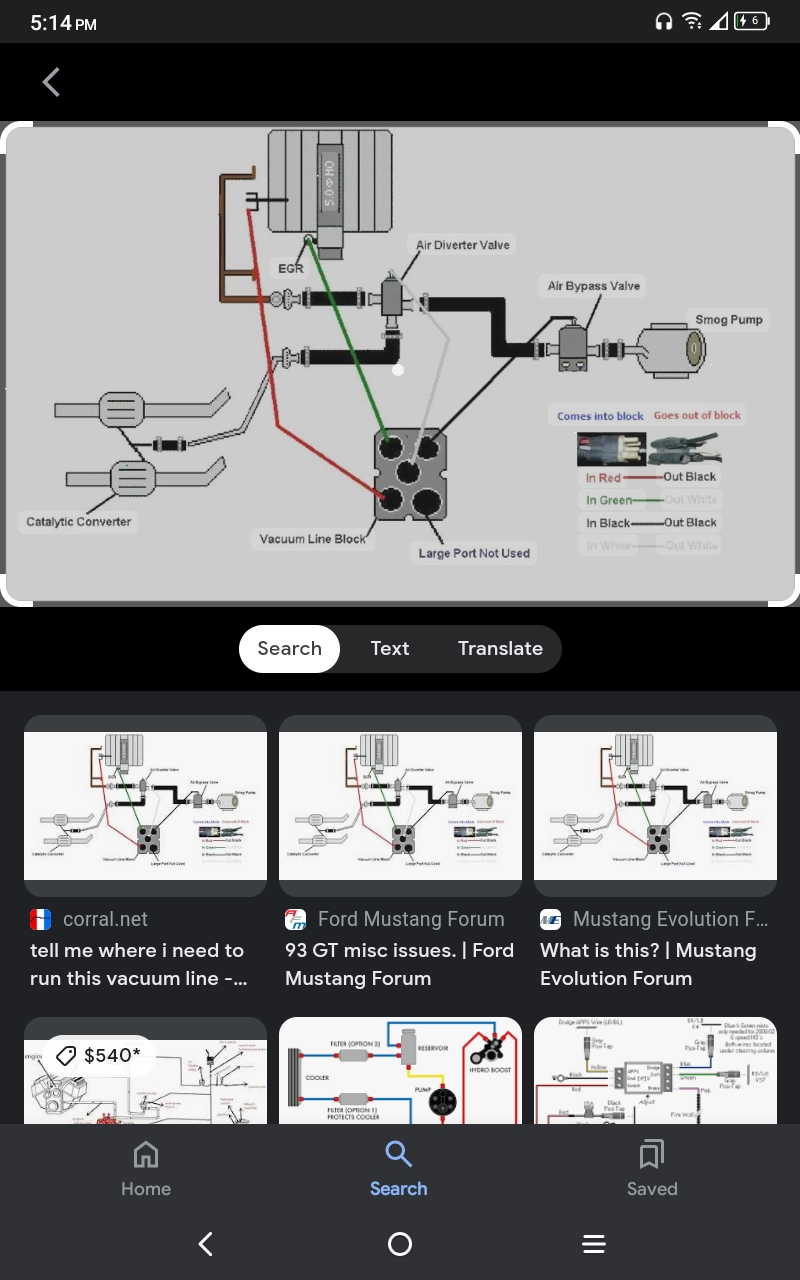

Hello. Is it easy as just removing all hardware , hoses and valves, sealing up what ever is left open. Those metal tubes that go to back of the head, just seal those?
And cap all the plastic vacuum lines?
Reason I think I need to do that is because pump went out, rendering system non functional, and hoping to remove any vacuum leaks, because car seems a little sluggish and knocks sometimes.
Revs are hanging between shifts, ACV seems clean.
Thank you.

I appreciate that. The previous owner deleted cats and welded up emissions plumbing.

Do I have to delete it completely or can I just disconnect the egr electical. It should just remain closed right? Reason is because I can't delete it. That nut won't budge and I'll brake egr metal pipe if I try to get it off.
I blocked egr by sandwiching sheet metal with the gasket.
Now it's very smooth at idle, before it was little shaky.
It felt like it had a huge vacuum leak before I did this.
Now only con is it's feels like it's leaner or timing advanced. And not comfortable to drive. Had the plunger thingy pushed in half way. I'll try to disconnect the egr potentiometer/resistor, maybe it will stop it from changing timing and fuel trims etc.
I hope I will not hurt the engine, as Its running leaner now. Maybe good idea to retard timing.
I spent few hours reading about egr. Some said that you'll overheat the engine, melt stuff due to extra heat, with egr disconnected. The mpg are noticeably worse. I think this a mpg related device. When cruising car is tuned to run lean and egr is cooling combustion, may opinion.
Small knocks (detonations) are audible...
I'm thinking of trying to clean the egr and give a go.
If the EGR system is working correctly, it is only used at part throttle. Exhaust Gas Recirculation (EGR) is used to cool combustion temps to lower NOX emissions. The only way the EGR valve can cause poor idle quality is if is not working correctly. Vacuum application to the EGR valve causes it to open. If the EGR valve is stuck open, then you can have driveablity/idle issues. Proper use of the EGR will have no effect on MPG/Performance. It is strictly a emissions device to control NOX. Make sure the vacuum controls, vacuum lines, EGR valve and EGR valve position sensor are working properly.
With egr blocked with plate I made, engine idle very smooth and has good response.
Before egr unblocked had rough idle and drive sluggish.
My egr is stuck and leaking bad.
I heard pinging and feel like I should have egr cleaned and be functional.
I need to know which way the huge nut turns so that I don't brake the tube.
I know they turn opposite on other cars, wanted to make sure.
From my research it does help with mpg. Your post is very informative neverthe less
I just tested to see if car runs better with position sensor disconnected and EGR blocked. No knocking. It does seem like there is timing advance.
With it connected if feels like you have a lot of timing advance, and can hear knocking, which is what computer is doing.
I wanted to confirm if this is safe to run engine this way.
I guess if it doesn't knock then combustion temp arent really high.
One user claimed that without EGR combustion temps can be too high and damage to head gasket and pistons can occur.
