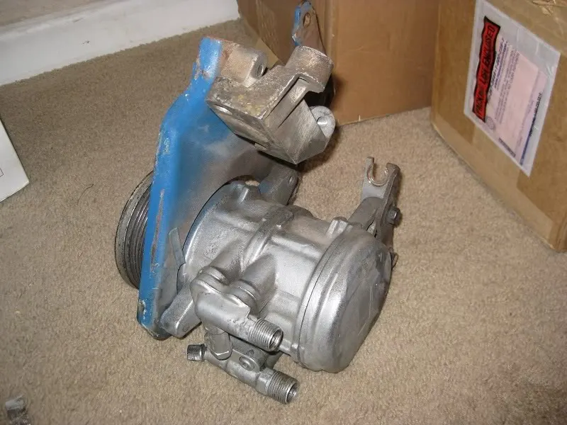

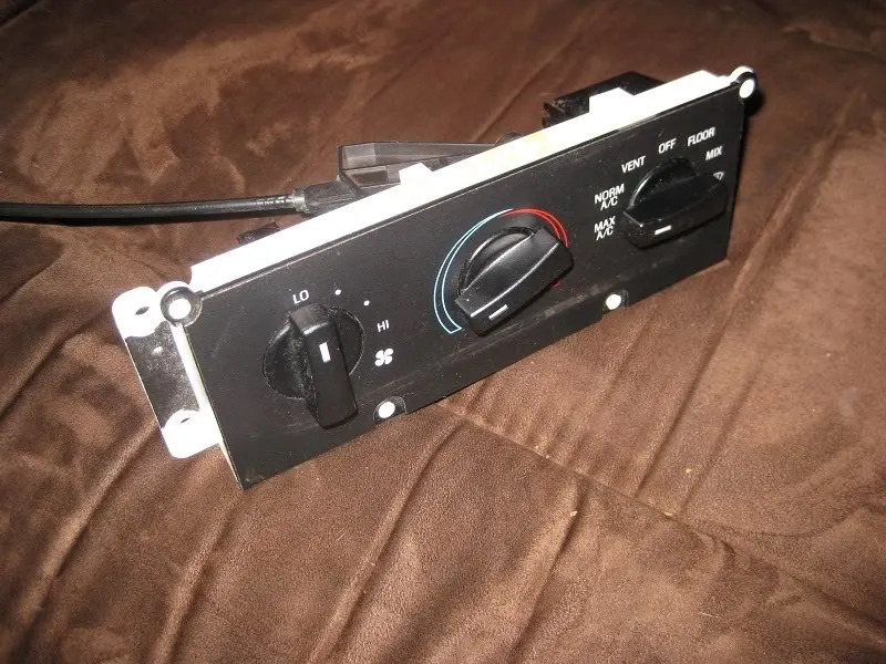

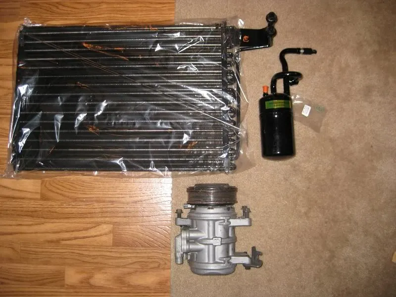

I just bought a 5.0 GT a few days ago...with a factory A/C delete but the guy gave me a bunch of stuff to install the A/C. My question is do I have everything I need? Every part I have is pictured only once, so I do have duplicate parts, but I want to know if I have everything I need.

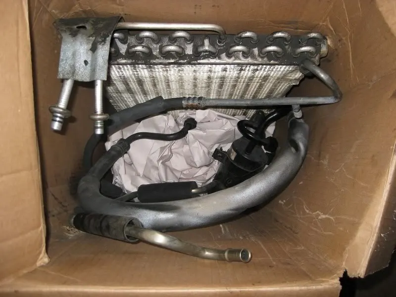

Looks like you have almost everything. I don't see the A/C evaporator core in your pics? That goes under the dash inside the heater box along side the heater core.
If you plan on reusing the old lines go get a packet of new orings from the autoparts store. About $5 bucks.
After installation make sure you have the system vacuumed out to check for leaks and trash before recharging.
Good Luck

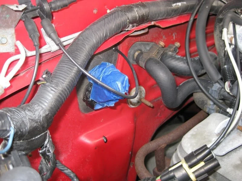

Does the evaporator stick out of the firewall? If so, I think I might already have it installed, but taped off.
Is it ok to stick with the old hoses or should I go ahead and buy new ones?
If you see two aluminum lines coming out of the firewall on the passengers side just to the left of the heater hoses its in there. If so, hopefully they have been taped or capped off if not being used.
Personally I would buy new lines and core unless the old ones have been capped off to protect from contaminants getting in. Looks like you already have a new condensor and accumulator. The compressor should be fine.
Get yourself a set of lines to be safe.

I believe these are those lines?:
I will definitely buy new lines; I'd rather be safe than have a screw up.

Yes. Looks like your car had A/C and someone removed it previously.

You should really inspect and inventory your parts first. Look inside and if there is any rust, the part is junk.
Toss the old accumulator bottle as its been opened to the atmosphere and junk. There is a dryer material inside that soaks up moisture. No not remove the caps on the new bottle until ready to install the lines and make a closed system.
Inspect compressor too. Seals could be dried out, or contaminates inside. You could ruin all your parts if you pumpmrusty debris into the system.
I don't see the 2 foot long ac compressor wiring plug
Your orifice tube hose looks old. Don't use it. A new line is $30 or so from rock auto.com. Get the entire line, the orifice tube itself is not easily replaceable.
Evap core could be junk. Duct tape really isn't a good way to seal it off. You should flush it with solvent first.
