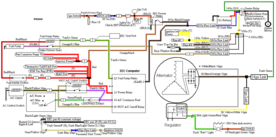

WHen the AC is turned on, check the LPS RD mentioned. There should be 12 volts in and out. If you have 12 volts out, go to the WOT relay and check the wiring (it's prone to vulcanizing). If you have 12 volts out of the NC terminal of the WOT relay, check for 12 volts and ground (at the second wire) at the clutch.

Here's some diagrams to help you visualize Hissin50's comments. All the A/C related parts are in the lower LH part of the diagram.
See the following website for some help from Tmoss (diagram designer) & Stang&2Birds (website host) for help on 88-95 wiring http://www.veryuseful.com/mustang/tech/engine/
