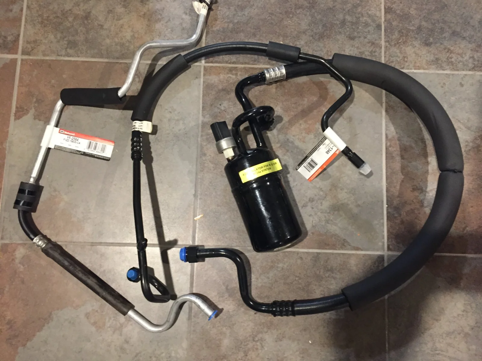

It seems I've read most of this info before, but I can't seem to find anything now. There's plenty on converting to R134, but not adding on an entire system. I have an '89 GT vert that had A/C deleted when I purchased. I'm looking to put everything back together. I've installed a Vintage Air kit in an F150, but that's about the extent of my experience. I have a Haynes manual and a shop manual, but wanted to get some advice before I get started. I already replaced the evaporator and some vacuum lines in the dash while I had the box out. Here's a list of parts I've compiled so far: compressor with clutch, condenser, dryer/accumulator with hose, orifice tube, compressor bracket kit, orifice tube hose assembly, compressor to condenser hose, condenser bracket kit, compressor wiring harness, and longer serpentine belt. Is there anything I'm missing? Is there a bracket or clamp to attach the accumulator to the firewall? I still need to get the vacuum tank and check valve, but I think I have the vacuum system under control.
So far, my parts total $575, which is less than the kits I've found and more comprehensive. The compressor I'm buying is a Four Seasons SD709, pn 58581. I do not need manifolds with that, right? To simplify, I just need to connect all these parts together, then take to shop to have them charge it. Is that correct? Anyone have any tips, links to resources, etc.? I appreciate the help.

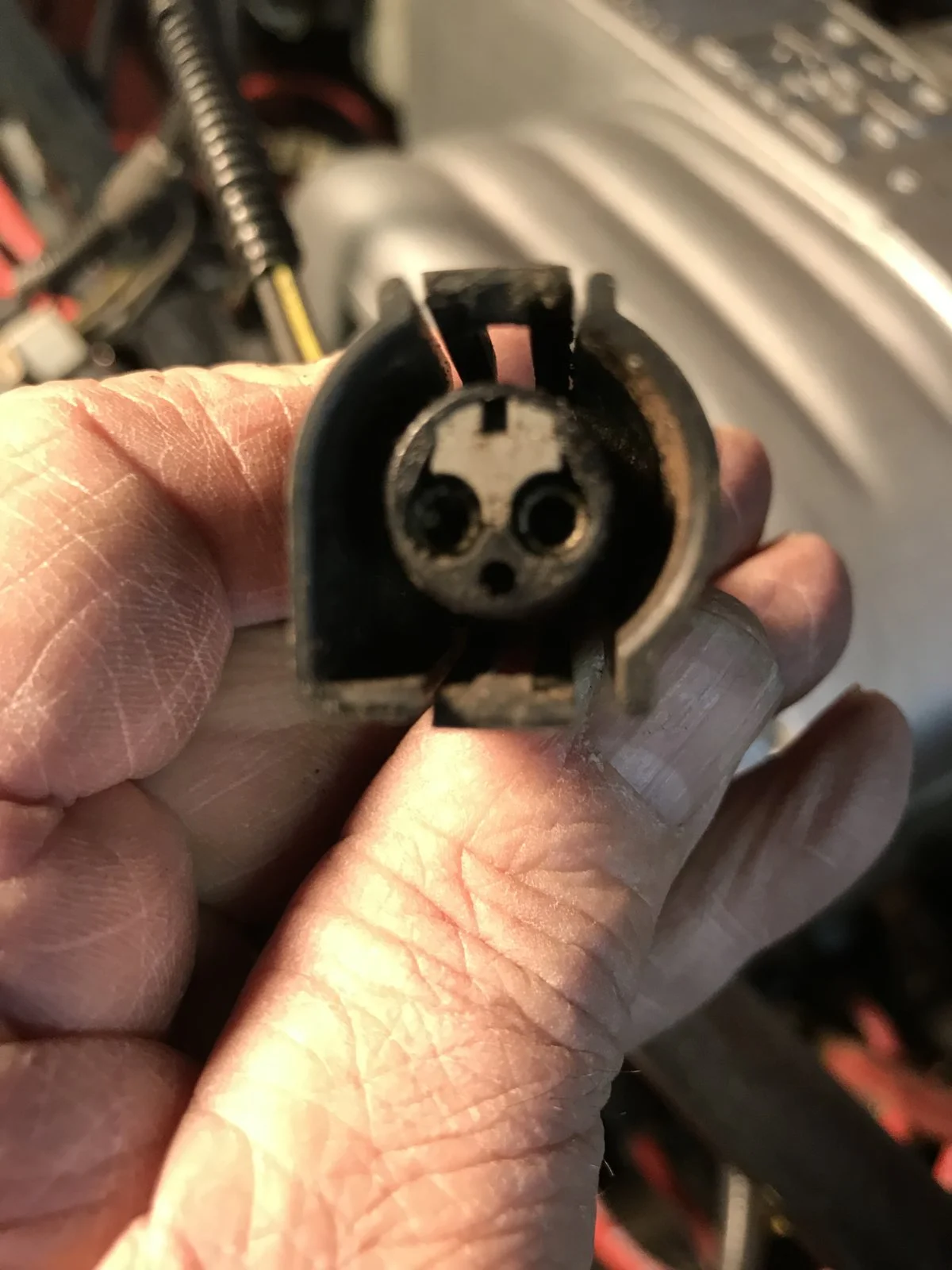

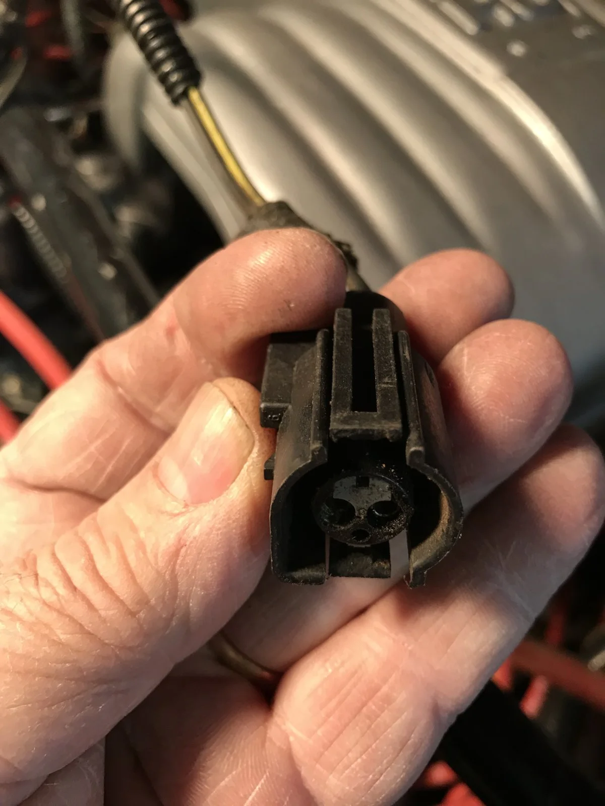

There are two hose connectors that bolt to the top of the compressor and a bracket that holds the dryer/accumulator to the fire wall.
Thanks. The only place I can find the accumulator bracket is on Ebay, for around $40. I think I will fabricate something.
The compressor I found does not seem to have the manifolds you refer to. It has two threaded ports near the back. I assume high and low sides. Here's a link to the unit I found. It is for Dealer installed systems:
https://www.rockauto.com/en/moreinfo.php?pk=815999&cc=1133952&jsn=497
I also found a part which is the A/C clutch cycling switch, but I don't know where it goes. I also don't know how to wire the compressor. I found a two wire pigtail that I assume plugs in to the wiring harness, however, there is only one red wire coming off the compressor. Anyone know what I do with the other wire?
Thanks Jrichker. I've run across this info from you before. It contains a lot of useful information and I appreciate it. It does not provide me with what I'm looking for regarding any additional parts I may need. I don't plan to charge the system myself. I wish I could find a good diagram of all the parts and how they fit together under the hood. Thanks.
Right. It is a replacement for dealer installed compressor. I've crossed referenced on several websites, and they all confirm it's supposed to work on the car. I should figure out more once I start to put it together. I guess worst case, the shop I take it to for charging can figure it out.
The hoses I'm using are all from Rock Auto. I've purchased the orifice tube assembly hose, what's called just a hose assembly(I'm pretty sure it's compressor to condenser), accumulator with hose assembly, and condenser to evaporator hose assembly. Hopefully that's all I need. Basically I bought all the hoses listed on this page:
https://www.rockauto.com/en/catalog...+&+air+conditioning,a/c+refrigerant+hose,6900
Figured I would send back any I did not need.
If your car came from the factory with ac, and a previous owner "deleted" it (took everything off) and you are trying to put the ac back in you really should use a compressor for factory ac, not one for dealer installed ac. They are different and that will make the install a bigger headache than it needs to be.

I concur with the above. If you are purchasing factory style hoses, you are kinda committed to getting the factory style Nippon denso 6P compressor. Most of the remans do not come with the manifolds so you'll need to source those.
Yes you'll need a bracket to mount the acumulator to the firewall. There are also two mounts on the bottom and top for the condenser mount as well.
As for lines, you have your three main lines, confessor, evaporator and accumulator which is usually part of the hose that loops over the intake., I'm actually doing the same thing so these are the lines I have.
Then you need your compressor which remans usually need the manifolds. Helps to grab a core from somewhere if you can to use.
After that, put it all together, pull a vacuum, fill with n2, then pull another vacuum and then charge.

It is missing a short harness that includes a surge dampener diode and the connector to the A/C compressor
It is missing a short harness that includes a surge dampener diode and the connector to the A/C compressor clutch
8790"]It is missing a short harness that includes a surge dampener diode and the connector to the A/C compre
