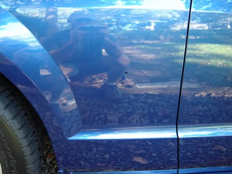

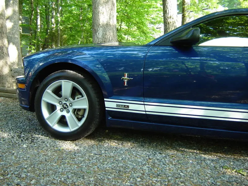

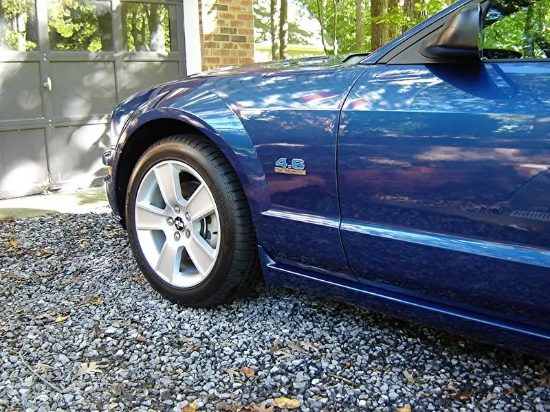

I have swapped my fender emblems two times now...Hopefully I'm done:D I feel the running pony is very fitting on these cars. Removing the emblem reveals the 2 alignment holes which means you either cover it with something else or have them filled and repainted. Only the base model V6 has clean fenders. I read somewhere that using a pliable(but not flimsy) credit card works well. I used a smooth card(bank account card-nothing super important if it got messed up). I have done it 4 times(2 on each side) and have never had it scratch. I did it in warm weather...no additional heat source was used. I'm sure the hair dryer would certainly help by making the adhesive much more pliable.

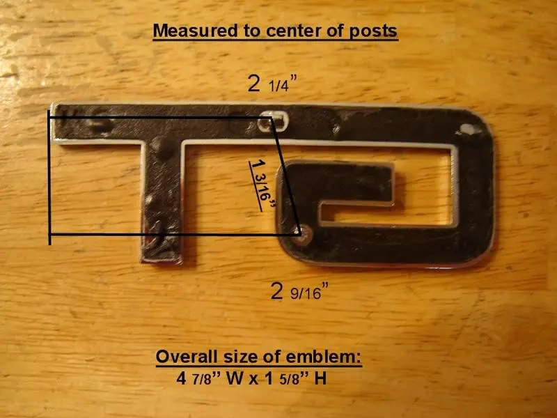

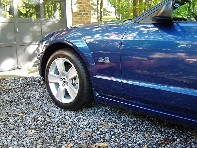

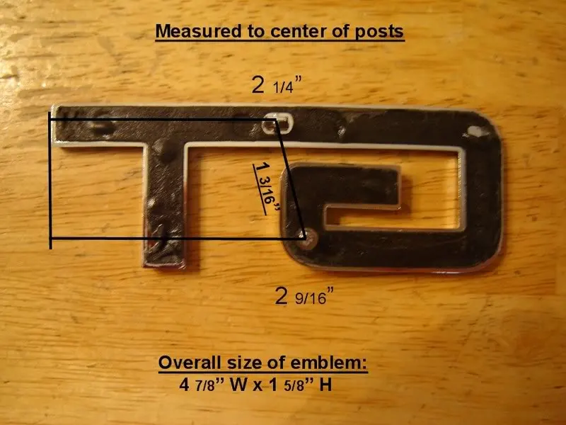

Fortunately there is not much adhesive on the back of the "GT" emblems due to their skinniness. This makes them fairly simple to remove(a few minutes each). I was able to remove both of them without even having the plating crack. The 4.6 emblems I used where a &%#$@ to remove and clean up after due to the amount of adhesive they had. Probably took me close to 20-30 minutes per side for removal and surface cleaning.
