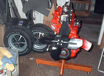

Hey StD!!!
These photos are for you................
1) "new" shoes and freshly cleaned-up engine conspiring to take sally dancing....

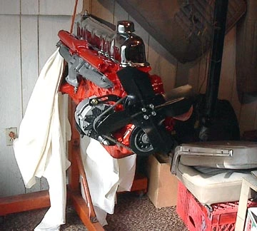

2) Clean engine with (most) of her attachments back on.....fuel pump is next, then carburator is next....
attachment.php
I still have to replace the dizzy, re-plumb the fuel line from pump to carb, vacuum line from dizzy to carb and the various hoses which I want to replace w/ stainless steel wrapped hoses w/ red clamp covers.
After I've finished the engine I want to put her back on the dolly and put the tranny on the stand to work on........
