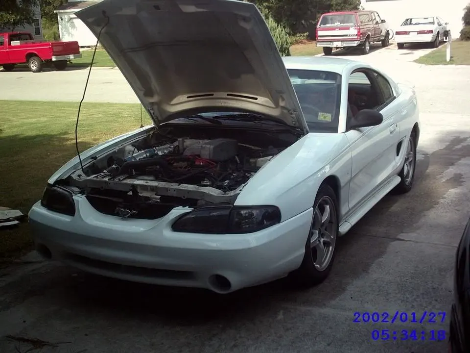

my neighbor gave me a set of fox valve covers which i think look a hell of a lot better than the stock ones from our cars. finally got the chance to clean them up, paint them and put them on. my car is daily driven so the rest of the engine bay isnt very clean but the valve covers make it look a little better.
while i was outside with the camera i decided to snap a few of my other toy.

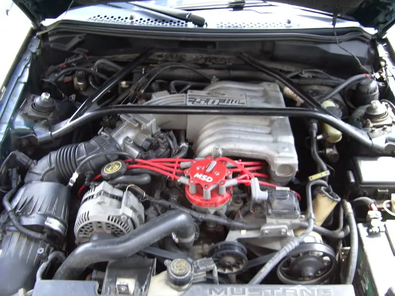

I daily drive my car as well, but I recently started making an effort to keep the underhood clean. I just got a bottle of Castrol SuperClean degreaser, spray it on, let it soak for a few minutes, use a plastic bristle brush on the tough spots, and rinse with water. Start the engine and let it idle for about 10-15 minutes to dry the water, then let it cool off. I used an engine detail spray I found at the parts store, made everything look nice and shiny and new. Only took a few minutes to do. Here's the before and after shots:

Thanks. Its the "Engine Finish" spray that really made it pop though.

Since there is a good engine bay pic here, let me ask all a question.
On the before picture you can get a good look at the dizzy and the coil.
My question is what is the small cylinder object on the back side of the coil?
Thanks

if im not mistaken i believe that is a capacitor

Yea, its supposed to help with coil noise through the radio.

Why are we skipping the idler pulley?

I was wondering the same thing.

lmao. about 2 years ago my smog pump went out. i searched on how to run a short belt and found a diagram that had the short belt routing and the belt size wouldnt fit using the pulley. i ended up getting a smog pump eliminator and run the stock belt again. recently the bearing in the eliminator went south so i put my old short belt back on so i could drive the car. fixed the pump eliminator and just havent put my old belt back on. now im bypassing the compressor, cause my a/c doesnt work well enough to even use it. i need to fix it cause the window is not good enough
