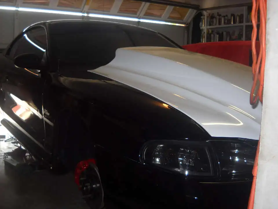

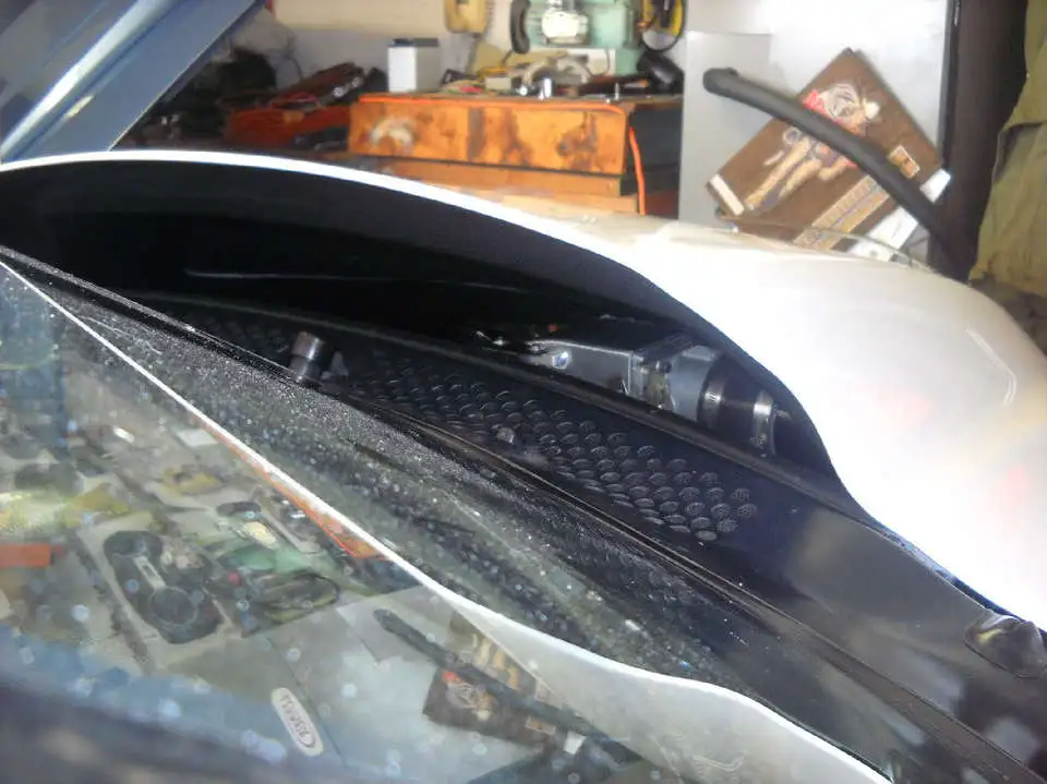

I had a hood almost as tall as that. That is the only reason I am not a big fan of it. If you like it though then rock it. It will change the look of the car for sure. Keanan makes one of the best hoods out there. Mine was spot on fitment wise.

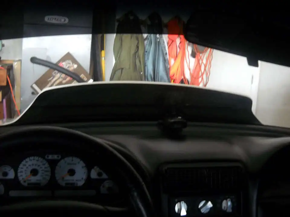

yea, it really gives it a race car look, the hood is OEM quility! i went to the ware house and picked it up. there shop is amazing! ive never seen so many hoods!!!
The hood looks f'n nice!!!

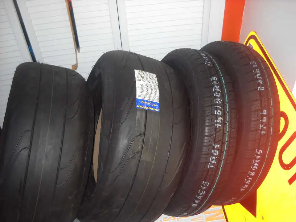

I dont know if its me but the hood actually killed it for me. I just dont see the need for an insane lift like that unless you absolutly need it. Other then that the car and changes you did are amazing. Why DR's and not a full slick?
well with the edelbrock and 6061 plenuim, it has been rubbing a little since i put the solid motor mounts in with my 2.5" hood, and a buddy of mine has their 5" for 99-04 and i really liked it, now i have the room to put a 1" spacer between the plenuim and intake mani if i want.
i went with dr's cause its still 95% street car, and i planning to buy a set of cheap summit aluminum rims to throw slicks on for the track

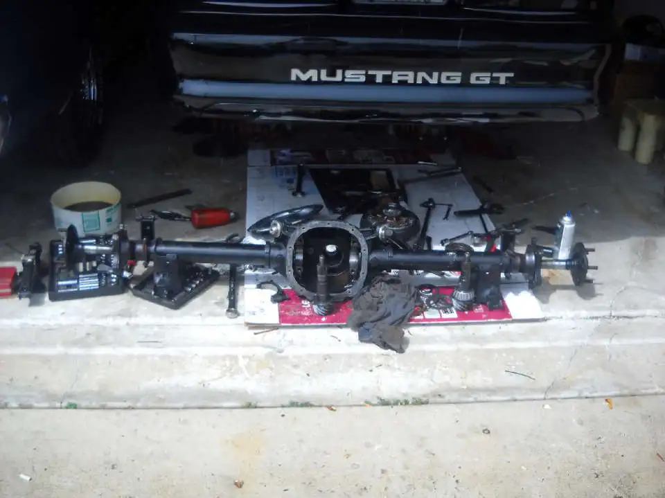

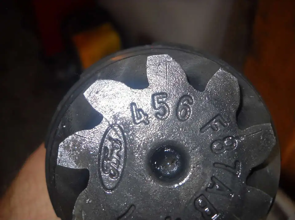

I had 4.56s in my last 'stang, and they were insane! I drove them for a full 3 days with the stock 245s out back before I decided that the car was going to kill me unless I paid for more traction.
Those Racestars are about my favorite drag rims. They are only second to a nice set of Bogarts :nice:

ive had the 4:30's for about a year now, and it just wasent enough, i barley use 5th gear in town, unless going 55+ with the intake/cam setup the car doesent want to run below 2000ish rpms.
yeah, i fell in love with the race stars!
