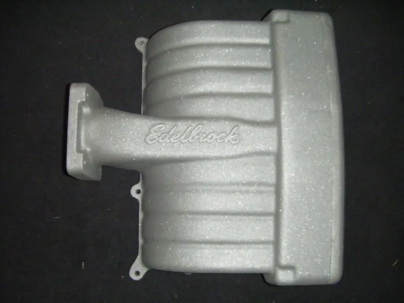

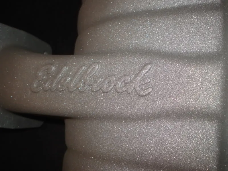

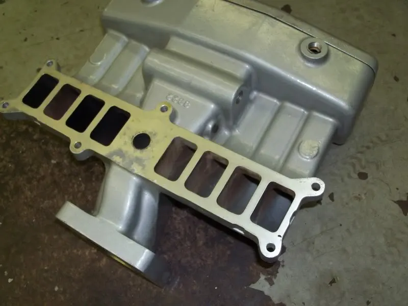

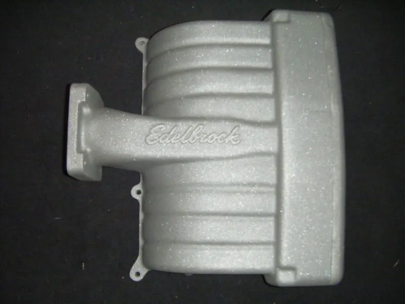

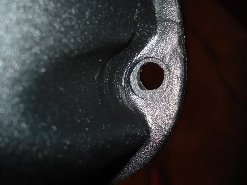

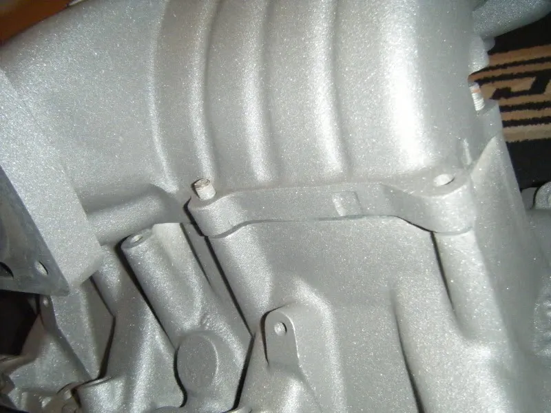

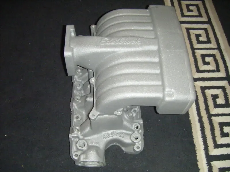

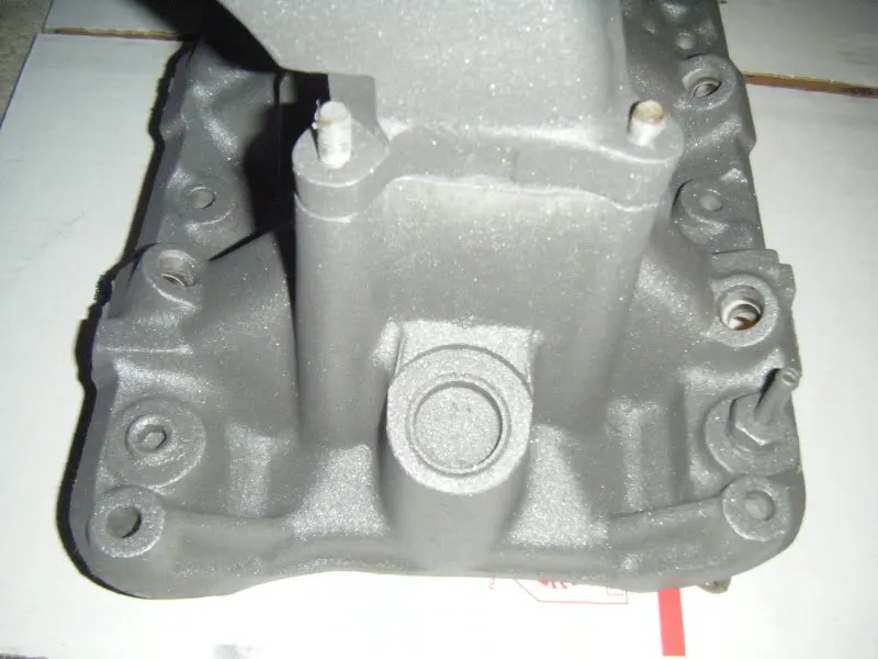

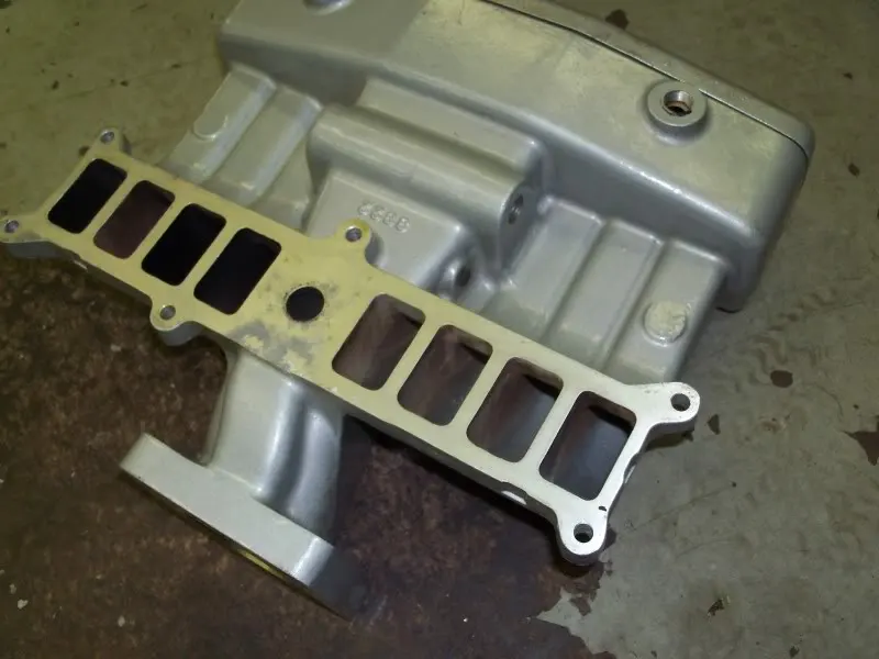

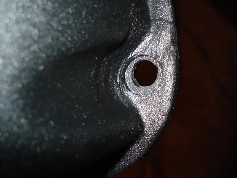

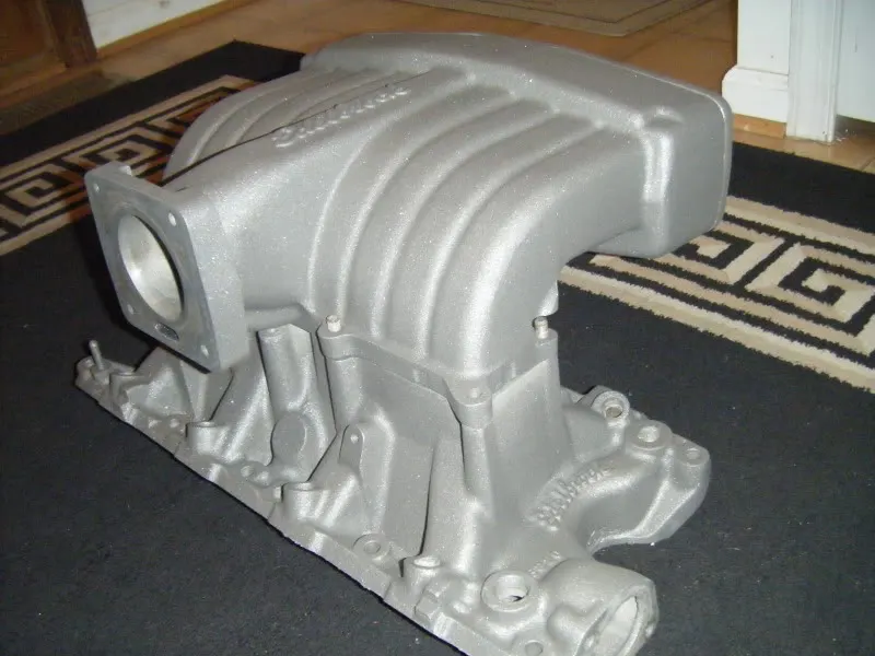

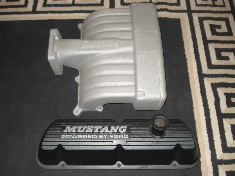

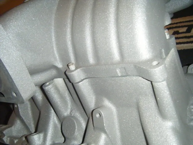

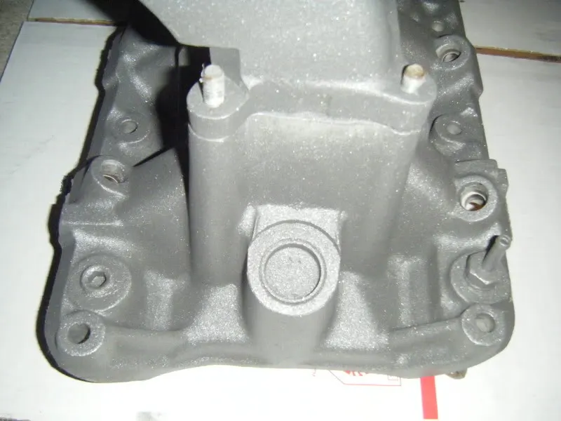

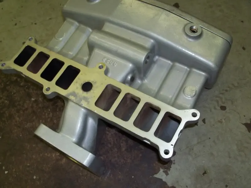

Focus left me stranded again tonight... starting to get angry... in other news i finished some powder coating work:

Looks good Adam - what all did you do to it? I just started on this thread.

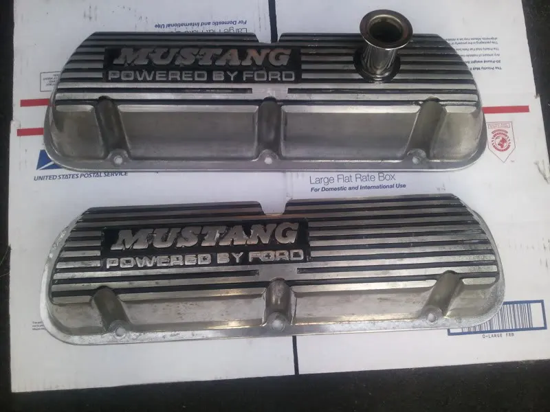

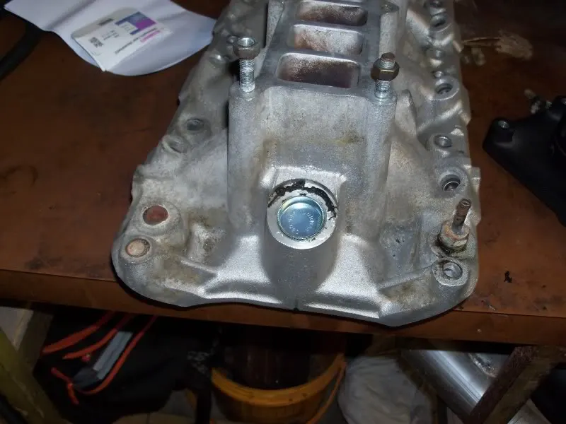

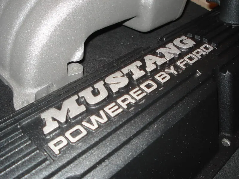

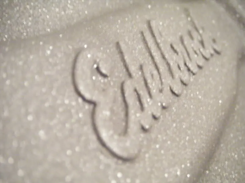

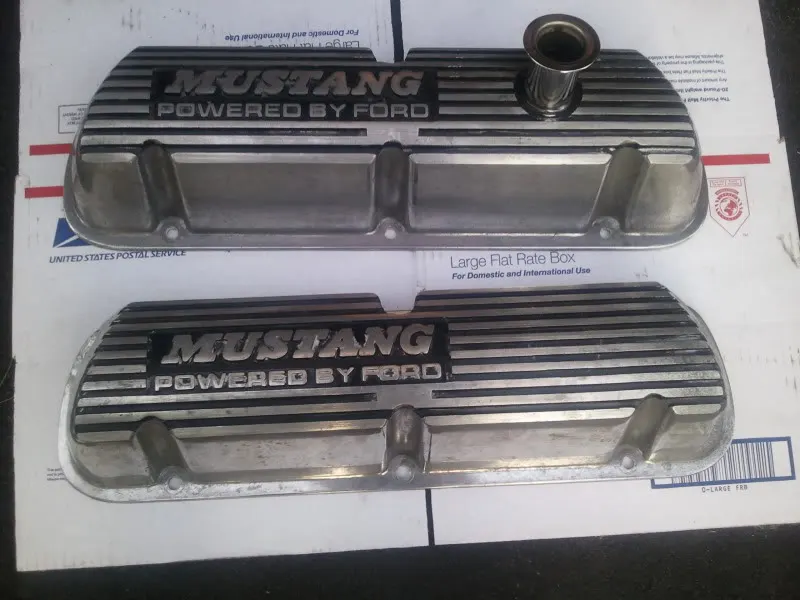

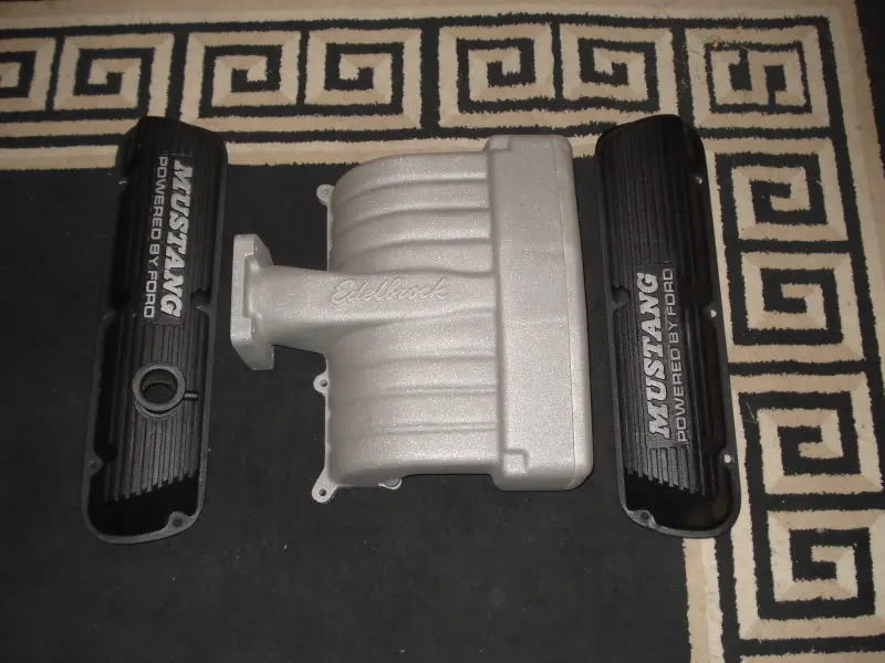

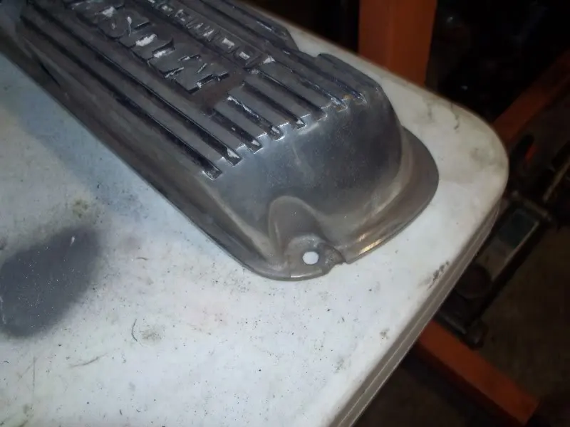

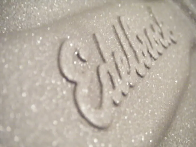

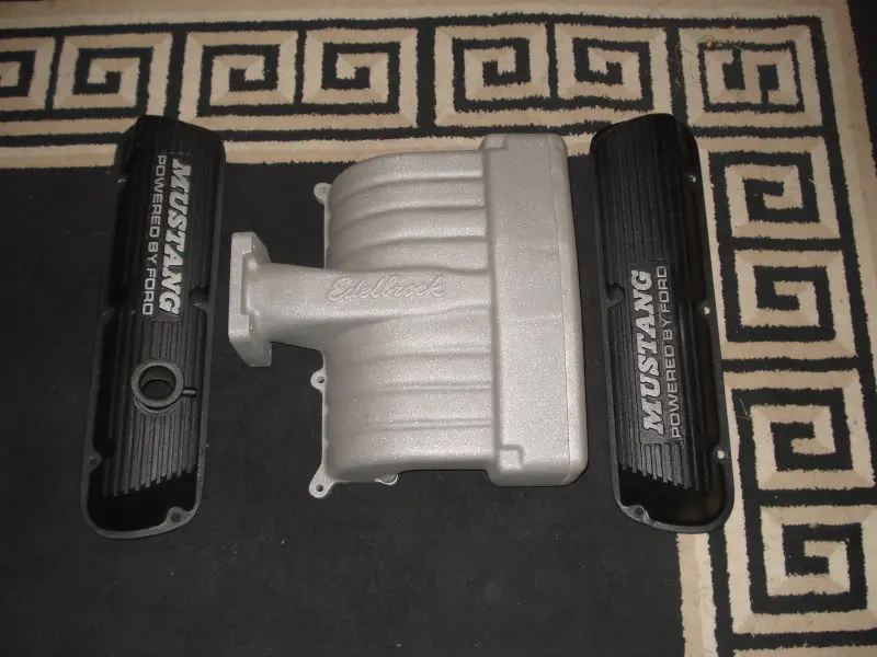

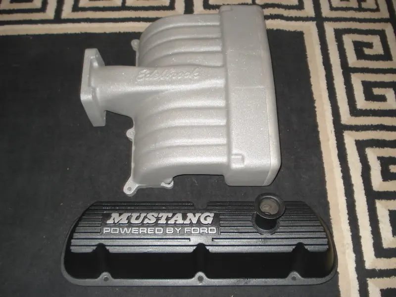

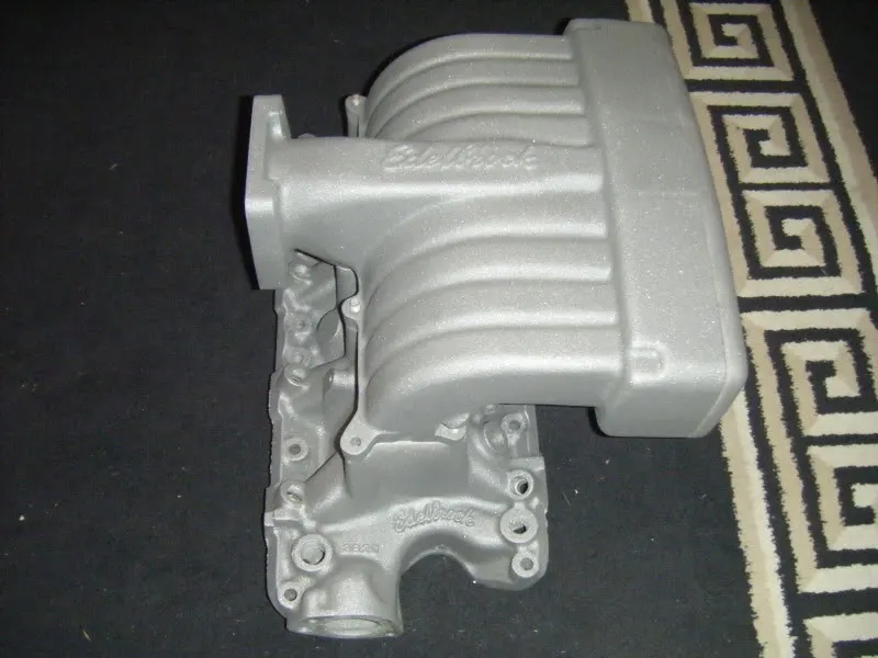

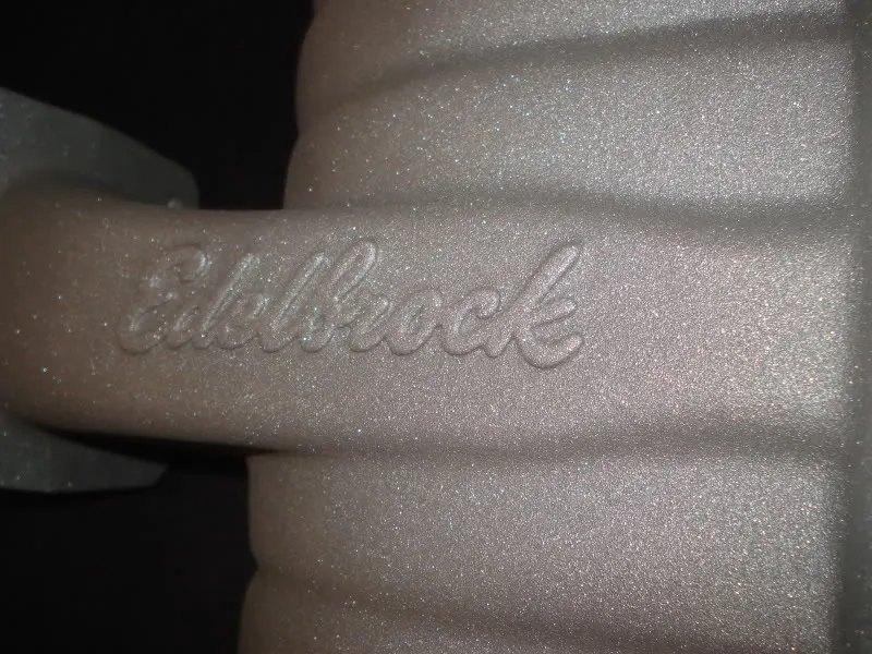

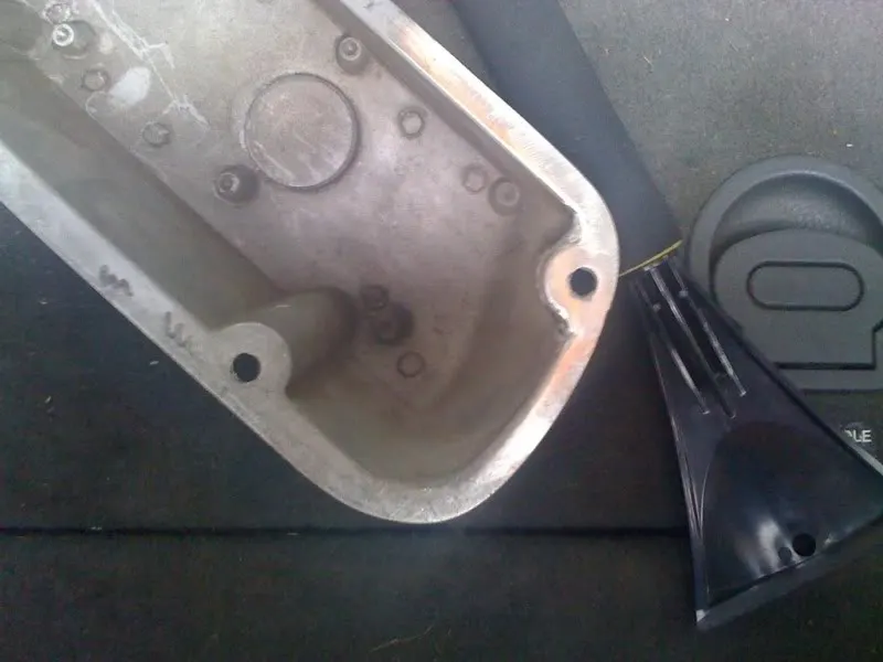

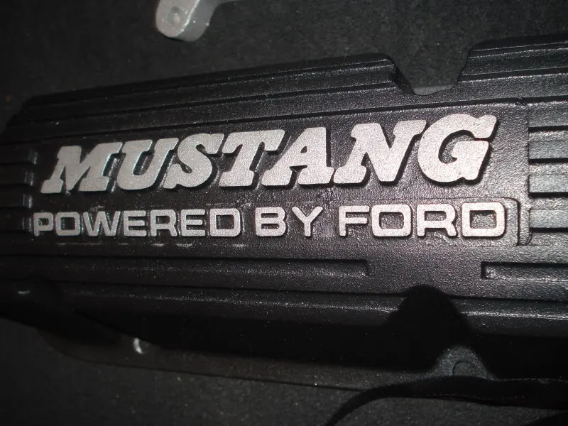

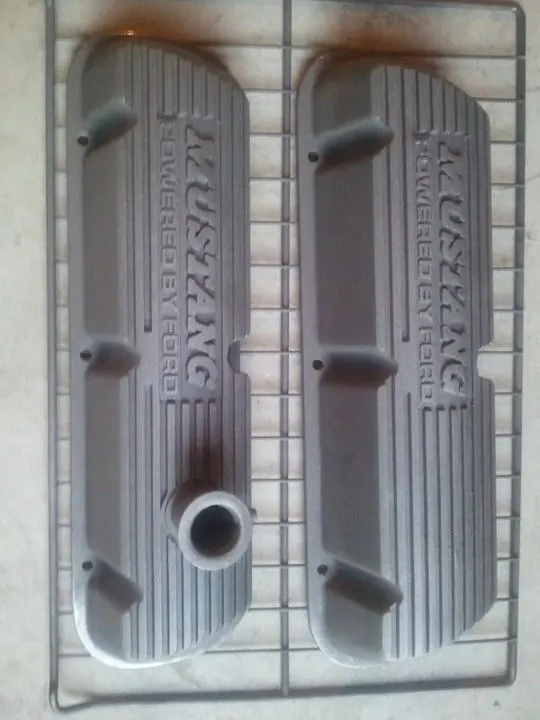

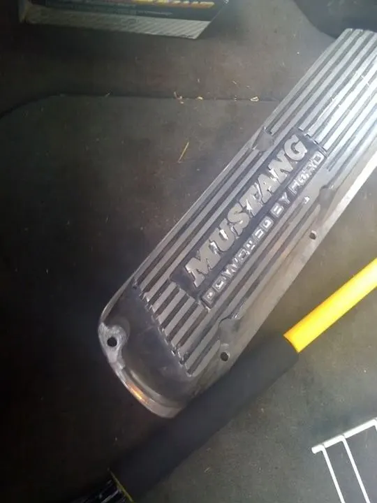

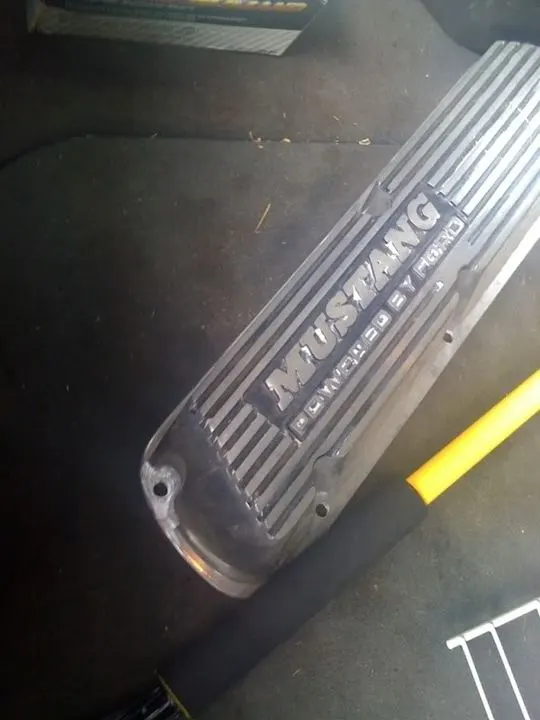

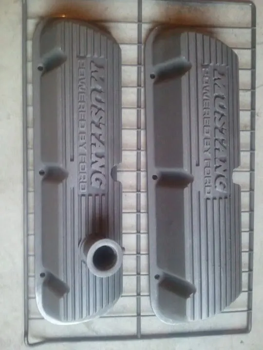

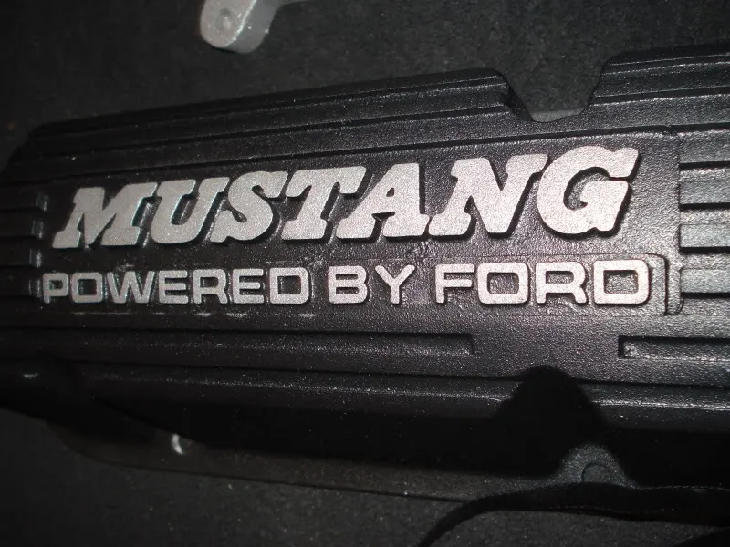

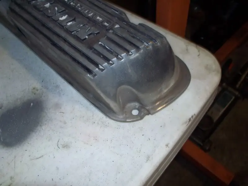

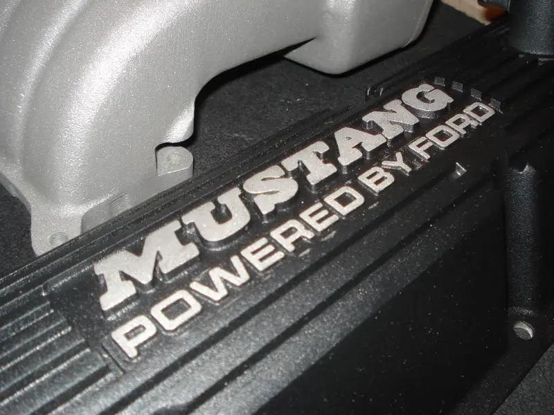

Some beat VC's someone picked up at a swap meet... Repaired and coated. Still need to touch up a few small spots. The lettering was done in dark silver textured sparkle to match the intake. The rest was done in carbide black textured to match the Vortec+acc brackets i have already coated for this car.
Before:
First color for the letters:
Wrinkle cleans up bad areas nicely:

Adam, there is tape that you can use that is oven safe. It's like a clear red and blue tape. We use it all the time and it has a high melting temp, so it's safe for powdercoating. You just mask off where you don't want the powder and bake it with the tape on. Much easier.
Eastwood Powder Coating High Temp Masking Tape Kit 6 Rolls Blue 10421
Polyurethane tape would be alot more work for what i did there... Id have to cut out each letter. I sprayed the first color then baked it. Then sprayed the whole thing in black powder and then used the tape to lift the powder off the letters then baked with the second color. This gives it a soft edge.
It would of took me a good 3 hours to cut each letter out in polyurethane tape...
