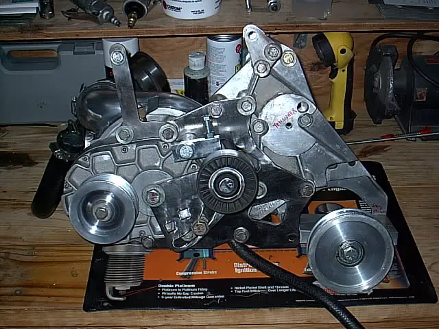

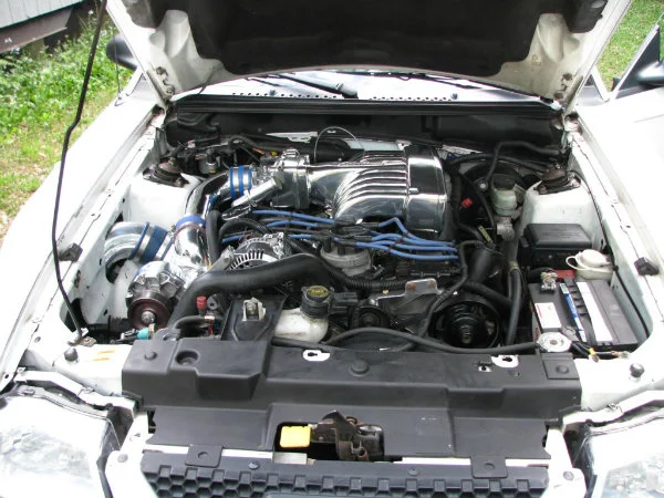

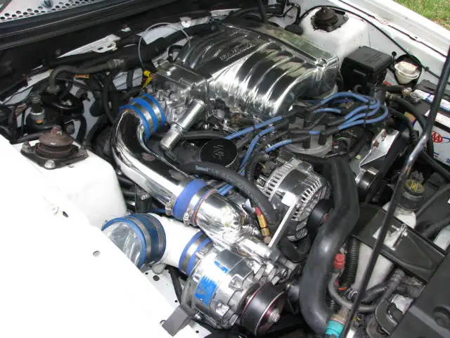

Here's a couple pics of the setup
Yep, 12 psi! Not a BBK cai, but the lower half of an ebay special cai. It doesn't take the 4" diameter of the powerpipe to realize maximum boost from a Vortech, mine did it with my homemade 3" setup. And it only cost me around 15-20 bucks.
Pretty genius if you someone needs a polished / chrome power pipe. UPR sells the plastic power pipe for $100. What size pulley is that? I want to say the 3.33 pulley on my car made 8-10 psi, then I upgraded to the 12psi pulley but it made more boost than I was expecting, like 14.5psi.
Now that I look at this picture, it does look the same as yours. I thought it was smaller looking.
The key to my car seeing 14.5psi was the belt tension kit I bought. It has a bolt pushing down on the pulley bracket. I could play AC/DC's Back in Black on that belt it was so tight.
Here is a picture of that. See the square block above the center black pulley? That's the tensioner kit.
I have the stock 3.33" pulley on mine. Were you running stock heads or aftermarket?
