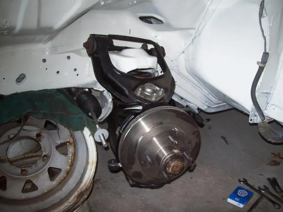

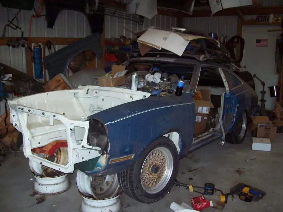

slow going but making headway.....
and a pic to see it with a couple wheels that are going on it

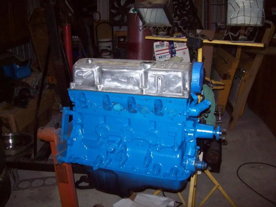

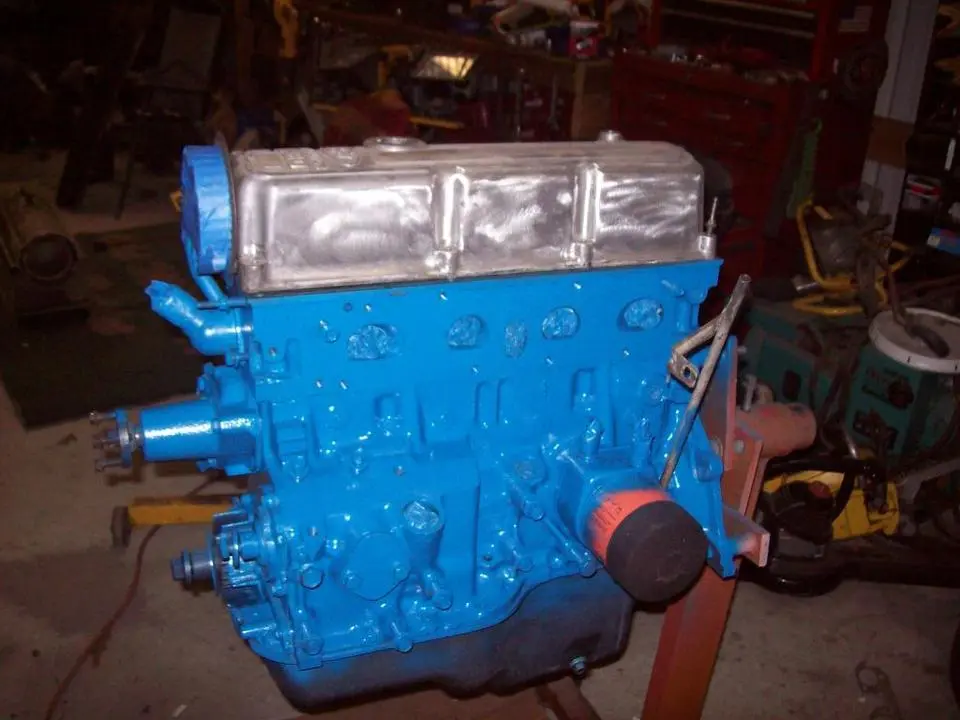

its a roller at the moment... the engine in this pic is a fresh 0 mile 2.3 turbo motor..i haven't swapped the pan and pickup yet. still cleaning them for paint.. will also relocate the dipstick when I swap the pans.....install is on hold until the new brake line kit comes in... backorder for 10 days ,, or so im told....engine and trans will both go in once the lines are ran... the blue is the same color the exterior stripes will be.
