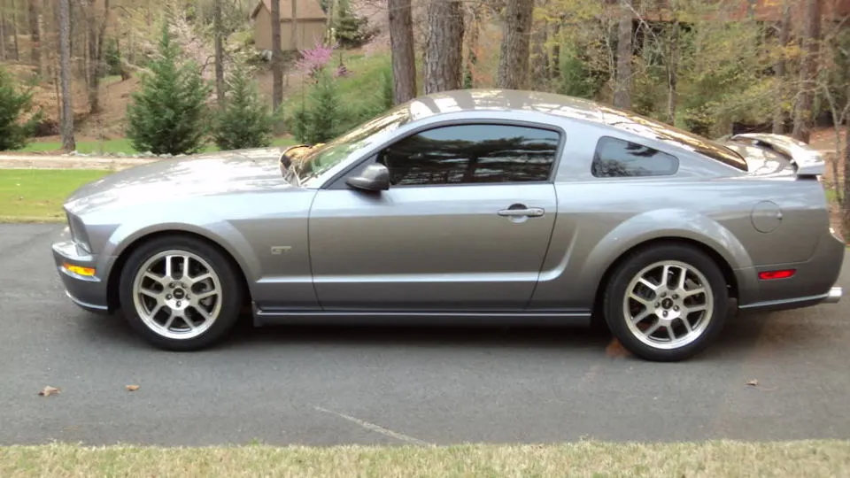

this is what the car has
C&L Street Intake
62mm BBK Throttle Body
FRPP Delete Plates
JBA LT Headers
JBA O/R H-pipe
JBA Axleback
Hurst Shifter
Detriot Trutrac with 4.10s
Steeda adj Upper Control Arm
steeda ultra lite springs
j&m camber plates set at 1 degree neg
j&m adj pan-hard bar
umi lca relocation brackets
koni str.t shocks/struts
gt500 wheels/tires
well put 5k +miles on those tires, never had an issue with them even at 140 on wet roads, side step the clutch and they had traction by 30 mph, im thinking if you have a mustang and these tires im the sizes i did and are haveing problems then its the setup on your car. abs and factory brakes are weak on the car just like the rest of the cars factory equiptment, drive train is a great base and solid interior is great styling is nice. anyways, but on the plus side i did finally find a way to get the car to do what i wanted it to..... i sold it and bought a vette... the traction control and abs are so much better do i need to say something about the handling... its a great fix for the mustang... on the plus side i made 4k on the car owned it 6 months and put 6k miles on it ;)
