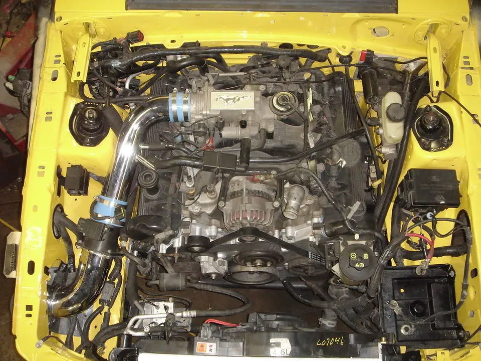

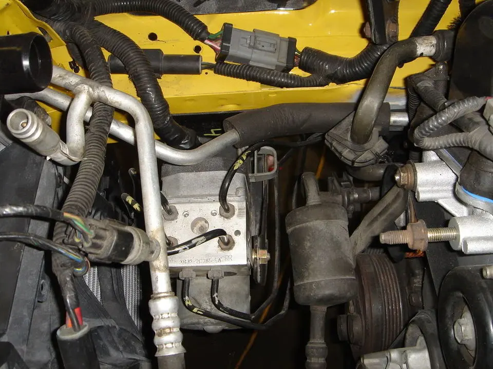

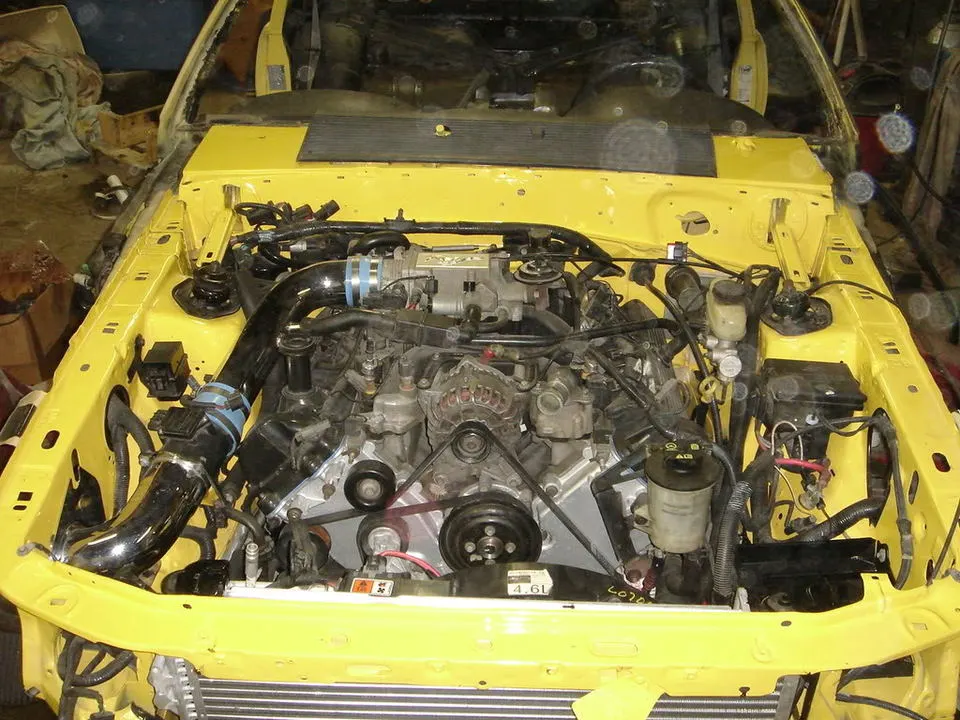

I put it on my 81 notch. I used the entire brake system from a 2001 GT. Hydroboost, brakelines, calipers, complete 2001 wire harness etc....Here's a pic.
