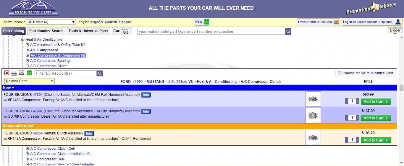

Just by chance I noticed my a.c. comp.clutch slowly turning a little while she idled in my garage.I priced them out and I was willing to fork over $100+ for a new one,no place in town has one.Can't get one till next week,so I removed it and wire brushed both parts and put another shim on so the gap was about 0.016-018.She's back together and no problems all day. How long will this last? Anyplace have new ones less than$100 bucks.

Order the clutch. Keep our compressor.
In reality, the only portion of the clutch kit that you need is the friction disk. I tossed the rest of my last kit in the trash can.
You will also need a good set of snap ring pliers.
First place I check when I am looking for generic parts. At the very least for a price comparison.
Yeah rocks got a new one cheap enough,I'll toss it on then rebuild the original factory compressor.
