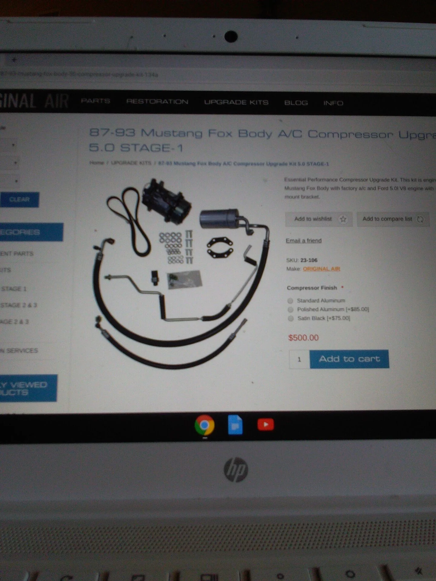

Is there a common chemical that I can clean out both condenser and evap. parts on my ac system. I want to go with a semi-complete kit and buy a 134 resto kit. It has everything but the mentioned parts. . Maybe start with Tolene or xylene. Then finish with the correct flush. I want to get it good with compressed air, but at $40 for a bottle I just want to buy one. I have a vacuum and gauges. Any ideas for the Potomus for a 134 resto. I will take some negativity if need be , but dont crush my dreams KIMG0335.webp . This kit is from Original Air WILL IT WORK

Thanks , that information says it all. My only question for now is will it work in regards to leaving the old finned aluminum stuff in. Being a Florida car there is no corrosion and I will take the front one out to clean it.....If I take my time and do it right WILL IT WORK / Would you consider doing this to your car.

If it's all in good shape, and hasn't been open to the elements to collect dirt, sure.
